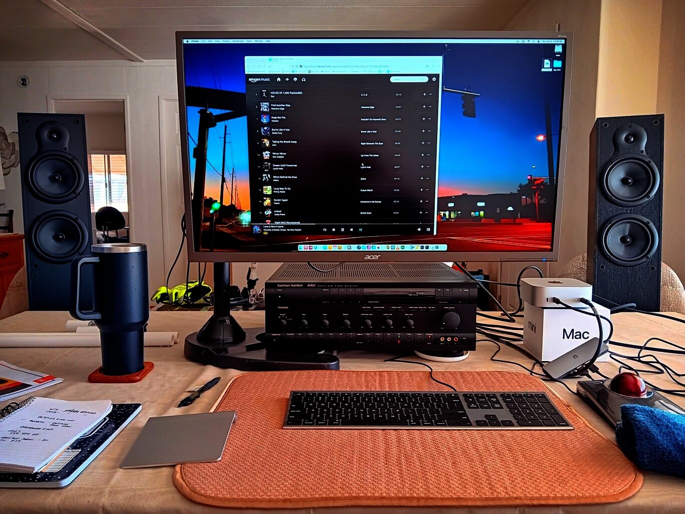

Well aware of Handbrake, Primo. I’m a commercial film producer so I’ve got nearly all the software tricks available, including an edit suite based around Davinci Resolve - pic enclosed.
But thanks anyway for the info - that will be useful to others who don’t know how to prepare a video for web publishing.
