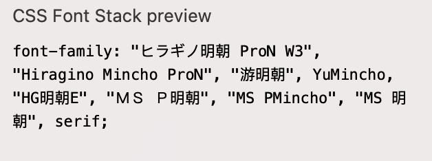

So for system fonts you can build a “font stack”, a mechanism to instruct the browser to search in the specified list for alternative fonts on the computer. For example for japanese we pre-built this font stack for the Hiragino Mincho ProN font (you can check in the Sparkle font panel, system fonts section):
