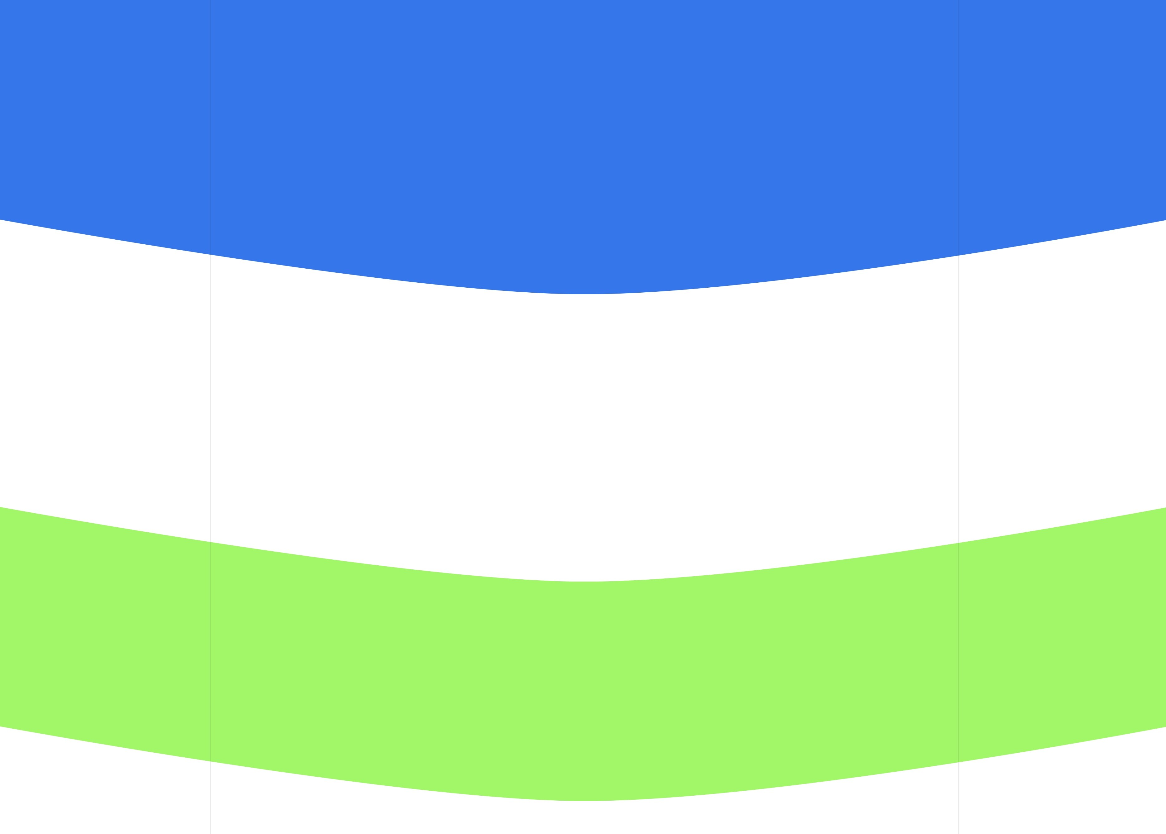

greetings, i’m having trouble getting this to work, any advice on how to approach making the sections look like this (all the way to the edge)? i’ve tried a few approaches which work a little bit, but are not consistent across different window widths

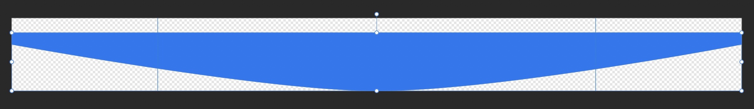

Start by creating a canvas of about 4000px wide by about 400px high. (4000 pixels should be wide enough for even the widest of screens.) . Next, add your curved shape to the canvas, ensuring that it stretches from edge to edge on the canvas. It should look something like this:
Next, export the graphic as an SVG (selection only - not the whole canvas). This will create a relatively small file of circa 700 bytes.

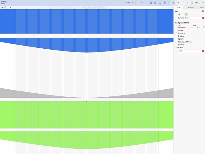

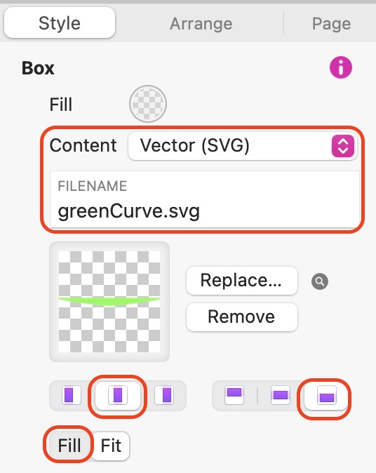

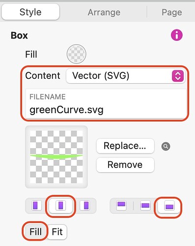

These shapes are then added as backgrounds to wide boxes or layout blocks and styled as shown in the screenshot below (the important settings are highlighted in red):
Now all you have to do is combine the shapes with normal wide boxes to create your areas of colour. Essentially, you create a wide box to the size needed to accommodate your page content, and then add your shape box immediately beneath it to create the final shape. Once positioned, you can group the boxes to make one unified shape that can be moved up or down the page.

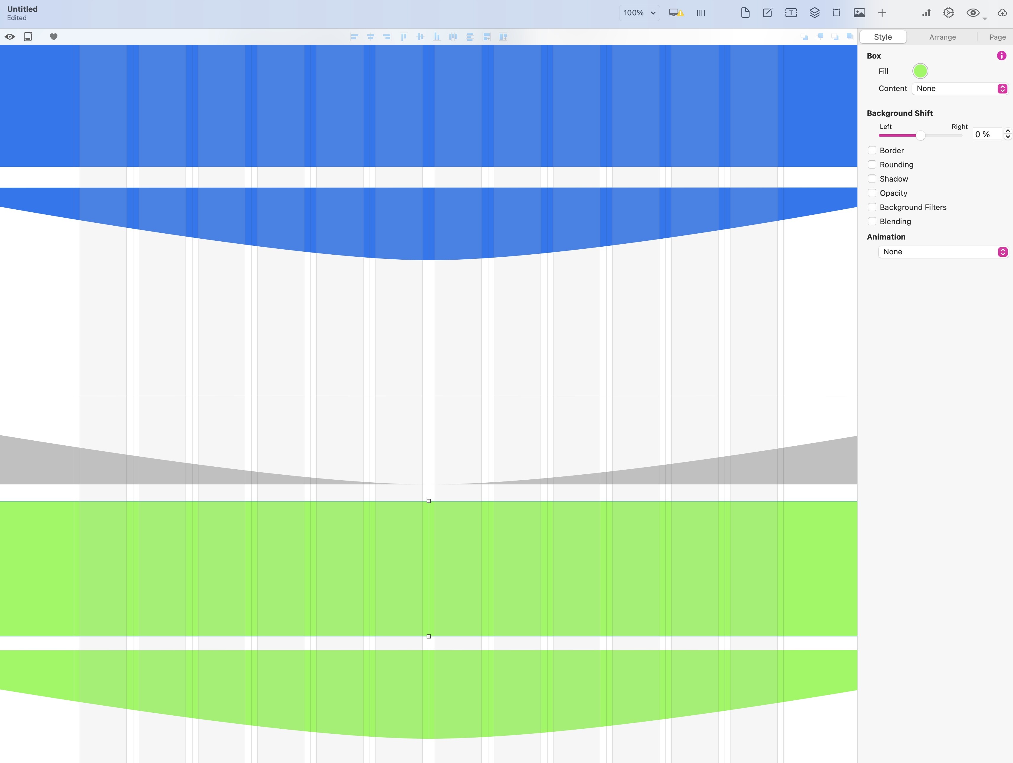

This is how my page looked with all the boxes set out before moving them into position and grouping (I left the grey background colour on the white shape so you can see it, but this would normally be transparent)

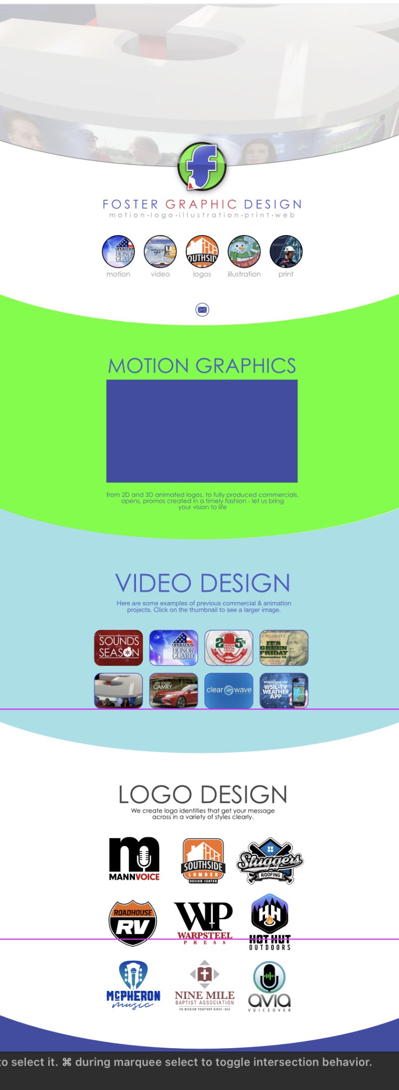

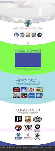

And here is the final page when viewed in a browser:

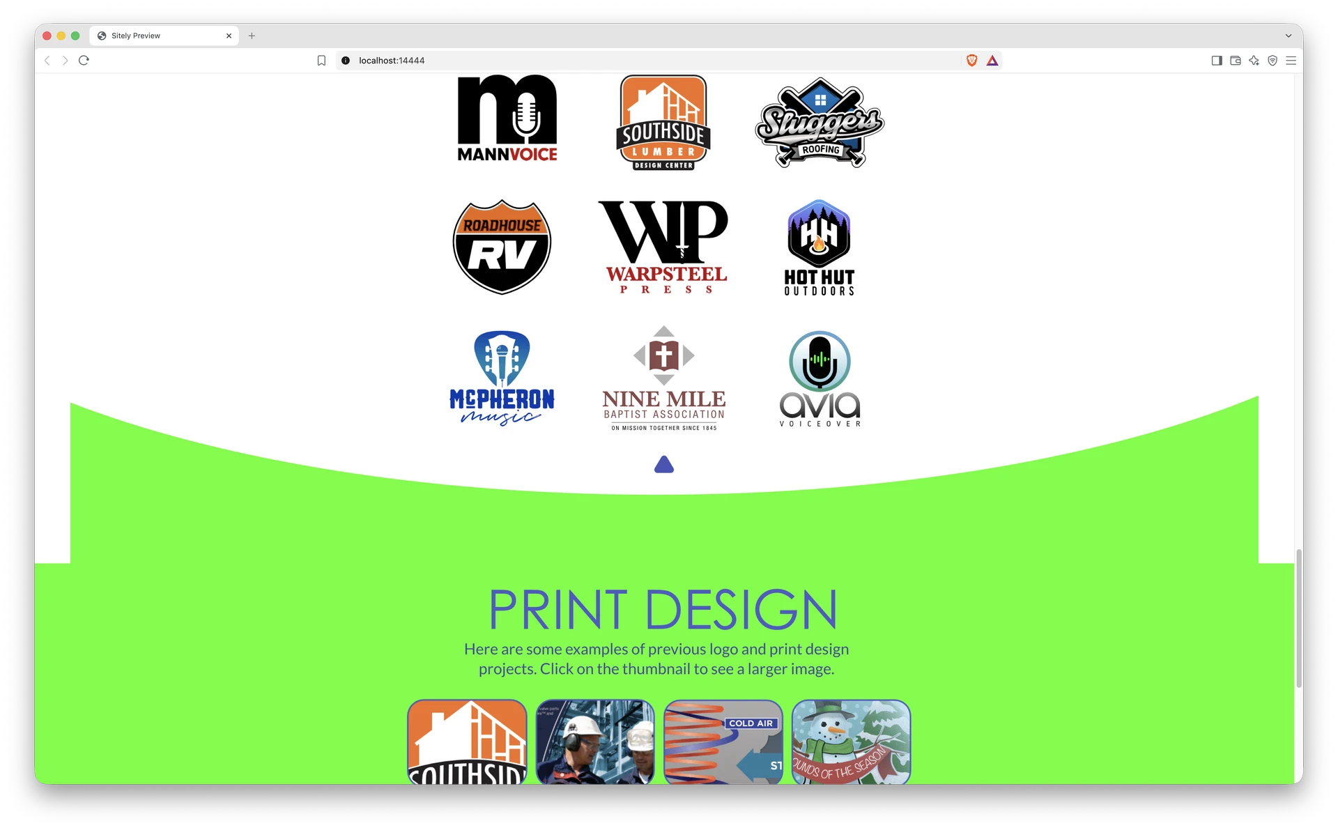

thanks! it works in chrome, and safari… but i get something else in brave. (see attached). I’ve also noticed, that background video will run in chrome and brave, but is a still in safari?
From what I can see from your screen grab, it looks like the green box immediately beneath the white shape needs extending to a wide box and possibly made taller - at the moment it’s looking like a normal width box.

thats the thing, the box that the image is in is set to full page width, and the svg is 4k wide, about 3x wider than the window there. AND it fits perfectly in chrome and safari. but not brave for some reason. Im wondering how best to deal with the various browser differences. Also, the video was specifically edited for this (with no audio). not sure why safari is being stubborn when the other browsers are not…is there a setting for that?
I know it is an obvious one, but did you also have your green image set to Stretch & Fill? This makes sure it stretches out to the browser’s width.
I agree. I’m assuming that the white shape is the SVG and the green piece that seems to be cut off at the edges is a box behind the shape - that would be the box that isn’t full width. I’m also assuming that the green area at the bottom of the screenshot IS a full width box. If I’ve got that wrong, maybe you can upload the actual image file so I can see what’s going wrong.
i see option for one, or the other. not both at the same time?
the box is full width, filled with the picture of the “curve”. it loads and looks fine in chrome, and safari. brave is the only one it does this. Not sure why. How best does one deal with the various browsers eccentricities?
