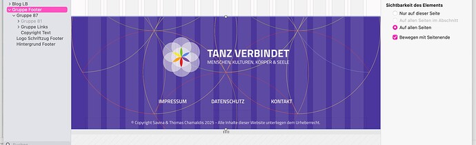

Hi, how can I make a copyright footer appear on all website pages without me doing it by hand on every page? Thanks!
Hi there,
that’s quite simple. Just activate the visibility on all pages and the stick to bottom (not sure how the wording is as I use a German interface). See the attached screenshot.
Good luck!
Thomas

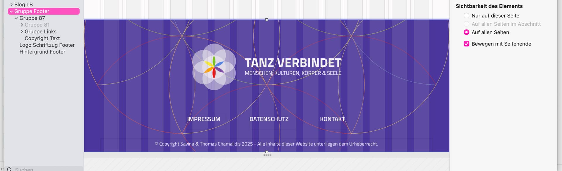

Hi @YaWb :blush:
As @ThomasC mentioned, there’s a built-in feature for that. Let me just add the steps:
1. Select your block/group
2. Click on the “Arrange” tab
3. Choose “Show on all pages”
You might just need to readjust the height of your pages afterwards.
