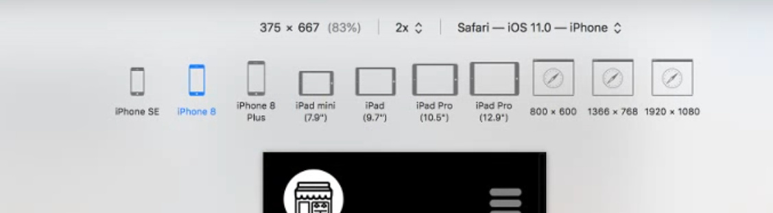

Duncan, how do you manage to make these options appear on Safari?
This is Safari but you have to implement it first because it isn’t visible by default.
Go to Safari preferences and click on the Advanced tab, and at the very bottom click on “Show develop menu in menu bar”. Once you have done that you’ll see the “Develop” tab across the top of the Safari browser.
From there you’ll see in the dropdown “Enter responsive design mode”.
Enjoy!
