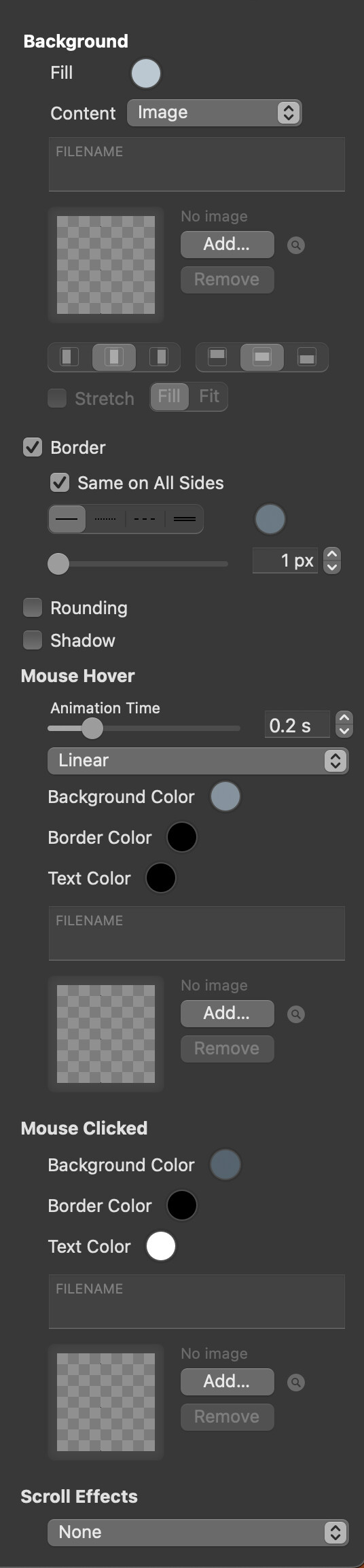

You could use a Button, and place the original image in the Button as a Background.
On choosing that setting on the button you will see further down that you can swap out the image on the hover state… Give that a try and see if it works for you in what you want to achieve…

I will try that. Thank you!

The button does do that.
