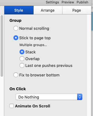

Very newbie to site creation, I’m trying to make a horizontal menu stay in place at top of page when I scroll down.
Any simple way to do this ?

Hello,
you can group the menu together with a box. And than you can fix it on the top of the side (in the menu on the right side)

This is possibly not about the grouping at all? I’d refer you to the devices documentation, let me know what is unclear or how I can help:
Click on the box/group/menu and under Style, you can tell it to stick to the top.
Thanks Gretchen!
Finally got around the problem by creating boxes with text for the menu titles and doing the group thing with stick to top option.
