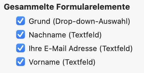

how can you determine the order of the form elements.
The “Collected form elements” shown in the app
turns out to be completely different than the confirmation email that will then be sent.
Can’t I determine how the order of formelements should be?
That also puzzles me.
Is there any way to control it?
What criteria does sparkle use to select the order?
The reason i ask is that i will send informations i have put in an invisible text field. In the e-mail i like to have it near the field it belongs to.

From what I understand, changing the order of the form fields under the layers (on the left side) can solve the problem. Click and drag them in the order you’d like to see.
Sorry Matt, but I’m afraid you’re wrong about that.
Did you test it by sending a mail?
The order you see on the right side is not what you get in a mail.
Mr. F.
Actually, matt was right.
Just tried this in Sparkle 4.0.5 and reordering elements in Layers also reorders the Form Elements Collected (not just in the app, also in the data received).
@Mr_Fozzie
The order of the elements you get in the mail is like the order of the elements in your layout.
From top left to bottom right.
Not the order in the right menu.

@Mr_Fozzie: have hou tried reordering the layers?
It’s only after reordering that I’m seeing a change on the right and in the results.
Multiple times. This does not help at all regarding the order of the fields in the mail.
Only moving in the layout changes this sequence.
But it doesn’t matter in the end, because the mail only goes to myself anyway.

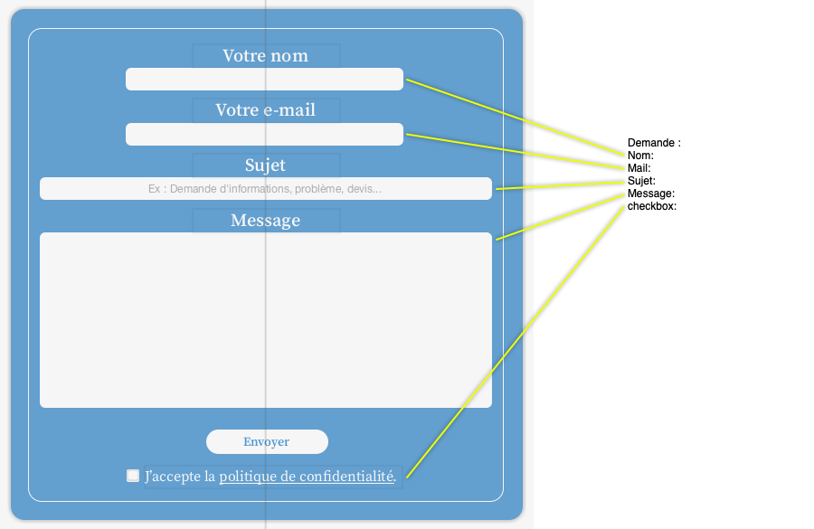

Did you find a solution then for that? In fact I have the same problem and the order is as the fields are created. Probably no solution to define the order, or do you have one?
Hello @geneprofi ![]()
The order of the elements should be based on the form fields in Sparkle. Is that not the case for you?
Allan, you gave me an excellent hint and looking precisely, I found out, that it was not clicked. Well I still have the problem, especially then, when you have more that one column in the form. See here: amari-spa.com but it is not so tragic actually.

Columns do make things a bit more complicated, indeed. It comes down to the exact pixel positioning. If two form fields are exactly at the same height, I’m not sure how Sparkle determines the order.
