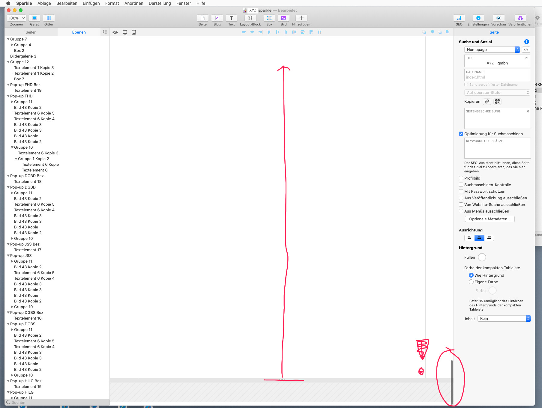

the heights of the individual pages of a website are very different in my case. The homepage is the shortest of them.
Only with this page I have the problem that the end cannot be pushed up. I can grab the bottom marker and extend it, but I can’t shorten it. I also activated all the elements on the page to see if there was anything invisible hiding there - nothing…
So in the preview the page is forever long and can be scrolled into the void. In the screenshot you can see the end and estimate the page length using the scroll bar. Maybe someone has an idea?

Have you checked the size of your popups?
Hi Allan :slight_smile:
the popups are only on the “projects” page, not on the hompage with the length problem.
According to the screenshot you shared, if it is indeed the homepage, it seems that your popups are also present on this page. Please check in the “Organize” tab (middle tab) that your popups are not set to be visible on “all pages”.
Allan, you are a hero! :innocent:
All the pop-ups were correctly set to “only on this page”, but they were also still present on the homepage.
I had duplicated the “Projects” page in order to be able to make a new entry page / homepage out of it afterwards and deleted all contents. Unfortunately, I didn’t notice the pop-ups.
Only now did I understand how the display of the pages and layers on the left side in the sparkle interface works… :see_no_evil:
Many, many thanks - that was very informative!

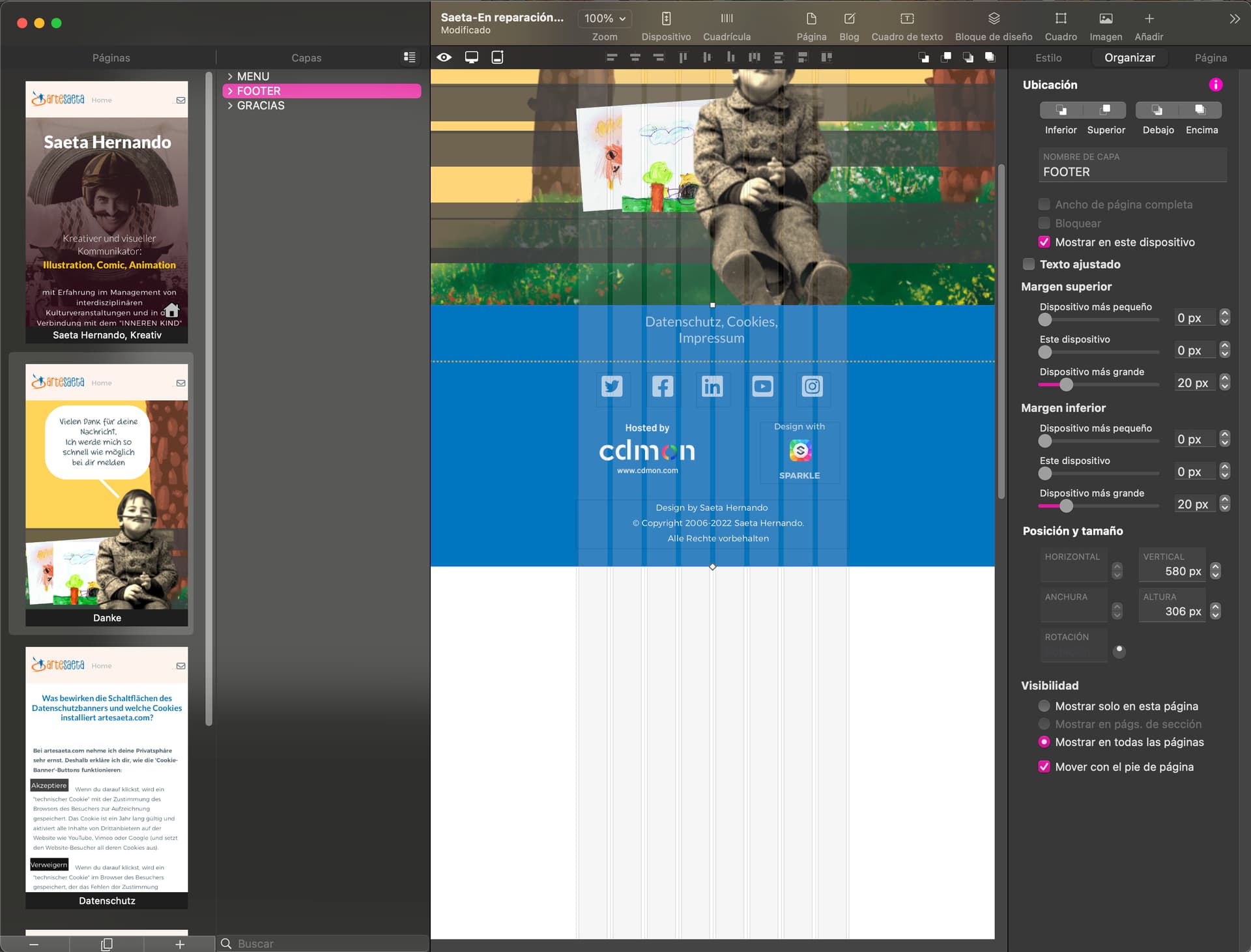

I’m experiencing the same problem as @zapine but only in the mobile version and I don’t have floating windows.
It’s a very small site, just to let you know that I’m in the process of renovating the website.
In version 4.5 the footer stayed in place with no more space downwards, but when I updated to version 5.05 it appears like this.
It happens in the three pages it has: Home, Thank you and Privacy.
There are no floating windows, although in a previous version I had them, I deleted them all. Still, that floating window for the menu never reached that much space.
I decided to redo the site from scratch with Sparkle 5 to make a completely clean version. I mention this in case it was a bug produced by the version change and it could affect other people.
When I try to drag the end of the page to match the end of the Footer block, it jumps up over the previous block, but the bottom white space is not trimmed.
Double-clicking on the three dots in the bottom bar returns the Footer to its place, always keeping the same white space below it.

I’ve checked the preview and the active post on the website and it looks correct, with no white space below the Footer, so I imagine it may be some Bug in the builder generated by the version change.
