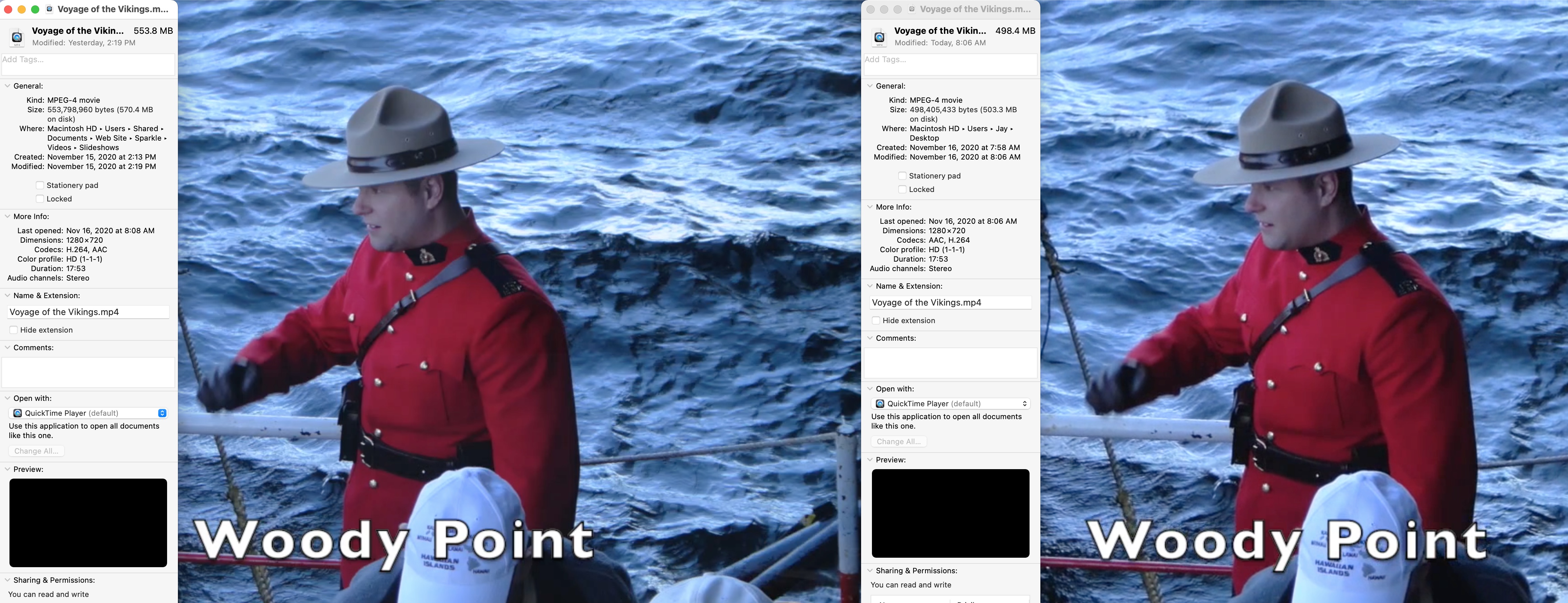

I used HandBrake with the settings shown in your post. I made a screenshot of the two side by side (see attached). Note that the original (shared from iMovie) is 570 MB and the one from HandBrake is 503 MB so not a lot of difference, but the image quality is very good.

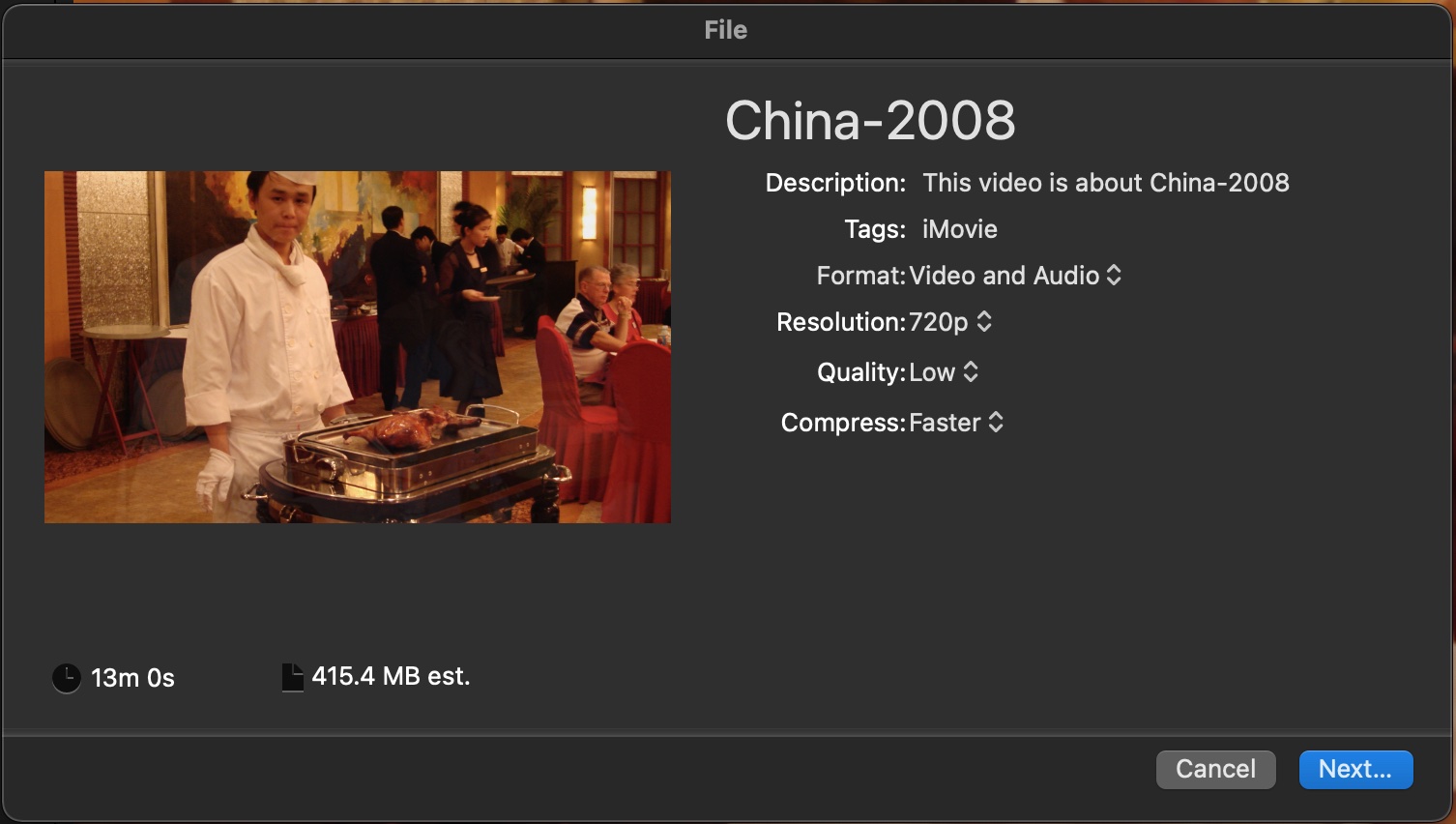

It would be interesting to see what export settings you used in iMovie. Very often, iMovie can export a good high quality video that is of a reasonable size without the resulting file being too large. As @thetravelhikelife points out, iMovie is probably the best option for maintaining the quality you need and certainly, any further optimisation in something like Handbrake should aim to preserve the resolution you used when exporting from iMovie.

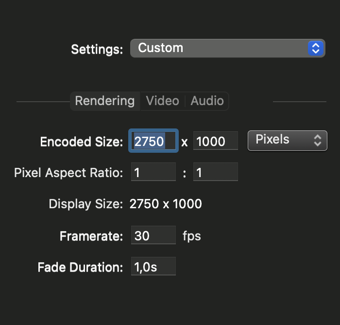

Here are my setting when exporting the original file from any of my video applications (this one was a custom display size rather than a built-in standard size).
The advantage of putting it through handbrake, for me at least, is to ensure that the video is web optimised in terms of its streaming capability. Some video files when output from the originating application do not add this option, which often means videos have to be downloaded in full before they start playing.
I just use the basic, lowest resolution settings in iMovie. It still gives reasonable resolution when viewing full screen…
