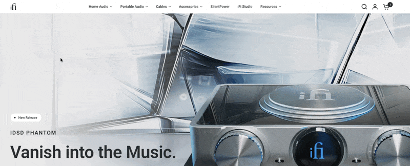

Could you give us a real use example of the mega menu you’re wanting to achieve?
I’ll give you an example below of what I believe is what you’re asking for
CleanShot 2026-02-10 at 14.33.11
If its this, then its pretty simple and you dont need the “CAD mindset”, it is exactly as easy as you think of it logically. You’ll set up your menu as the element “Button”. Then you will create, design and position your “Pop-Up” element wherever you want it to appear. Then, you set that “On Hover” of the “Button” element to open the “Pop-Up” you have designed. Thats the mechanical logic of it, the design part or how it looks is up to you.
Would you have a real use example so we can see if thats what you want? Then I can replicate it into a file so you can see how it is :slight_smile:
I like this navigation very much… can I please have a sample-document, how it is made?
