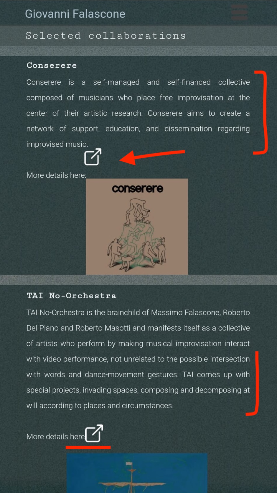

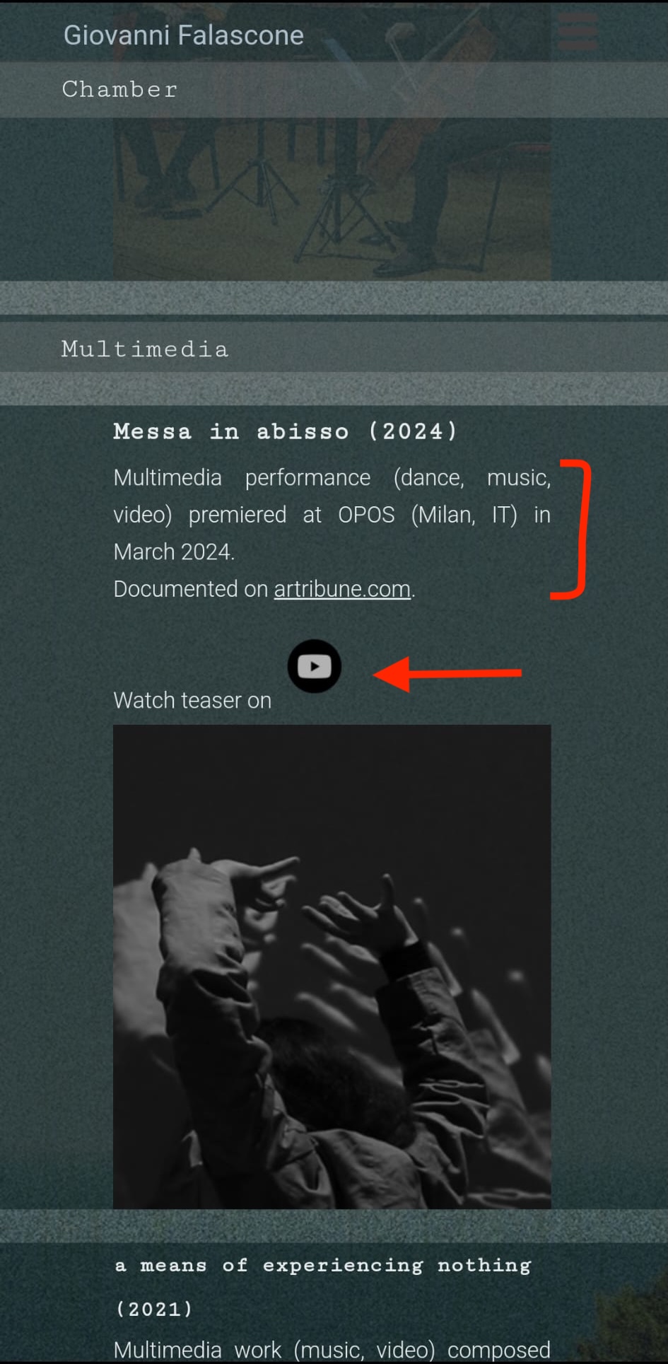

However, I now tested my website also on another mobile (Android - default browser) with a larger screen, and I noticed that the text was cropped. It looks like the text block keeps the same fixed size, but the font automatically scales up/hits the screen border beforehand, causing it to start a new line, extend beyond the visible area and get cut off. I have tried unlinking text formatting among devices and creating a custom text style specifically for mobile, but it didn’t change the problem.

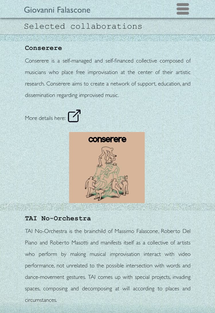

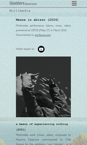

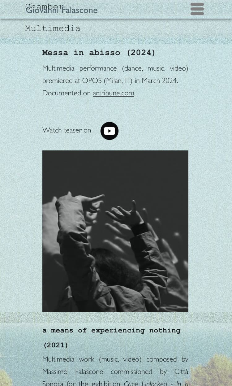

Actually on the iPhone I see everything just like on my computer (Macbook Pro M1). It’s the Android that has different margins/text size.

I attach here two examples of correct layout (iPhone) and the Android one.
