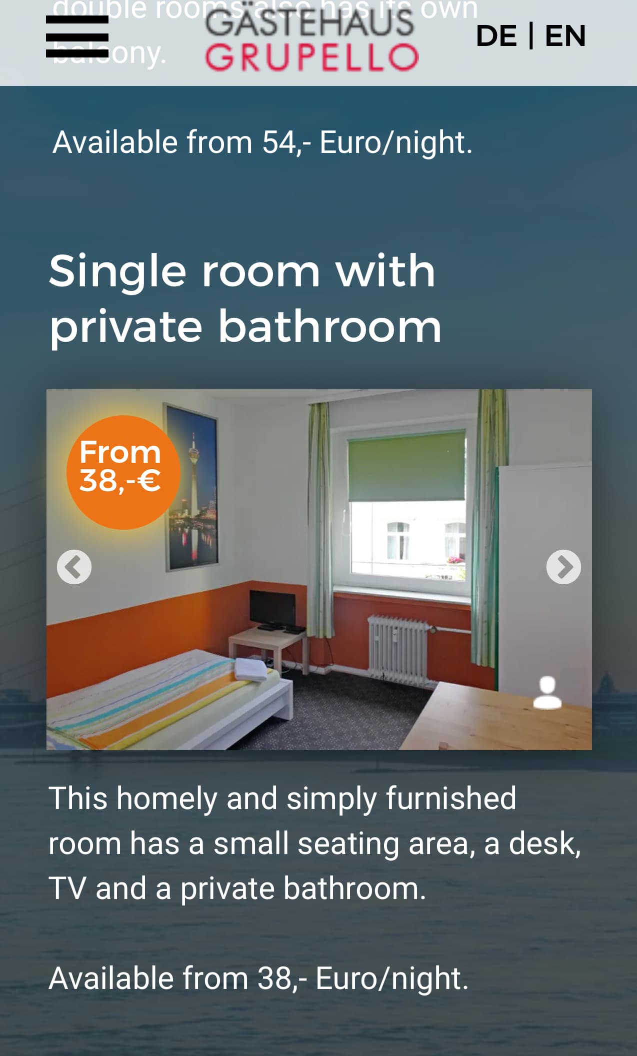

Hi ! Love the site! Love the low prices, too!
One item in the English site is the word “homely” you used. You meant “homey” or “homelike”. However, “homely” means ugly. See screenshot I’ve attached.
Otherwise, very very nice! I do agree with someone about using fewer animations.
- Dave
Thank you so much! I i used deepl for translation.
And yes, it is very cheap and the people who run the guesthoose are very nice.
Maybe use cosy instead?

Hello Thomas, thank you very much. What do you mean by “cosy”? I know it’s too much text, but there’s nothing I can do. The layout was quite different anyway. But you know that for sure, it just evolves. xx Steffi
“cosy” > “gemütlich”
Hi saber1, I understand the translation but not the context. I am supposed to “maybe use cosy” does not make sense to me.
This cosy and simply furnished (or maybe minimalst furnished) room…
is what I was referring to.
Aaaah, now I get it. I’ll ask the client. THX!
