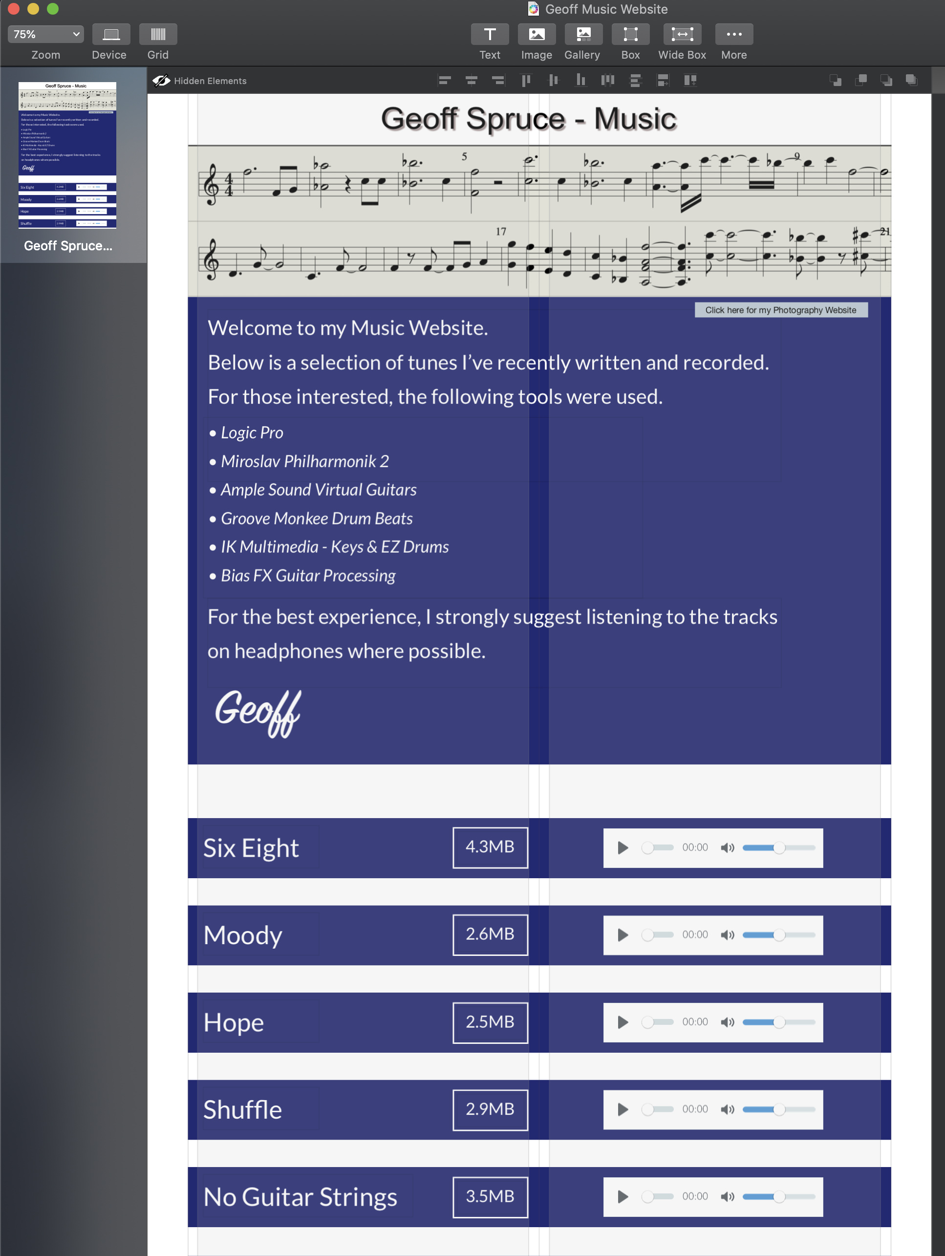

just what I did. https://www.geoffspruce.co.uk/music
It was so easy to create, thanks to Sparkle.

Regarding the Music site, I didn’t do any alterations for Mobile within Devices, as I found it worked ok. The only thing I did was group each “song block” to make it easier to add new ones.
Attached is a screenshot.
I’ve also emailed you my Sparkle file to your Frogmusic email address off your website, so you can look at it. Hope it helps
