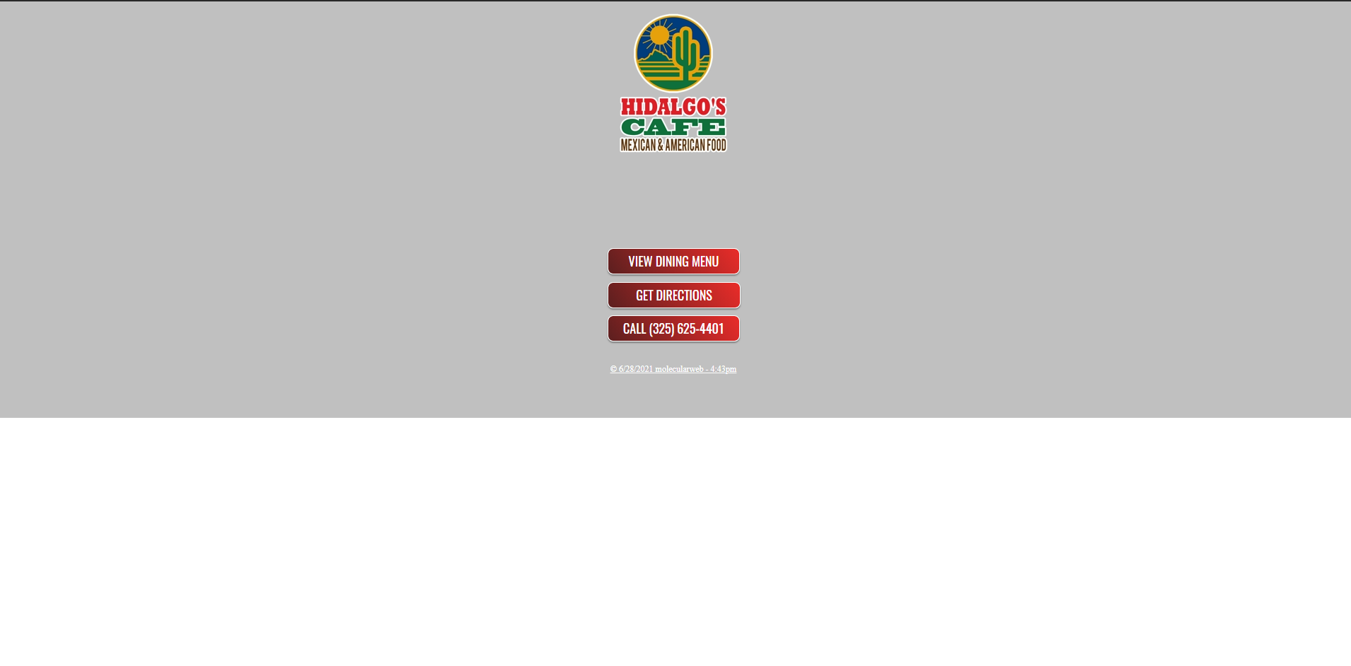

I’m using an image as a background (full width), it shows during design, but it doesn’t show on browser (Firefox, Edge, or iphone) after publishing. I’m using Sparkle 3.1 (8483) in an imac with Big Sur 11.4. Very much appreciated if you have any ideas as to why this may be happening. See creenshot below. See site at http://hidalgoscafe.us

Here’s whats in my screen. Just the box with the fill, without the image.

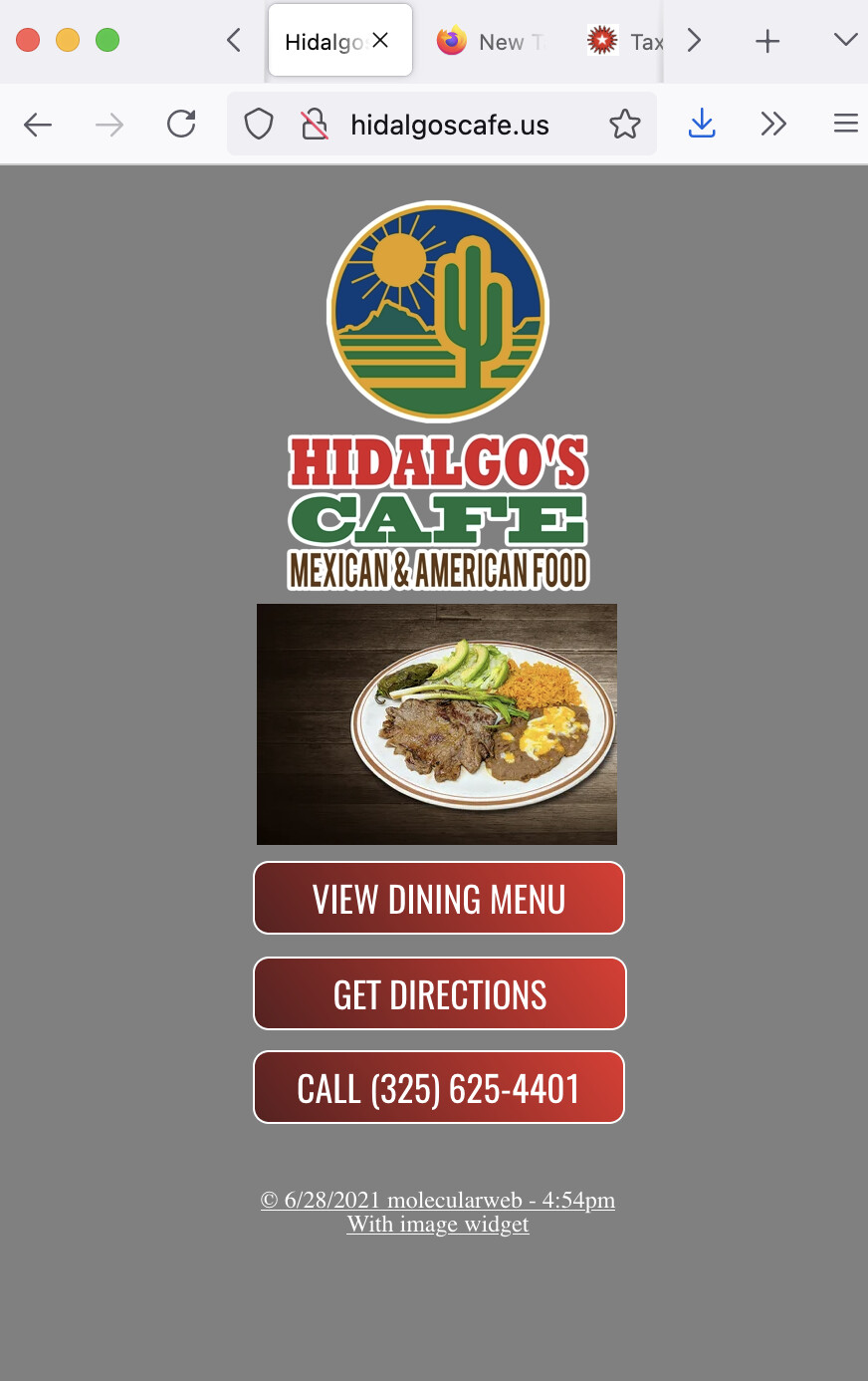

Primo, I inserted the image with the image widget, and it shows where placed. see screenshot…next step is to make it bigger and place it on the back to work as a background

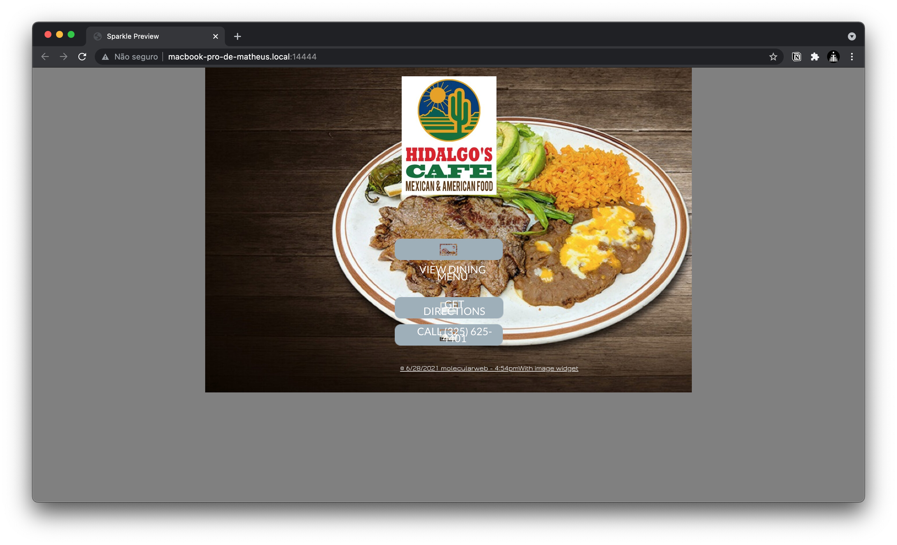

Okay so I’ve used everything you have built on, here’s everything working fine.

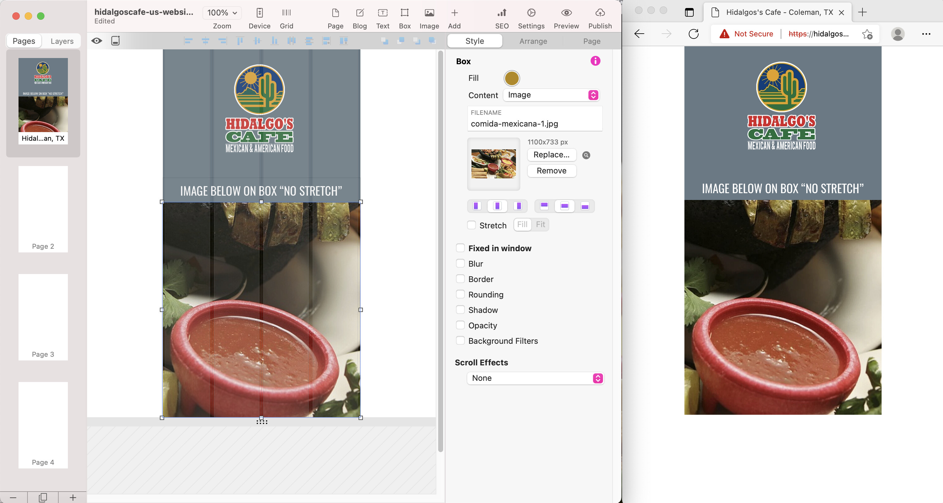

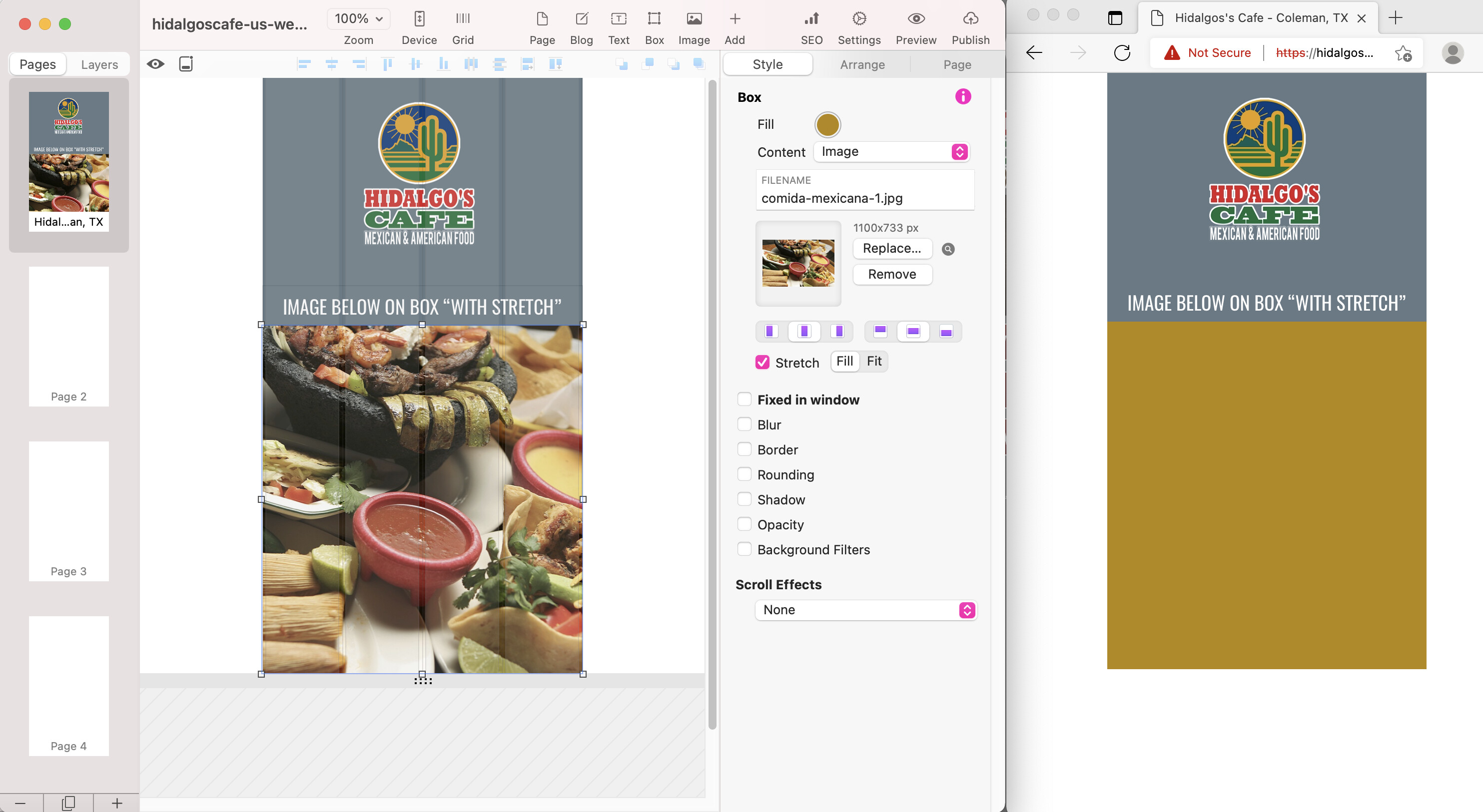

This is built from scratch. May be there is something wrong with the “STRETCH” option because when I uncheck it…the published site shows image OK. See screenshot showing spark and published site, side by side.
@chicho, There is a Sparkle V3.1.1 (8500) out. Maybe update and see if this still goes on…
