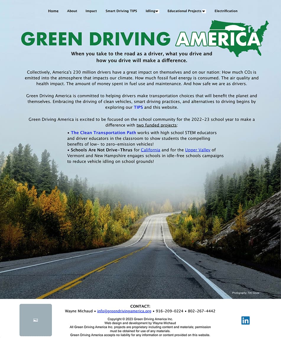

The result I hope to see for my homepage when published (this was built in Muse):
http://greendrivingamerica.org
This page layout is 1060 width for all but the background image which is 1920. In Sparkle Device Layouts, when I chose Ultra-wide PCs - 1920 pixels, choosing Custom Layout, all elements along with the background image stretches out/enlarges - see attached (in interest of file size, reduced to 36dpi).

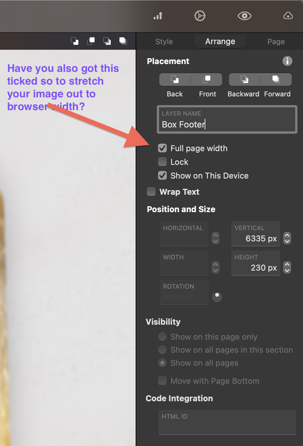

It looks like you want your image to stretch out to the browser’s width…
Click on your image and then got to your right-hand panel and click on Arrange.

FlaminFig- this sounds like the answer to the background image but nothing else being full page width! So I would think I’d chose the default 1200 for the page layout.

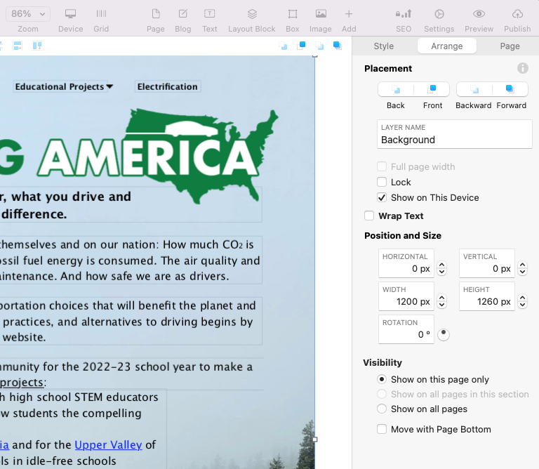

Have you got it selected as an Image?
Right click on the image (if it is) and Convert To Box. This will allow you to then select Full Page Width.
