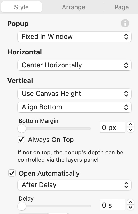

This isn’t an option I’ve used that often, but I think if I wanted an element to stick to page bottom, I would create a fixed-in-window pop-up with the following settings:
This will work on all devices and ensures that the bottom element always sits at the bottom of the browser window. The only thing that you must ensure is that there is sufficient blank space at the bottom of the page to allow for the pop-up. If you don’t allow this additional space, the popup will obscure any content at the bottom of the page. I find this to be a cleaner solution that having things stick to page bottom.

I don’t recall a stick to browser bottom option - I know there was, and still is, a move with page bottom option, but that is something different. As I said a better and more consistent option is to use a fixed in window popup aligned to the bottom of the window. That keeps it visible regardless of the browser window size.
