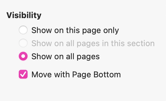

If you’ve grouped all the footer items, or wrapped them in a layout block, just go over to the Arrange inspector and set the options shown below. This will place the footer on every page and will ensure that it sticks to the page bottom.

Gary, I think I wasn’t clear enough. Try this…
Go to a page you want to add things to. Add them. They will likely be on top of the footer when you add them. On that same page, make the footer show only on that page from the arrange menu. Then move the footer to the top of the layers panel so that it is on top of everything else. Then select show on all pages from the arrange menu again. Your footer will now be on top of all pages.
With Sparkle as it is at the moment, you will have to do that each time to the page you are working on. Once you have switched back on the ‘show on all pages’ button, it will flow through the document. I hope that helps for now.
