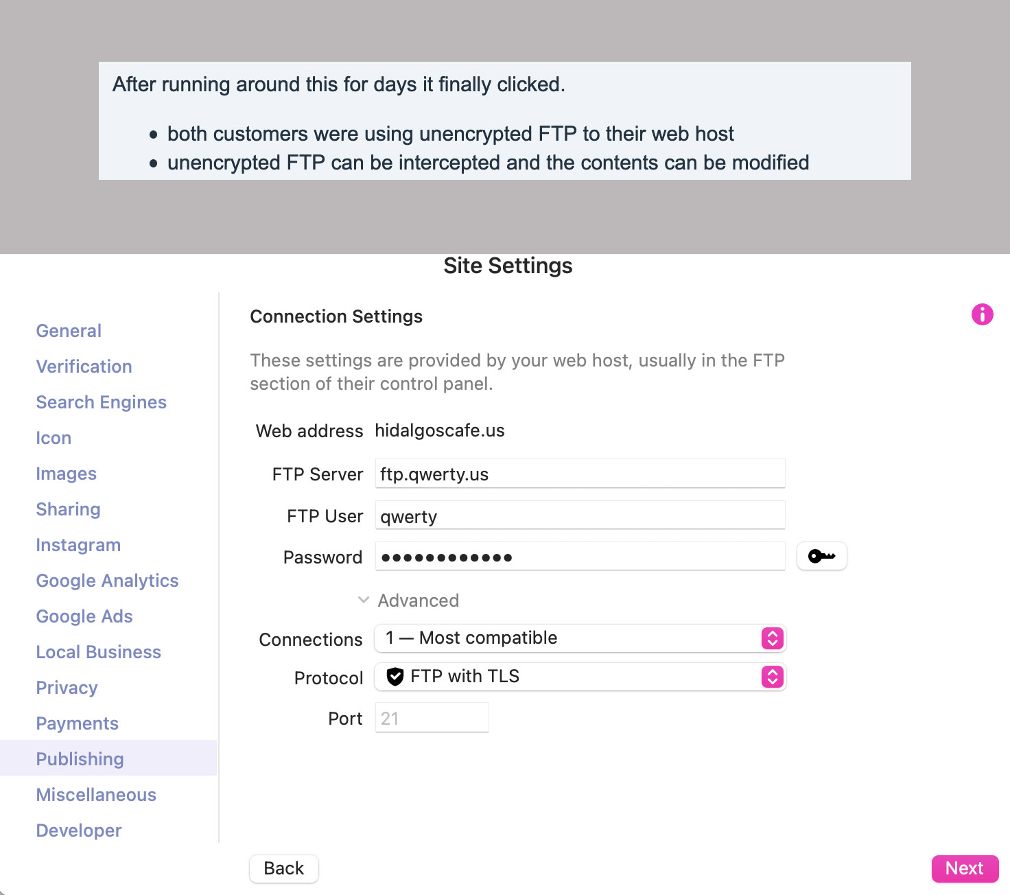

Sparkle can use FTP in encrypted and unencrypted forms, so it depends how you set it up. If you don’t remember you can go to the site settings, publishing section, click on the publish location, click “Edit”, then when you get to the screen with the FTP protocol you can check what protocol was used.
Sparkle picks the highest security protocol available, so it depends on what your web host supports. Sometimes it’s SFTP (best), often it’s FTP with TLS (also encrypted), sometimes plain unencrypted FTP. If it turns out you are using unencrypted FTP, turning off Norton 360 will be necessary to publish the site properly.

Yes, after reading Duncan’s “Cautionary tale about antivirus software” specifically the section about posting site with “Unencrypted FTP”. My problem was solved by switching to “FTP with TLS”.

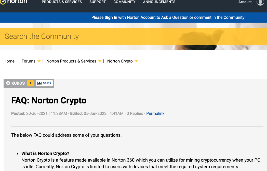

Another reason to never ever use Norton 360:
I found this too late after reoccurring publishing blocks, and after buying Norton, (and because of some concurrent scam attacks), and so i installed a mac cleaner and uninstaller, on 7 day trial, and still Sitely is blocked from publishing. It published for 2 days and cannot reconnect having tried over a dozen times with failures. Still investigating for a publishing solution, maybe another SFTP app? Which one? Another host-provider? Insights are welcomed.
