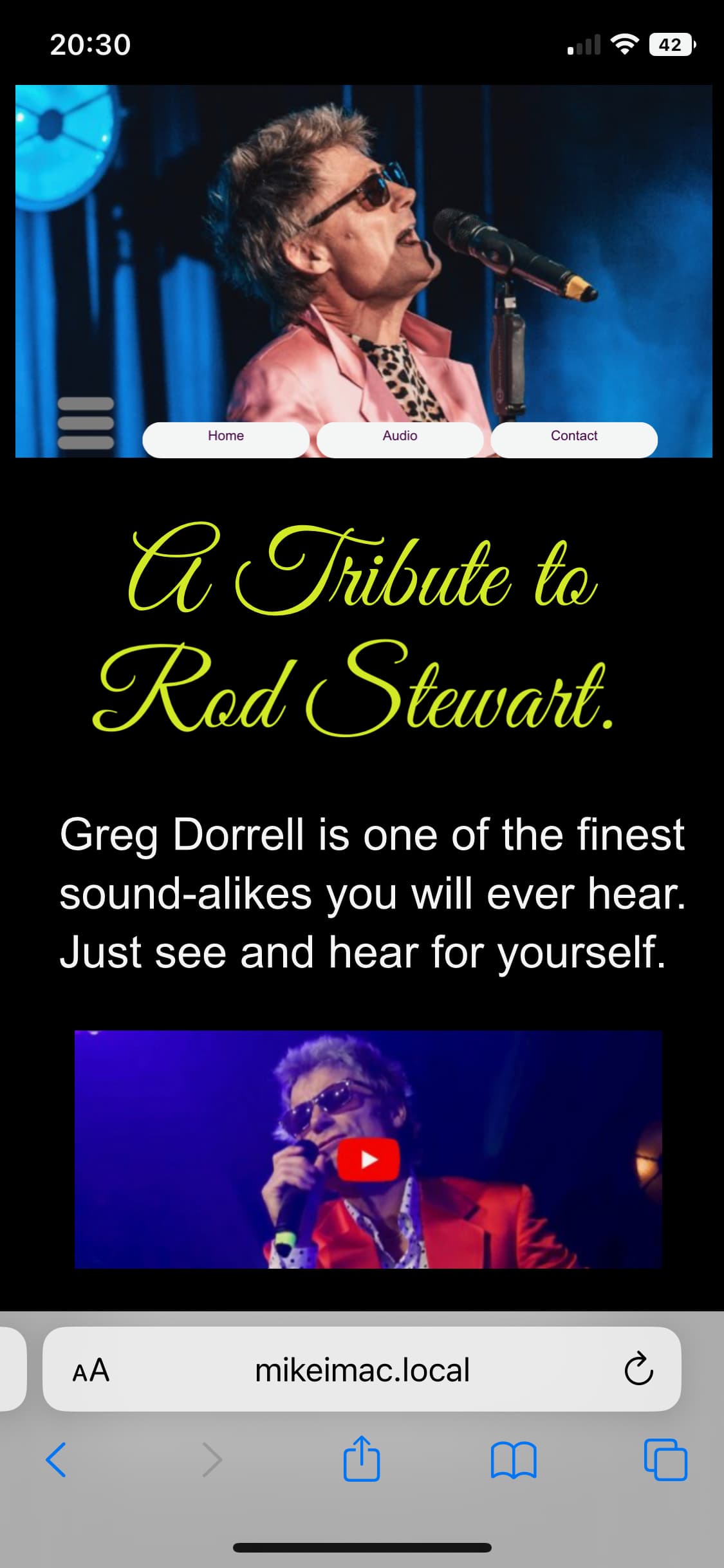

Mr. Fozzie,
Thank you for your continued patience and interest.
The text size of the menu is too small as you can see in the attached screenshot from my iPhone Xs. I would expect the Font controls in the Inspector would change the size. When I use the bar to increase the size, the menu just flashes on and off.
Hello.
OK I see where you are going.
This could be a space problem with the horizontal menu. The buttons may be too small for a larger font.
For the smartphone I would go for a vertical menu and make the buttons larger. And then increase the font size.
But then you have to “play hide and seek” with the menus! Hide the horizontal on the smartphone layout and vice versa.
Mr. F.

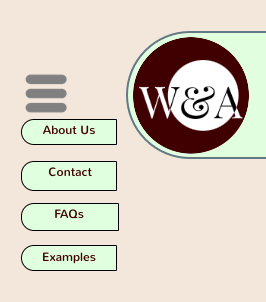

I have a similar issue. I’ve set Sparkle to use the Hamburger menu on smaller screens and horizontal buttons on the larger screens. When I first started, the non-hamburger version used a serif font, but that has been changed successfully to a sans-serif font. However the hamburger menu (four items) now shows three of the menu items with the original serif font and the last menu item with the sans-serif font. Selecting the page name in the Style properties on the right shows that all 4 are set to a sans-serif font, but font and size changes are only applied to the fourth menu item. It appears to be cached somewhere? This behaviour is shown both when editing and when the page is published.
OK, I think I have found where the issue lies, but not what is causing it. Looking at the HTML of one of the pages I could see the following code:
<ul class="menu-dropdown-1 v12 ps36 s40 m4" id="m2">
<li class="v10 ps35 s41 mit3">
<a href="./" class="ml2"><div class="menu-content mcv3"><div class="v10 ps35 s42 c31"><div class="v10 ps37 s43 c32"><p class="p6 f11">About Us</p></div></div></div></a>
</li>
<li class="v10 ps38 s41 mit3">
<a href="#" class="ml2"><div class="menu-content mcv3"><div class="v10 ps35 s42 c33"><div class="v10 ps37 s43 c32"><p class="p6 f11">Contact</p></div></div></div></a>
</li>
<a href="faqs.html" class="ml2"><div class="menu-content mcv3"><div class="v10 ps35 s42 c34"><div class="v10 ps37 s43 c32"><p class="p6 f11">FAQs</p></div></div></div></a>
</li>
<li class="v10 ps38 s44 mit3">
<a href="examples.html" class="ml2"><div class="menu-content mcv3"><div class="v10 ps35 s45 c35"><div class="v10 ps39 s46 c36"><p class="p6 f12">Examples</p></div></div></div></a>
I edited this so that the s, c, p and f values for the classes seemed to make more sense for their position in the menu, and it has changed the behaviour for the one page that I edited. It is still wrong in Sparkle but OK on a live browser page. I’ve attached before and after screenshots. Hopefully this will help to find the root cause of the issue.
