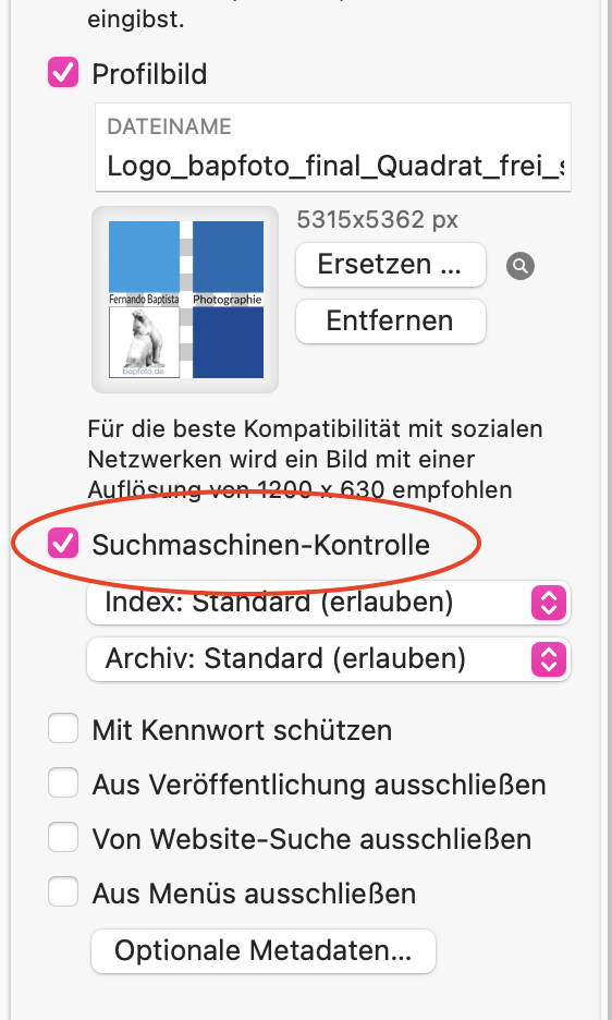

Hi community, just wanna check if this is a normal behavior. After marking “Search engine-control” and saving my site, the mark is gone after reopening site. No difference if website is uploaded or not.
Thanks in forward,
Fernando

A bug. Got it, thanks.
