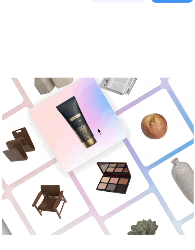

This is what is looks like on the colorful website:
So multiple columns of items, each subtly scrolling in different directions.
