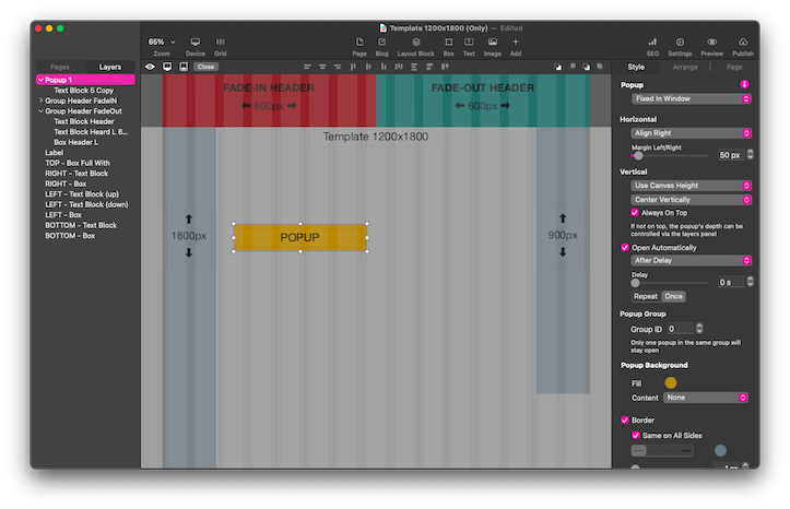

I went for @zbr and @Mr_Fozzie suggestion, and it worked.
The only drawback (imho) is controlling the positioning of the popup,
what you see on the canvas is not what shows on the browser.
(below i have added a canvas + a browser screenshot, so you can see what i mean)
@primo 's method may also be a good alternative (i will have at look at it)
