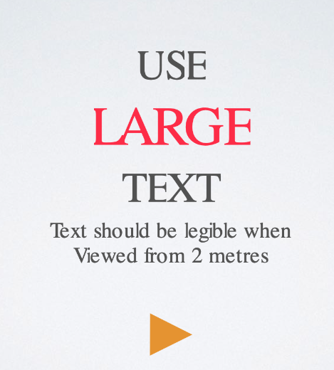

Yep, I use keynote and it works just fine embedded in a web page - also responsive. You can see an example HERE - about half way down the page - online presentations section. If you already have the presentation in powerpoint, just import it into keynote and then export as HTML from there.

But one question: Which font did you use for the presentation?
The display of the font does not seem to be correct on my Mac … some letters are a bit cut off?

When used in its native format, the HTML file generated from keynote does have font dependency. If the viewer isn’t likely to have the font installed, you will see the problem you are encountering. The way to eliminate the problem is to use only common system fonts that most users have. An alternative (assuming you can live without animated text) is to create your text in the slide and then use the Mac screenshot facility to grab an image of the text (Command-shift-F4). You can then drag that into the slide and delete the original text. The font I used was Gill Sans.
