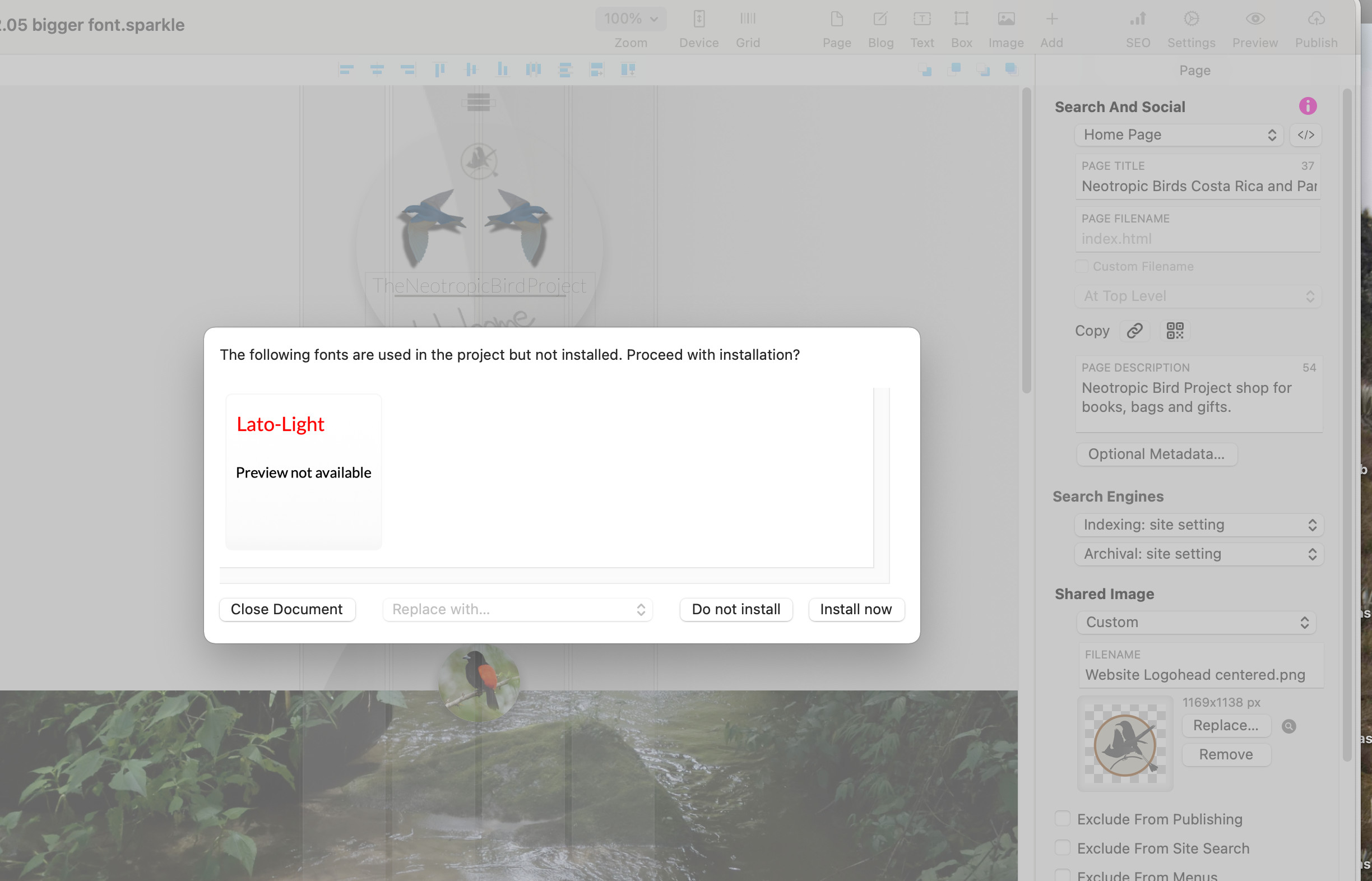

Hi all,
I see few questions on missing fonts but not quite matching my circumstances.
I was working on my sparkle file yesterday. I’ve published the site last year and just adding SEO data and making it more legible on smaller devices. Things were going fine for the most part.
My main font is Lato light which has installed early last year, no problems. No font issues yesterday. This morning I upgraded my MAC OS to big sur (11.1). My Sparkle version is 3.0.6 via the app store.
Opening up my sparkle file, I get Lato Light is not installed. When I open up a new file and add text, Lato light is available.
Should I re-install lato light? What would happen with the Lato light I already have installed? From the new test file I also typed with lato regular (also used in my current sparkle file) also works. But this was not mentioned in the error message when opening yesterday’s file.
Any advice would be appreciated.
Carey
NeotropicBirdProject

Hi @FlaminFig,
I got Lato from a free font site. I think it was Dafont. It is also available on google fonts. When I clicked on the install now, a finder type window opened. I did not go any further as Sparkle had it available when I tried to create a new sparkle file. Also I had deleted the downloaded file once I had it installed.
btw I had installed Lato for use on pages, numbers etc. before sparkle and could with out any warning or error or request to install again after upgrading to big sur.

hi to anyone following this oddity.
to recap:
  1. published site last year. Using font called lato which as available free. Had installed it in Sparkle. All good!
  2. upgraded to sparkle 3.0.6. Merrily updating sparkle file with SEO Assist and making the site more readable on smaller devices. Not yet re-published.
  3. updated my mac os to Big Sur
  4. open my sparkle file and get a message that my LATO font is not installed. But I can see it listed in my font style… odd
  5. I downloaded lato from google fonts. After playing around with a test sparkle file and added text using lato, I open my in-progress sparkle file. And still get error msg that LATO font is not installed.
  6. so I clicked on “LATO-Light Preview not available” and the “replace with …” option bolds. (should have tried this from the start) I click it, and replace with “Lato” and error msg is gone. Looking at my content, the fonts looks good, even my custom name of the style is correct except there is an asterisk (asking if I want to update the style).I click on “apply changes”. and all good. The catch is I have to go through every page and every device to ensure all good. oh well… 2 steps forward, one back. This option is better than switching to a sparkle standard font which would have been more tedious and more work to get a similar look.
Not sure why my fonts were “not installed”. But for now, no road blocks and I’m moving ahead.

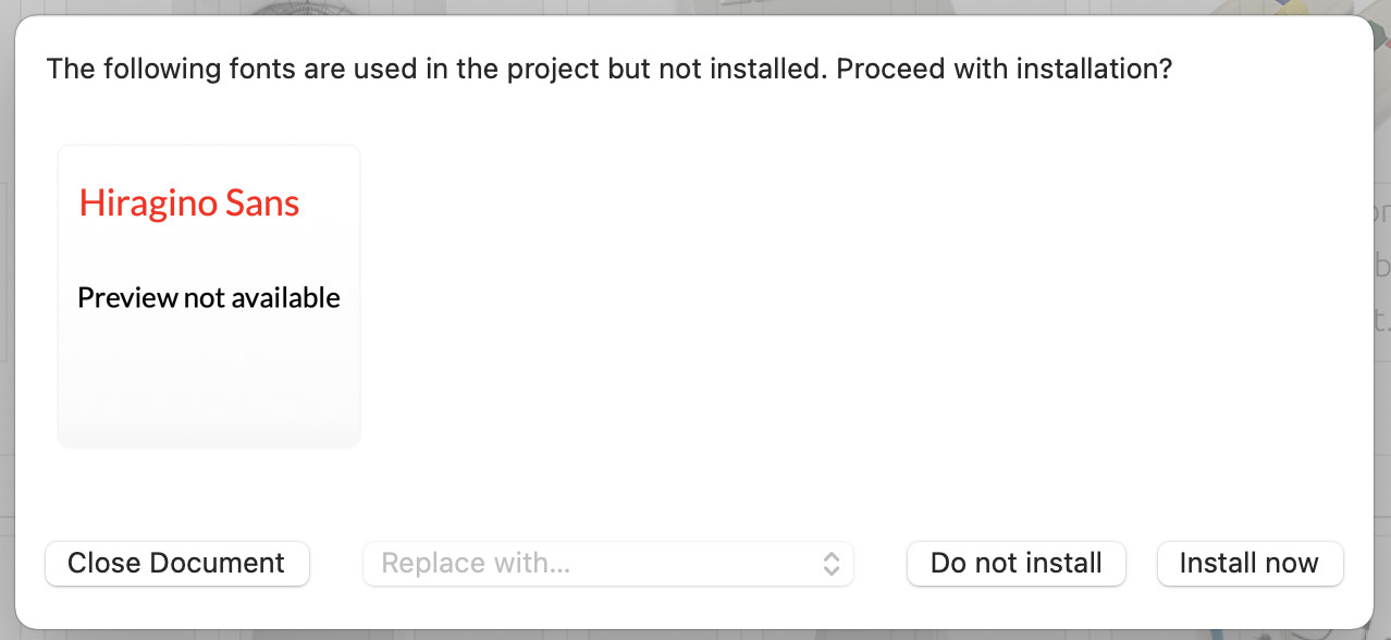

I am running into the same issue. I get prompted about font Hiragino Sans that I don’t recall ever using. I click on Do not install then Sparkle warns me that
Missing fonts will be replaced with a default font, the project appearence will be different from the original.
I click on the Lose custom fonts button and I can then start to use Sparkle.
I flushed the cache per @primo’s suggestion but that didn’t make a difference. This has been happening for many months, with version 2.8.x and every update since.
Here’s the thing: I made a copy of my Sparkle document as a “sandbox”, i.e. it’s where I get to experiment with new features before I go live with them. On the sandbox copy, I do not get the error message. I don’t recall if I made the copy using File → Duplicate from within Sparkle or if I did so in the Finder.
@Duncan, this issue is not a showstopper but it is annoying.

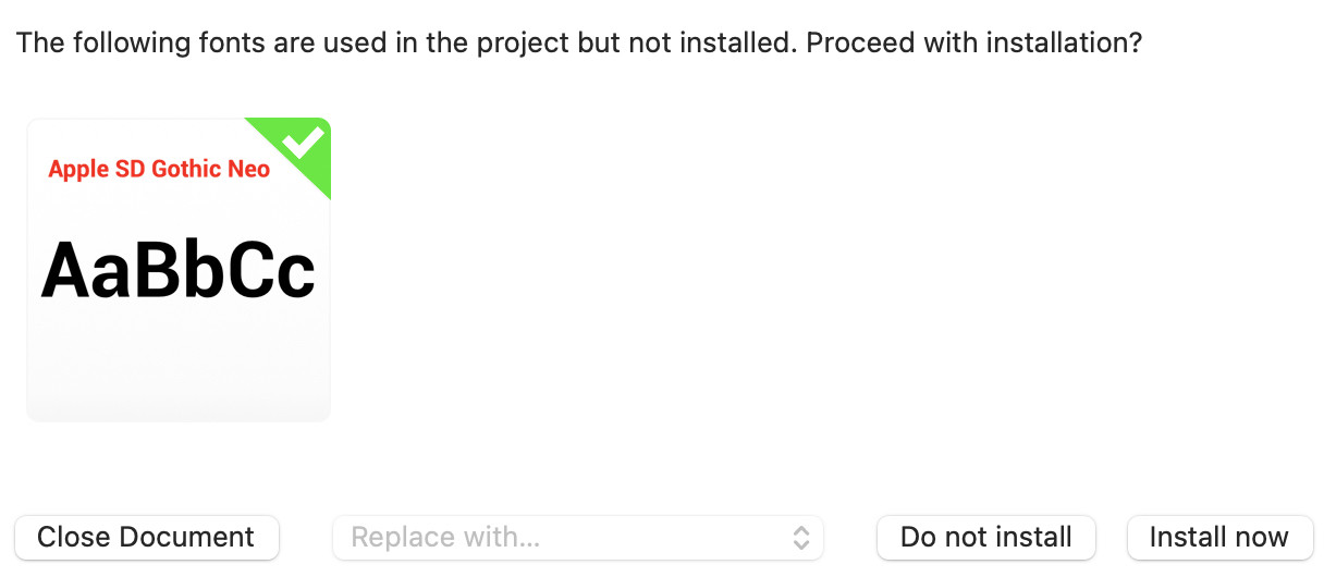

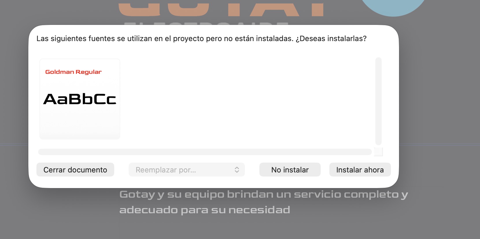

I have the same font problem: a popup saying not installed. I clicked “Install Now” button, and closed Sparkle. when I opened Sparkle again, the same popup appeared.

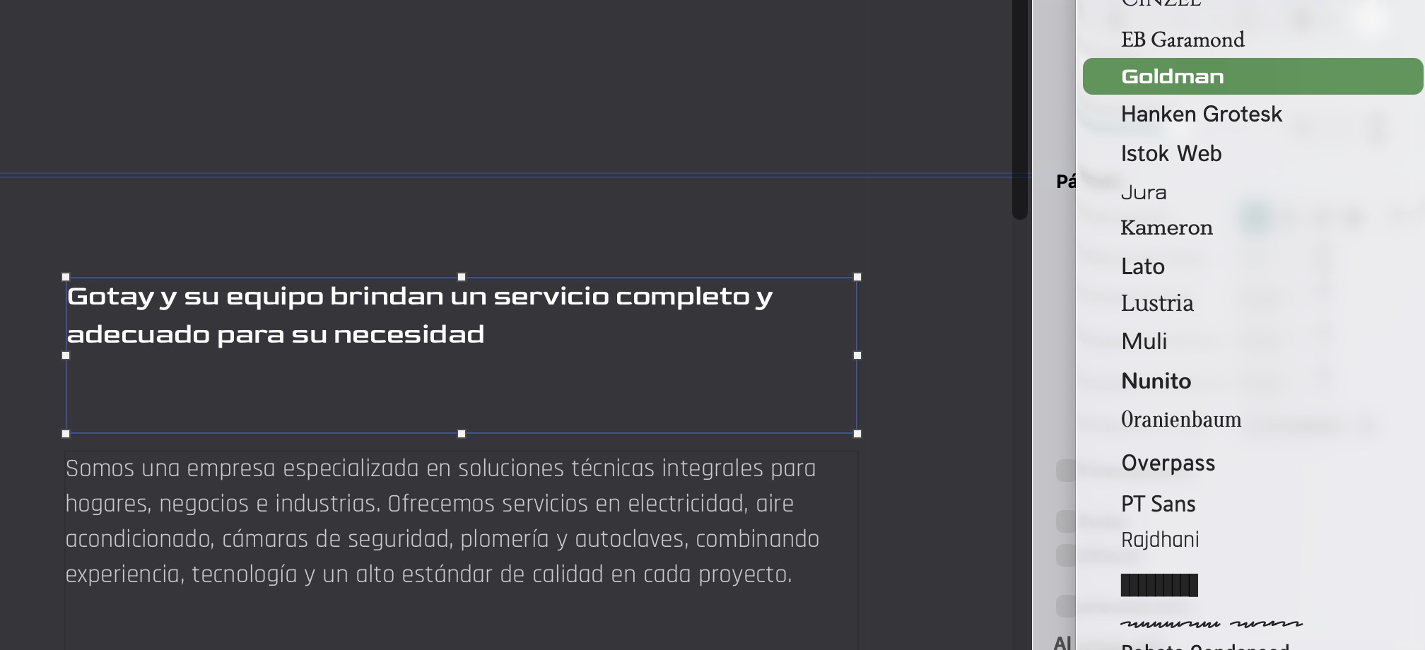

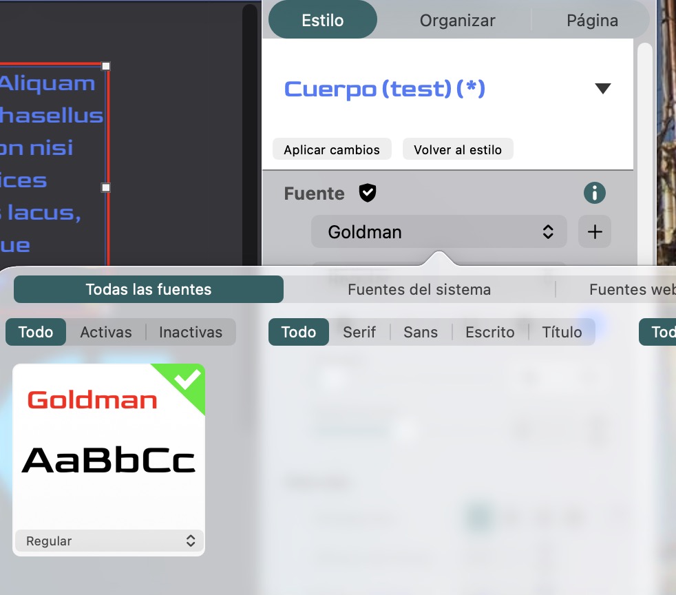

I do have exactly the same problem. Every time Sitely says the font is not there, but inside the fonts (of sitely) it appears with the green corner, confirming it’s installed.
