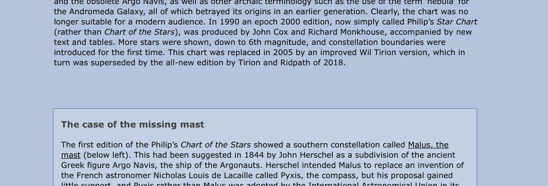

I am now making up my first pages with Sparkle and have found an annoying display problem when zooming in Safari. Go to this page and scroll down to the box near the bottom
http://www.ianridpath.com/books/starchart.html
When zooming up one level, the gap between the text and the box becomes too large:
When zooming to the second level, the text overlaps the bottom of the frame and is lost:
The behaviour changes again with subsequent zoom levels. I have reproduced this on multiple devices under Catalina and Mojave.

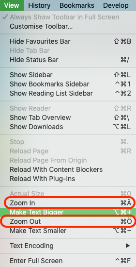

As discussed in the other thread, what you are doing there is scaling the text, not zooming the page. My safari doesn’t even have the text scaling option, and as far as I know all modern browsers only ever scale the full content.
We can’t reproduce the issue, I do see it in your screenshots, but what’s the case where this happens?
No, that was another user who was scaling the text. My Safari has only the Zoom In and Zoom Out options, i.e Command + and Command –.

The gap is due to the use of system fonts (verdana). You should use a web font to get better text consistency.
The “make text larger” option messes up many websites I looked at, and while it is in theory possible to work around it, in practice it is very disruptive and I don’t think anybody using it expects things to work. We will not be supporting that in the short to medium term in Sparkle.
I understand that, and (as I said) I am not using Make Text Larger, just the usual Command Plus and Minus which zooms the whole page.

I do see some rendering variability, but no breakage.

As I mentioned in your previous thread, your zoom shortcuts are not set up as command + and -, I think this may have much to do with the issue you’refacing. For some reason, your system, and maybe others that have experienced the same issue maybe activating the text size option when using these shortcuts. I would go into your keyboard preferences and reset the keyboard shortcuts to their default settings.
Also check that your modifier keys haven’t been set up differently.

Sorry, but you mixed up Ian and me.
You were talking to me (Shadowfax) about the shortcuts in the other thread.
My personalised shortcuts have nothing to do with Ian’s macOS on his Macs and his website …

Just to reiterate the point I am trying to get across, the real problem is that boxes and pictures are not moving up and down in step with the different text lengths when I zoom. In the sample page I have linked to, there is either too much space above the box or the text gets clipped. As Greenskin noted, it happens in Safari, and to a lesser extent in Chrome, but not in Firefox. My old pages made in Quark did not suffer the problem so I suppose it is something to do with the different coding in Sparkle.

And to reiterate my answer, yes there is different rendering, but no actual breakage. What you see in the screenshot of our documentation there is text wrapping bumping a line above or below the wrapped image. This is not breaking the page like text clipping would be, and it’s actually a relatively rare issue because relatively few people actually zoom the pages in.

Understood, but the text on my page is being clipped, which is what my original screenshot showed, and it wasn’t happening in the old Quark 9 layouts.

@ianrid, Oh are you meaning the text box should flow (extending its height) as you enlarge the text. If that it what you mean then the answer is simple… Sparkle works as a fixed width responsive platform and all the elements you place on the canvas is fixed and do not flow relative to one another like in what they call fluid width design.
So the solution is let you “canvas breath” (white space) and allow for adjustments (like enlarging the page) by giving the text containers extra white space at the bottom of the text container. Everything squashed up on a page can have more things go wrong with it, like zooming into the page.
Yes, I am expecting pictures and other boxes to retain their position in the text as I enlarge or shrink the page, which is what happened on my old pages made with Quark. I normally set the Page Zoom to 115% or 125% in the “Settings for this website” option in Safari, and unfortunately the result now looks wrong, as my screenshots showed. As you mentioned above, Firefox has a different rendering engine which keeps text the same at all levels of zoom, but sadly this doesn’t happen with Safari. I will experiment with web fonts to see what effect that has.
