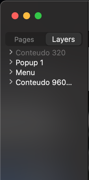

Hey!
I have a tip. It’s a little bit more manual, but the 320px gets the way you’d wish it to be.
I start making content first for 960, then after i’ve finished, group everything up and set the group layer a name ( like “Content 960”).
After that, i just change to the size i’ll design next and hide that grouped layer on that specific device.
This example i’m at the 960 view with the 320px content hidden. Then every size looks exactly as i want it to be.
But remember, it it a little bit more manual.
@primo, Just clever!
I’ll try this for sure. Thanks for the tip.
