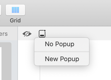

You create a popup from the top left popup thing in the format bar, selecting “New Popup”
This creates a default normal popup, changing settings to this is a start:

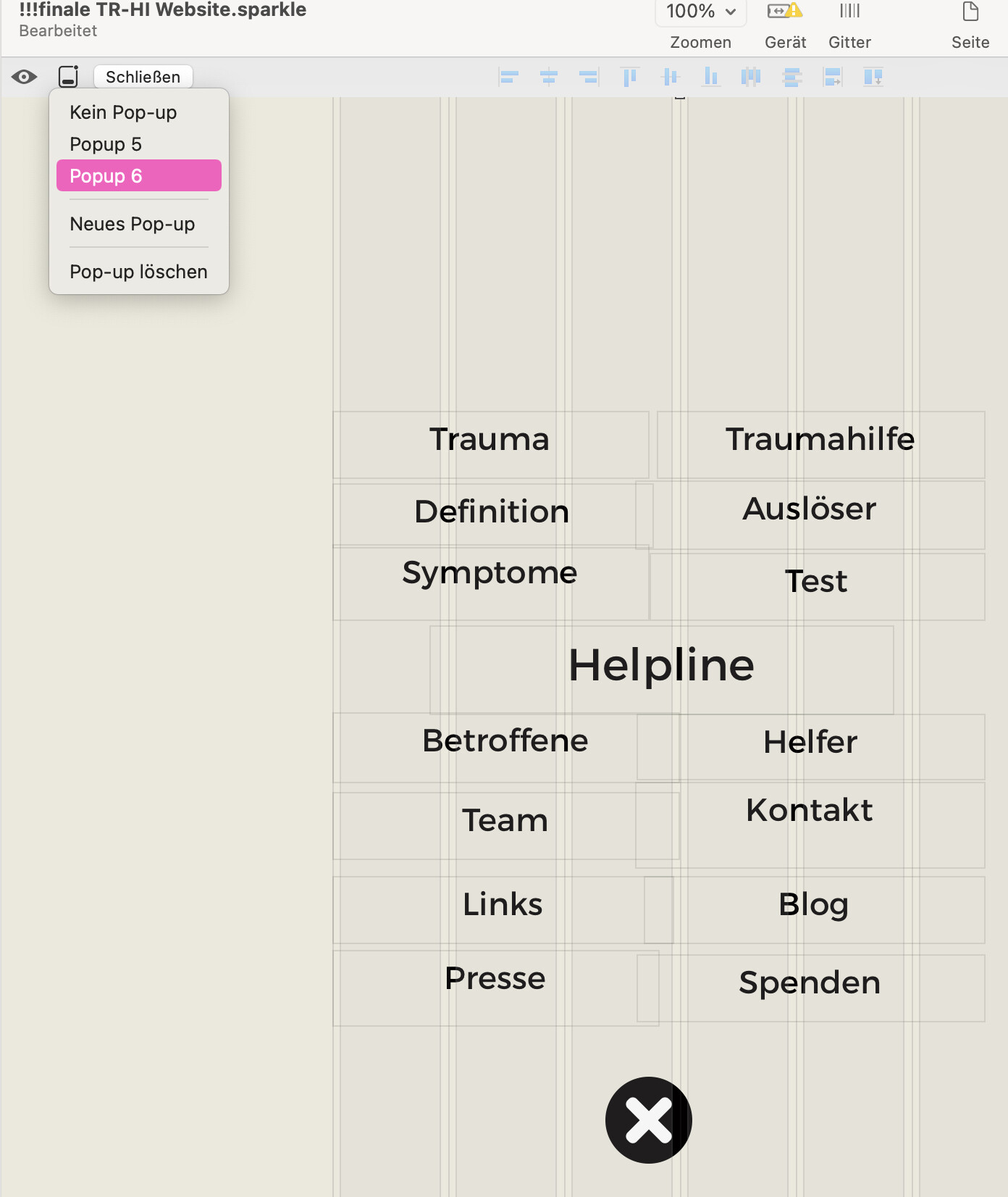

I have only one Problem… The words in the big menu lead to separate pages of course… but how can I open the pop up on every page again, to look at other sections/pages of the website? If I open the pop up menu on the left on the other pages where I didn’t not create it, my pop up name is not there… Even tried adding a random pic and make it an “open pop up” button. But I can not choose my created pop up from any other page than the one I created it on top of… which seems strange.
They way I´m thinking is that the (option to open the) pop up needs to be on every separate page of my site structure for it to work as menu…
Is there a way to make the pop up show up on every page for the mobile devices? Otherwise I have no way to jump all the menu pages if I can’t access my pop up menu.
am I missing something?
If you make the original button visible on all pages, it will work.
@duncan: are you referring to the x button that appears when creating a new pop up? it doesn´t give me that option to “show on all pages”… it´s greyed out.
with the hamburger icon- the one that opens the pop up, I CAN show it on all pages, BUT the pop up I created on the first page can not be accessed from the other pages. it doesnt give me “pop up 5” or “pop up 6” (which are the same, I just tried to find if I do the pop up thing again, if it then works) … made a few screenshots… sorry they are in german
