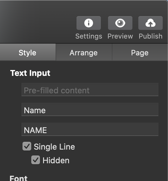

I’ve been trying to figure out how to add a (input type=“hidden”) to a form in Sparkle. Any thoughts or tips?
@icecycle, Welcome onboard!
If I get what you are asking then yes you can…
When you have selected your, say, name input container you’ll see on the right-hand panel below “Single Line” a tick box next to the tile “Hidden”. When selected it will show dots instead of alphanumerical when content is entered.

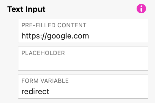

Adding to this request:
I am trying to add a hidden field to my form to tell the next page where to redirect after handling the form (using advanced form submission). The form field in “regular” HTML would be:
<input type="hidden" id="redirect" name="redirect" value="https://google.com">
I tried two methods in sparkle, which didn’t seem to work:
- Create a hidden text field with the URL pre-loaded as filled content
- Create a code snippet with the HTML noted above
Neither worked, the last one obviously couldn’t be included in the form but it was an attempt at a hack.

The former should work except for the id, which I don’t believe is sent in forms.
I just tried and sure enough:
And the generated code:
Perfect! Thanks @duncan
