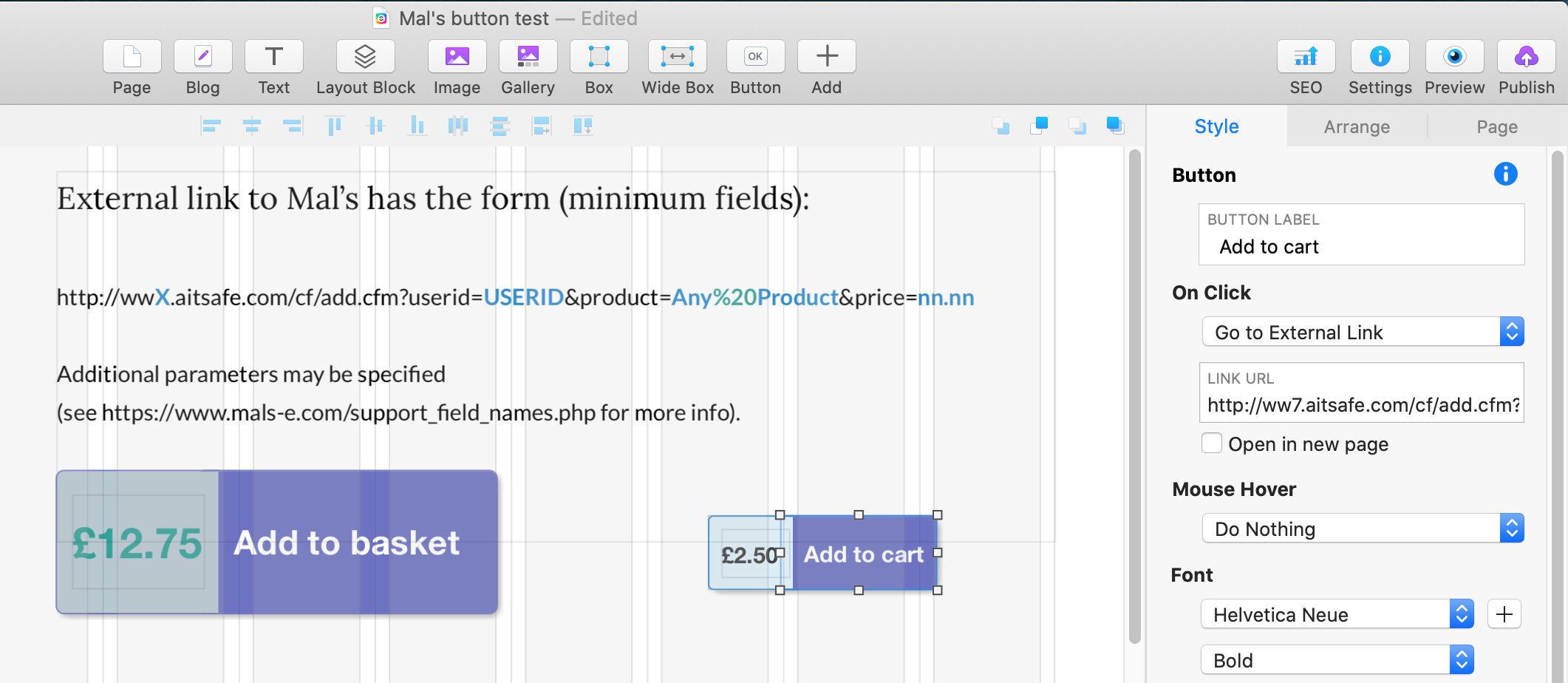

It so happens that I am planning to implement a new mini store. I remembered that I’d used Mal’s Ecommerce before Ecwid came along, so I was just revisiting it today as I’m trying to keep costs down!
The free version of Mal’s offers a surprising amount. It is simple to integrate with Sparkle as these test buttons show:
The biggest drawback with Mal’s is the lack of inventory control in the free version. This is why I suggest using it only if you have less than 20ish products that do not change much.

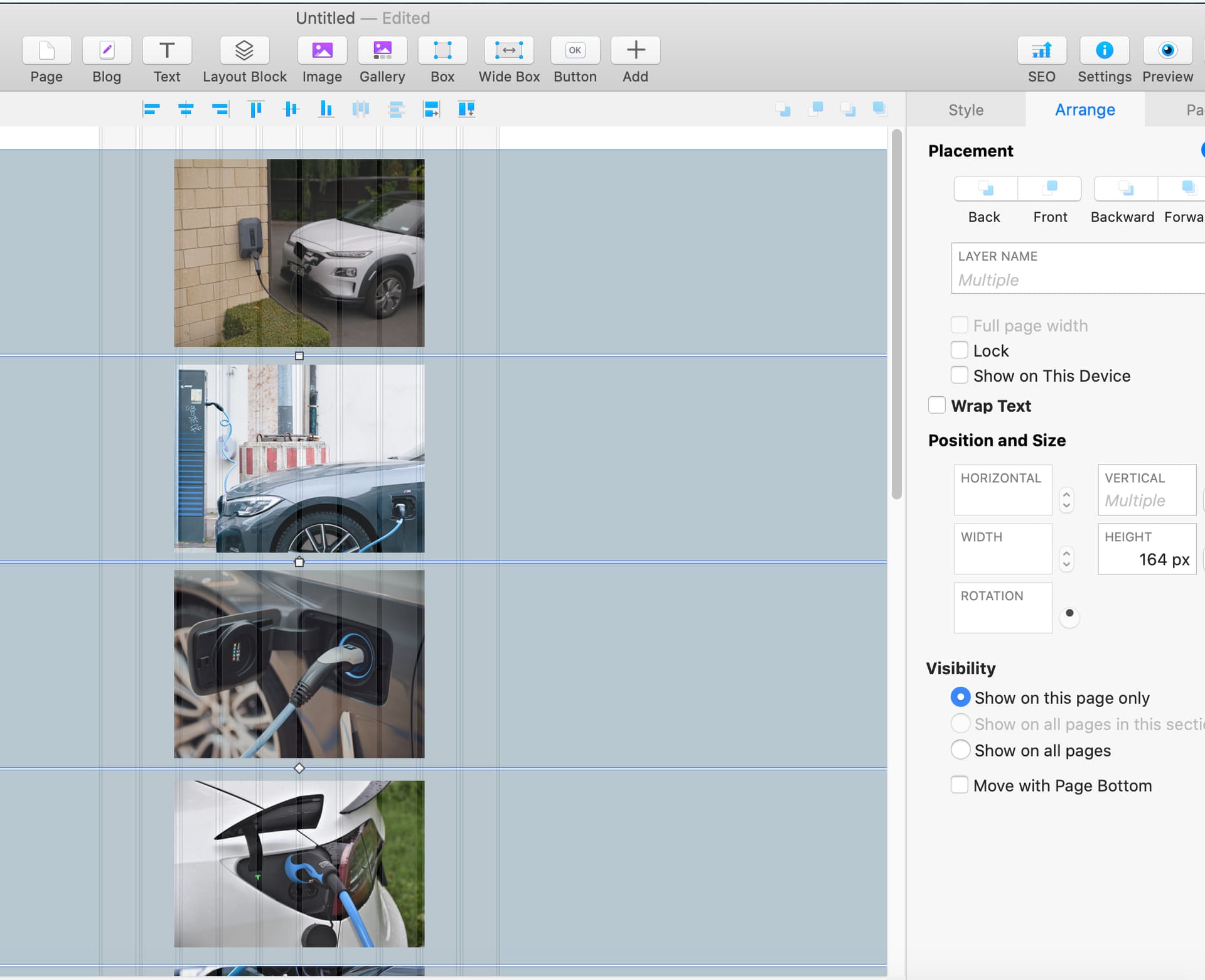

Don’t you think @FreewayFugitive that under Arrange / Show On This Device is the equivalent of “display : none” for an element on a page?
What’s the use case for hiding something on a page? Sorry but I don’t see how the context helps understanding what it would be useful for.
I ask because it seems you have settled on what would solve some problem, and are focusing only on what you think is missing (hiding something), but you might be overlooking alternate routes to a solution that are already possible, if not simpler.
@FlaminFig Yes, but only on that device. I was looking for Arrange / Show On All Devices. Of course it’s only a few clicks on each device to do this (I was just being lazy).
@duncan Sorry Duncan I’m probably missing something obvious by using antiquated thinking from my Freeway days!

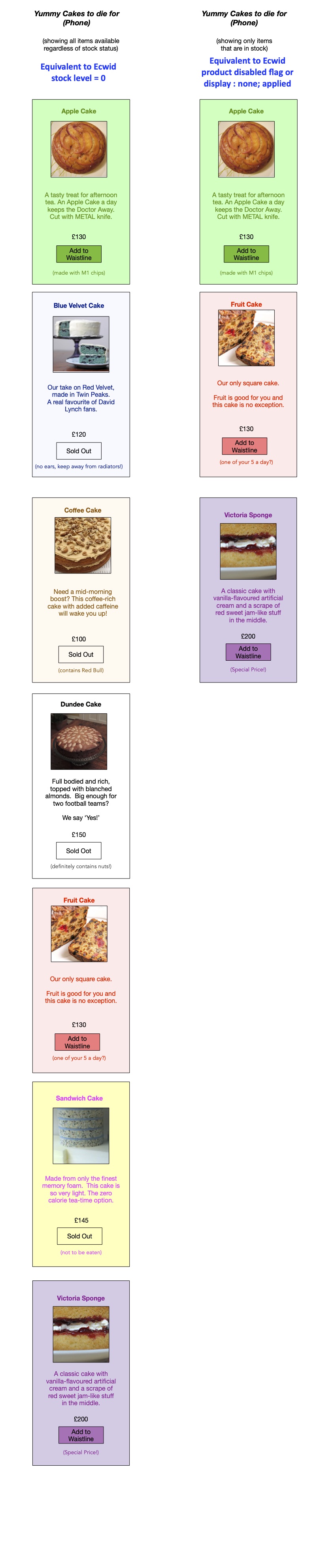

What I’m proposing to do is to pilot a small store, probably 20 items (so too many for free Ecwid), in Sparkle using Mal’s Ecommerce free version (so no inventory control) to handle the shopping basket. When I last did this some years ago I was using Freeway.
Let’s assume the store is selling cakes. Some cakes sell out, so can no longer be ordered. It may be some time before they come back in stock (but they will). There are many ways to handle this situation.
For instance, overlay the Buy Now button with an Out of Stock button that does nothing. This effectively matches what Ecwid does when the stock level is zero. In Sparkle, this will cascade properly through all devices. Remove the Out of Stock overlay and hey presto it’s back!
However, this takes up browser real estate showing cakes you can’t have. Not too much of a problem on a wide screen device but you can end up having to scroll past lots of Out of Stock items on a phone, which many users won’t do (left hand column of this image).
Another option is to only show in stock items. Ecwid does this using the product Enabled/Disabled setting. In Freeway the same effect was achieved using display : none on the enclosing layout block, which applied at all device breakpoints. This produces the right hand column effect in the above image on all devices.
The point is to show what is for sale not what can’t be purchased.

What you can do on the mobile device is to have a layout block “Out of Stock” beneath everything that is in stock, so having each product grouped via layers you can simply drop that group inside the out of stock layout block. It won’t auto arrange perfectly on the canvas, but it will be way down below.
But ticking off the “Show on this device” only for the mobile device would be a better alternative for the “display:none” method

The trouble with “Show on This Device” unchecked is that it still leaves the space that the object would have occupied behind, so you get gaps. In the example below the middle two layout blocks have “Display on this device” unchecked.
produces
If when you unchecked “Show on This Device” Sparkle applied display : none then this would close the gap.
Steve
oh okay, I see your angle
is not that display:none fills the gap, it merely doesn’t display the element
the gap filling is result of automatic responsive technology (probably Bootstrap), which we know Sparkle uses a fixed design meaning you would have to close the gap by yourself by dragging the element up.
but as far as functionality goes, ticking off the “show on this device” has the exact same effect as display:none, but it is conditioned to that specific device.
