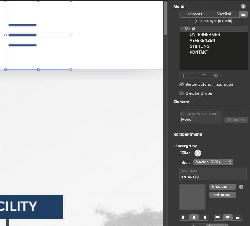

But now the next problem appears:
I’ve changed the icon to an SVG-file. The align options are not working. For example: I can not align the icon centered or even right. It just stays at the left border.
As you can see in the screenshot: The icon should be centered, but it stays on the left. Maybe a bug?

Perhaps the SVG has a horizontal padding? This would cause it to not shift horizontally. I have tested this with a couple SVGs and they do align as requested.

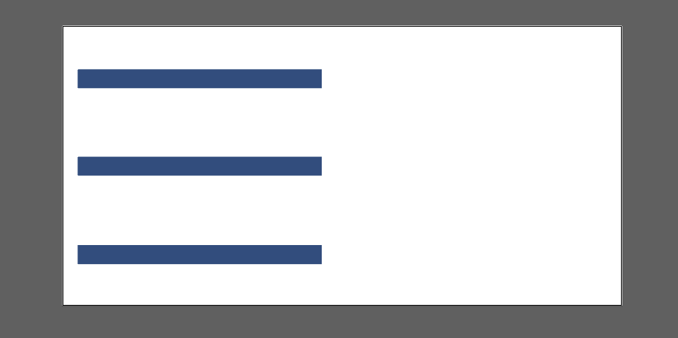

Aaaah … Duncan, you’re right!! I forgot that I put a white space to the right of the menu - as you can see in the screenshot below. I used this menu graphic in the past for adobe muse, therefore it was a necessary “hack” for the burger menu to put it correctly in.
Thank you for this important hint and the - as always - great support!
