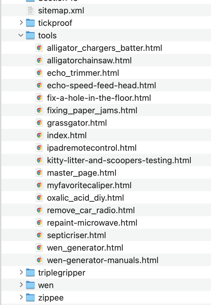

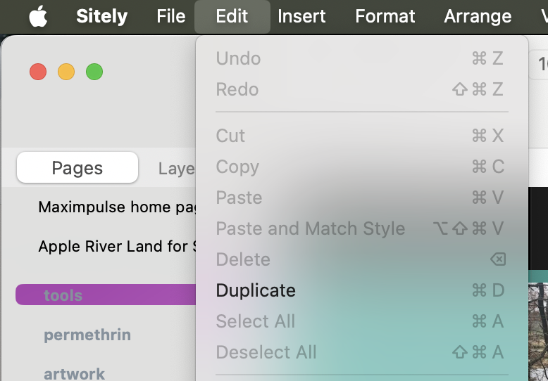

I just took a quick look at this sitely website of mine which has folders. It’s been a while, but I believe I imported the whole mess into Sitely.
In one of these images you can see the list of folders in Sitely. When the pointer lingers at far right edge of a folder, a X in a circle and a right arrow appear. I dunno what the X does (I’m scared it might delete the folder) but clicking the right arrow shows the contents of the folder.
sitely x and arrow

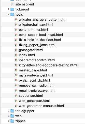

Here are images of an opened folder in Sitely and in the Finder
The point is I can see folders in Sitely’s lefthand list. It isn’t just sections or an endless list of individual page files.
As I say, I think I accomplished this by importing the whole website but it’s been way too long to recall clearly.
But I can’t see how to add a new folder to this list. I tried just now quitting Sitely and then creating a new empty folder and reopening Sitely, but the new folder does not appear in the list.
This is why this thread started with “I can have folders but I can’t make folders”.
I suppose making a new folder and then re-importing the entire website might allow Sitely to recognize the new folder but that seems a bit crazy.

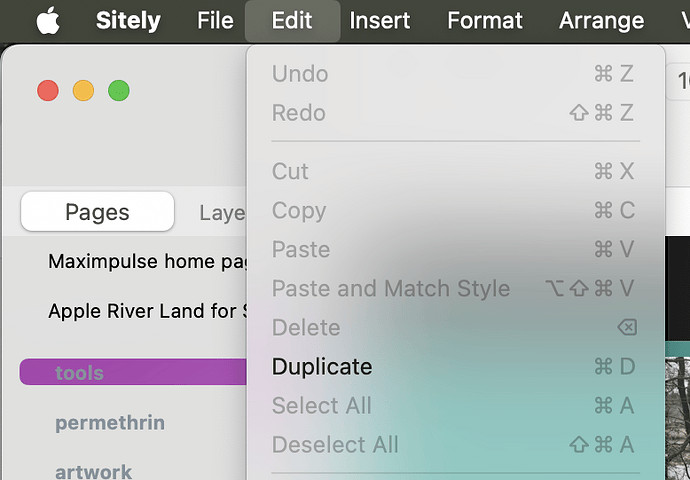

And just now I looked and I see I can Duplicate a folder…and then re-name it…
I haven’t tried it yet.
Any thoughts?

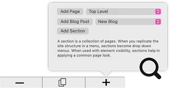

I’m not sure if I fully understood your request, but if you want to create new “folders” in the list of pages on the left side of Sitely, note that in Sitely, these “folders” are called sections. It’s important to differentiate between sections and folders, as they serve different purposes, as I mentioned in my previous response.
Folders are defined in the page settings and are used to structure URLs and the exported files on the server.
Sections, on the other hand, are only for organizing pages within the Sitely interface. They have no impact on your site’s URLs or on the file structure exported to Finder.

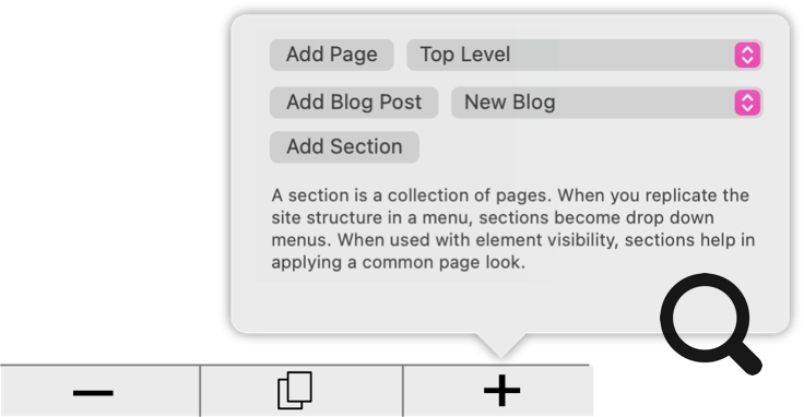

You can create a section by clicking the “+” button at the bottom of the page list, then selecting “Add section.”

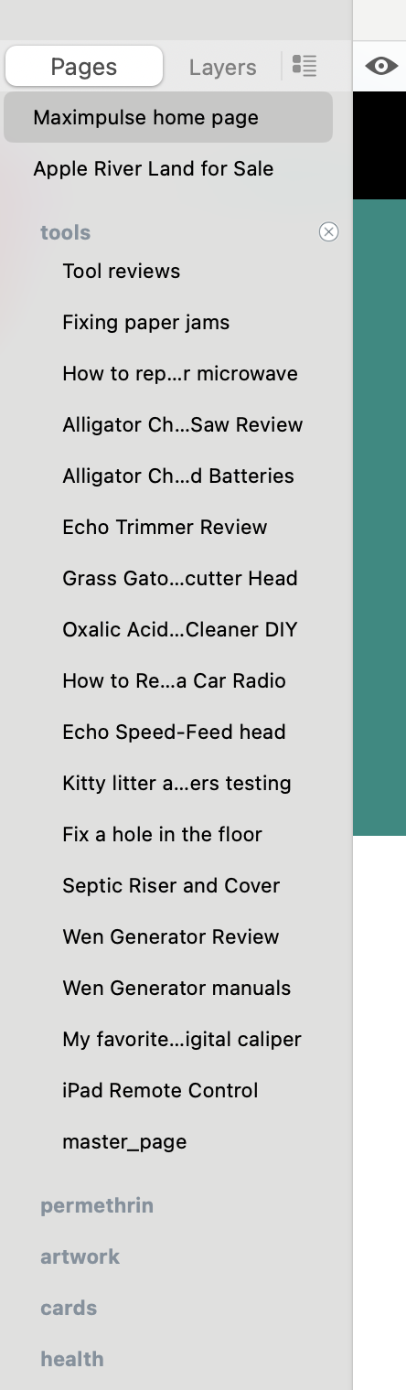

Regarding your question about having sections within a folder (or vice versa), the answer is no. As mentioned earlier, folders and sections are independent and function differently. However, to better organize your project, you can group all pages from a particular folder within a section of the same name, which already seems to be the case for your “tools” folder.
Moreover, I confirm that clicking on the cross next to a section’s name will delete both the section and all the pages inside it.

I used sections in Sitely, if I am recalling correctly, to mainly deal with menus and submenus.
I’ll admit it is a mess.
