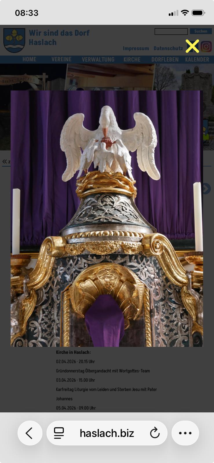

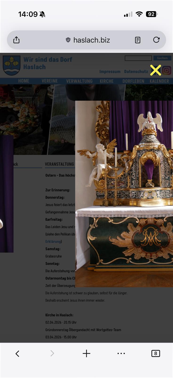

What about this… same site, differnt browsers, only on handys…no problems on desktop, not on tablet:
in iOS 26.3.x:
in iOS 26.4 (nothing changed on the site, tested in 3 Browsers:
