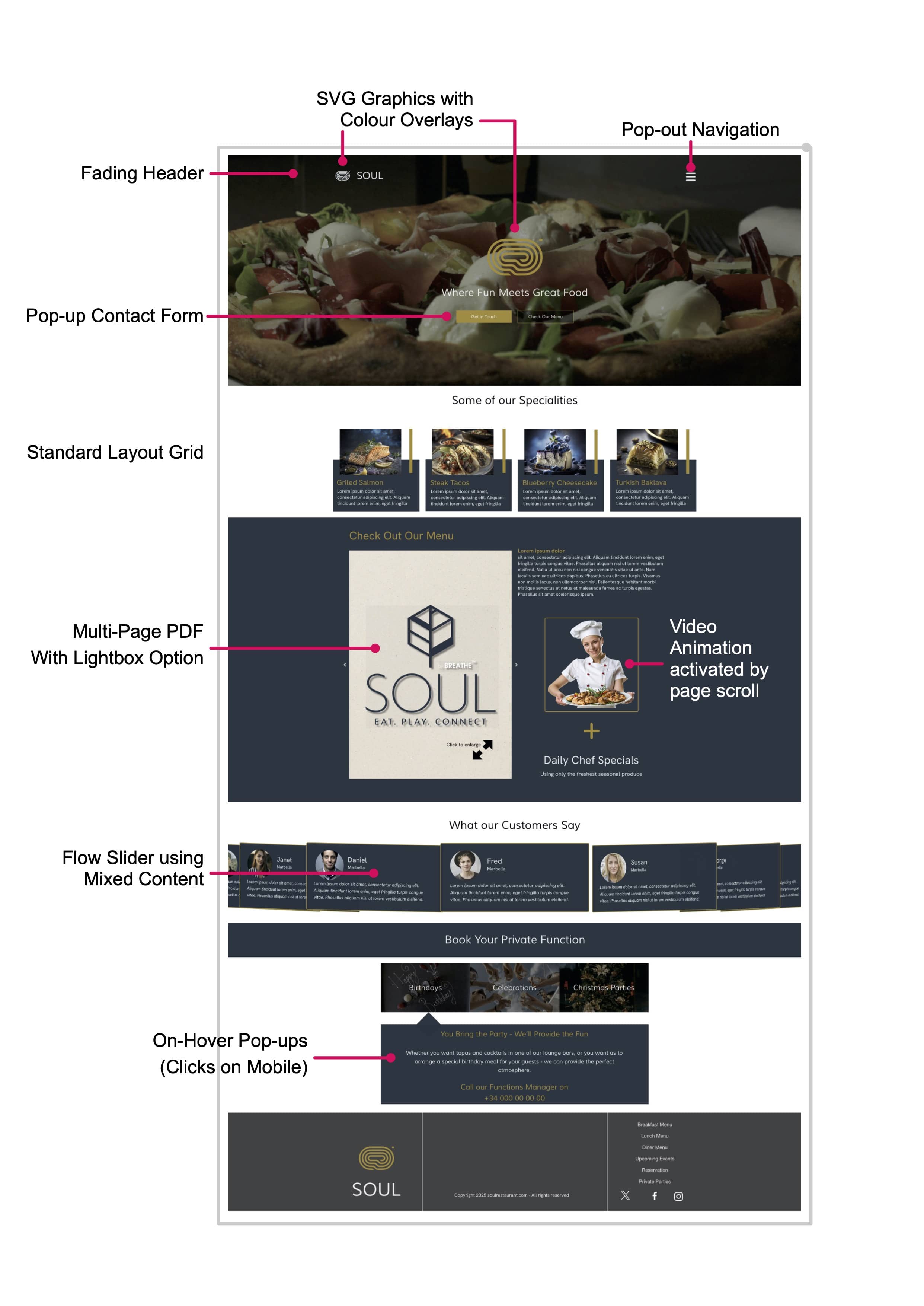

I’ve uploaded the sample file to SwissTransfer, where it’ll stay available for about 30 days. If you’re reading this after it expires, just send me a PM and I’ll happily re-upload it. The image below is a preview of the page and the features it demonstrates.
When you open the Sitely file, I’d suggest giving it a quick preview first. Seeing the finished page in action makes it much easier to understand how everything fits together before you dive into the layers.
Inside the file you’ll find everything neatly organised into layout blocks, groups and popups, all clearly labelled in the layers panel. Once you start clicking around - and checking the style and arrange panels - you’ll quickly see how each element was put together. Hopefully it sparks a few ideas and gives you something new to try out.

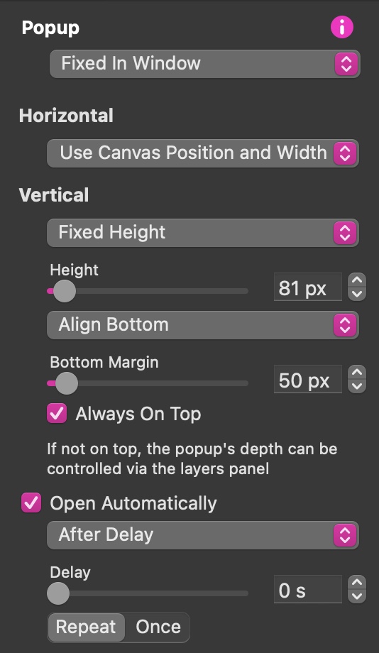

Do you have a tutorial for a “button coming later down on the side which jumps up to the head of the page” please?
Not quite sure if I’ve understood you well, but I think you want a button placed somewhere on the page that will take users back to the top of the page which becomes visible as the page is scrolled. If I’ve understood you well, what you need to do is create the button in a popup that you can fix to the browser edge (left, right or at the bottom of the browser window. The popup should be set with the following parameters (assuming a browser bottom position).
The important thing here is to ensure the Repeat option is selected. If you don’t do that, the button will disappear after using it once. I assume you would want it to remain active after it’s been clicked.

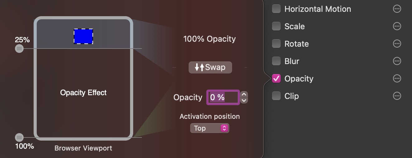

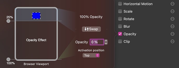

To make the button appear a little after users start scrolling, just add an opacity animation to the button with the following settings.
This will make the return-to-top button appear after the user moves 25% down the page.

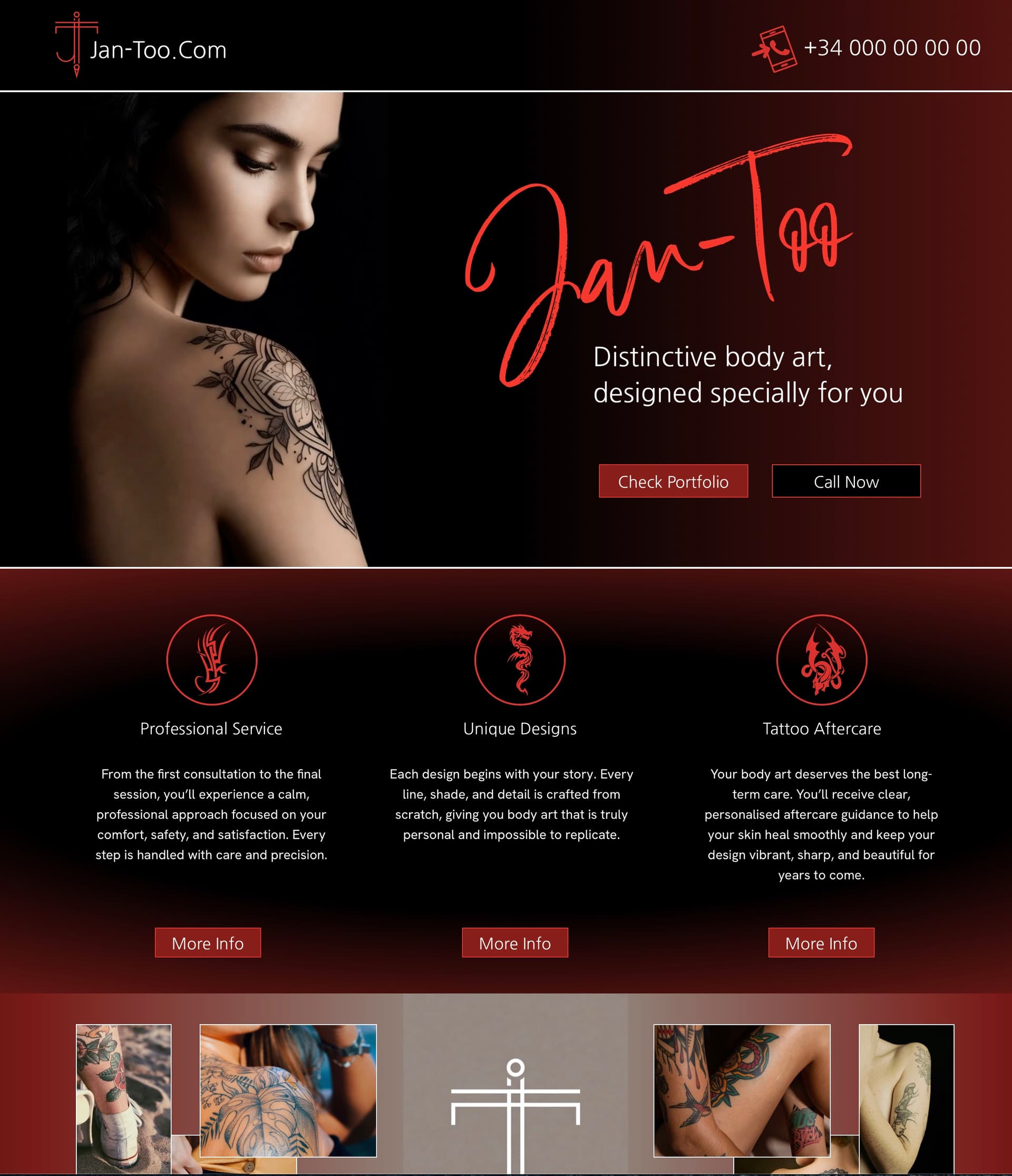

Here is a sample of a page when its first loaded - notice it doesn’t have a back-to-top button.

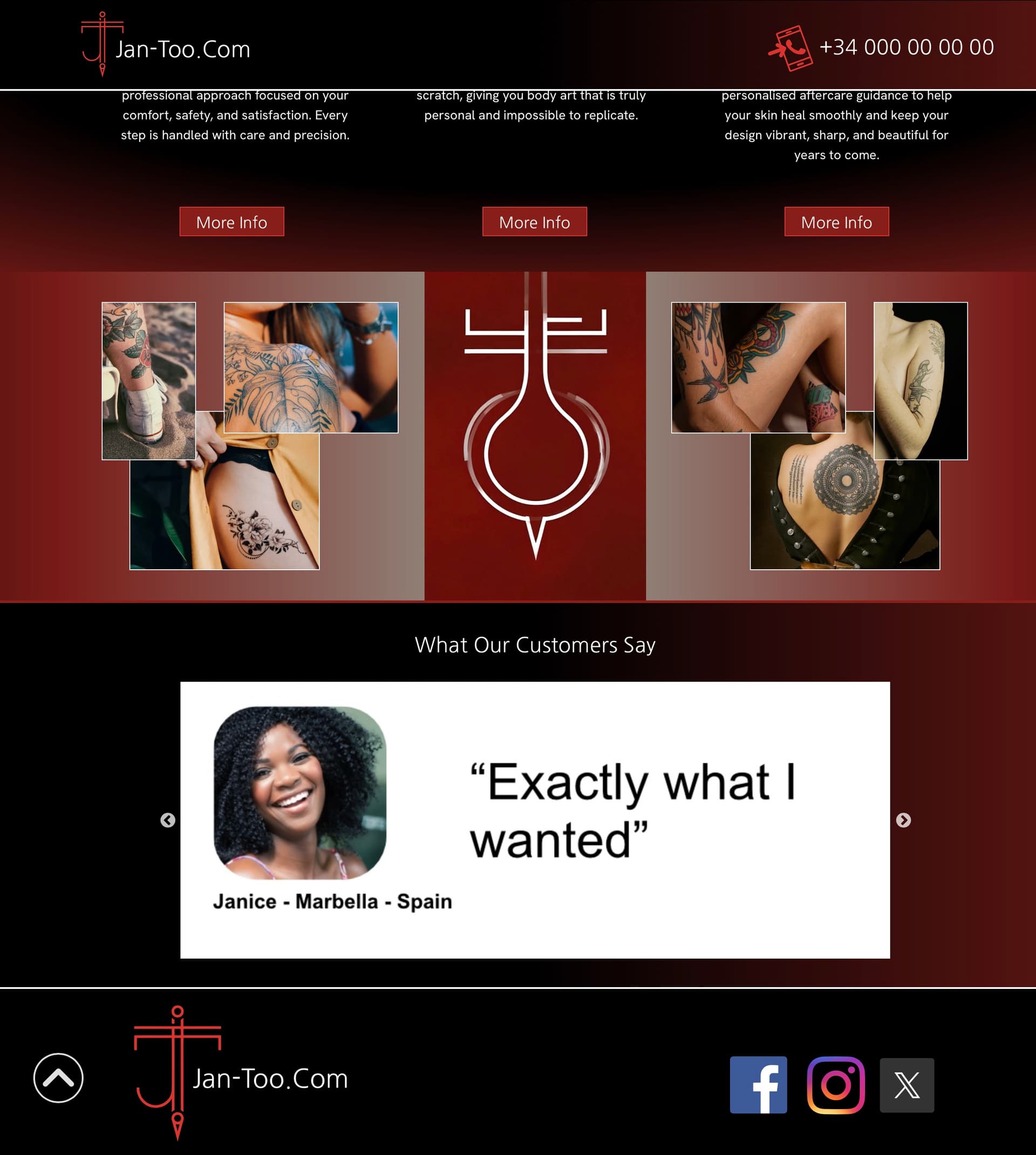

As the page is scrolled, the button appears at the bottom-left of the screen.
Using this method, you can position the popup in any location you want. Just remember to make the popup with a transparent background and ensure that it doesn’t obscure any important content on the page.

I forgot to mention that the opacity settings I applied to my example will make the button gradually appear from the 25% point - reaching full visibility when the page bottom is reached. If you have a particularly long page, you may want to adjust the bottom 100% slider to about 40% - this will make the button fully visible earlier, where it will remain for the rest of the page scroll. Hope it all works for you.

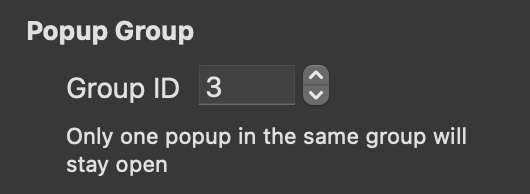

hmmmm. it kills all other PopUps, which should stay open on mouse over (the navigation) but close instantly…
A simple issue to resolve, Just give your popup a unique group ID. In my example, I gave it a group ID of 3. This ensures that other popups on the page remain open.
And there it goes :slight_smile: Thnx…that works…
