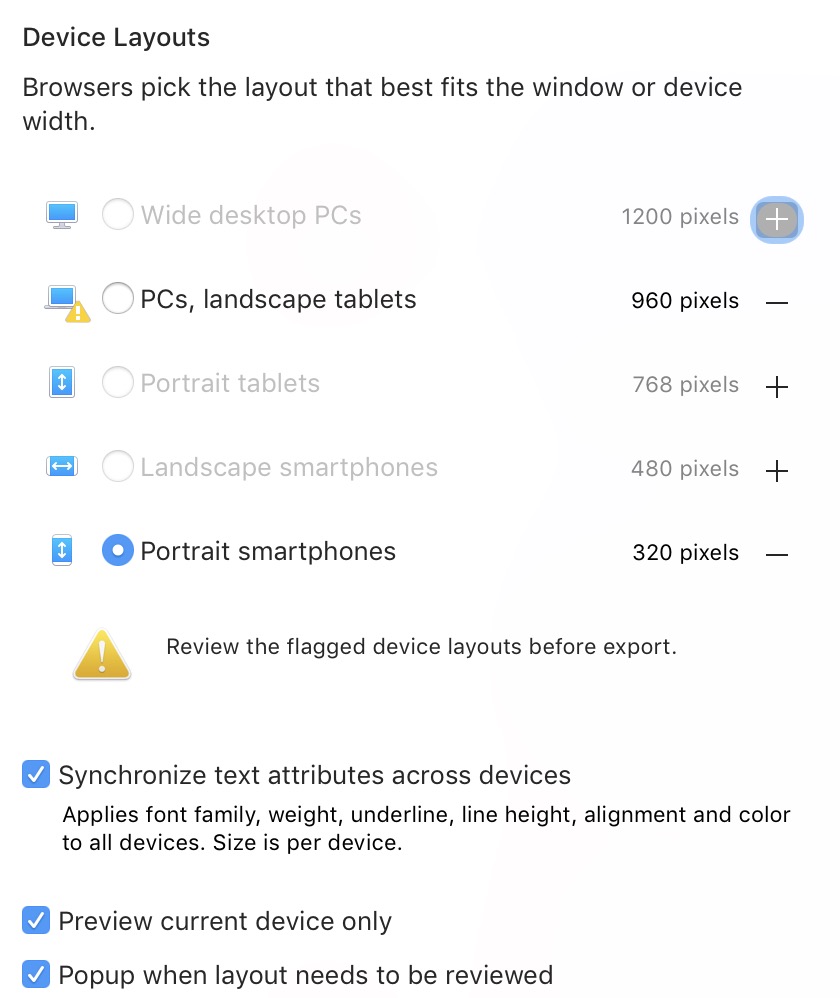

See the Device Layouts palette and be sure to check all of the boxes in the bottom list of options.

When you open your Devices tab which tick boxes are ticked at the bottom of the Devices pop-out window?

@producerguyaz, What are you trying to achieve? Your text is shared across all the devices but if you want to make styling totally independent per device then that styled image we talked about… you remove it by unticking “Arrange / Show on this device” and in place create your image for mobile with that different style you mentioned. Once done you need to go back to your desktop device and click on the mobile image you just created (it will show up on the desktop device) and do the same thing - unticking “Arrange / Show on this device”. That way you can make your mobile device look totally different in layout and style to your desktop device.

Settings such as drop shadows and animation apply the same to all device types that you have active.
Option 1
Keep your design choices subtle and test them by previewing each device until you are satisfied across the board of devices that you are using.
Option 2
Design for one device type, hide those elements on your other device types and create new ones with the styling that you want and hide those on the other device types.
You can shorten the ‘create new ones’ with some clever copy and paste/hide on this device combinations. Once the penny drops, it becomes a very fast process.
