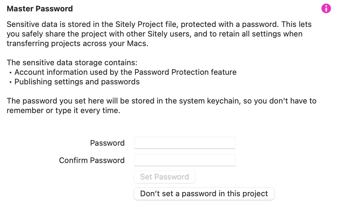

The master password encrypts sensitive information in your project, so publish settings (because they contain your FTP password), and user accounts (because they contain passwords of your users).
This means export to disk settings are not stored in the encrypted area of the project and don’t need a master password.
It’s unfortunately not surprising that some of our customers don’t recall ever being asked to set a master password, but it’s exactly what happens. As mentioned the encryption has been there for a while, and you only need to create a new project and configure publishing on it to see that you’re going to be asked for a master password.
That said there is also the option of not having a master password, by clicking the “Don’t set a password in this project” button, and presumably that’s what you have on your project with password protection.
Arguably the user interface contains too much text, and people really resist reading. But what it says is I think is pretty clear.
Thank you Duncan for your (as usual) clear and quick answer. The only thing: I was checking my project with password protection but couldn’t find the “Don’t set a password in this project” button. Does it mean that I put a MP?
In the Master Password section I would be able to change my MP. When would I be asked to enter the “master password” (if I had set one)?
Thanks again.
In the master password section the “Don’t set…” button is not enabled if you already have set the project to not have a password. That’s where you change the password if you already have one, or set it if you don’t.
