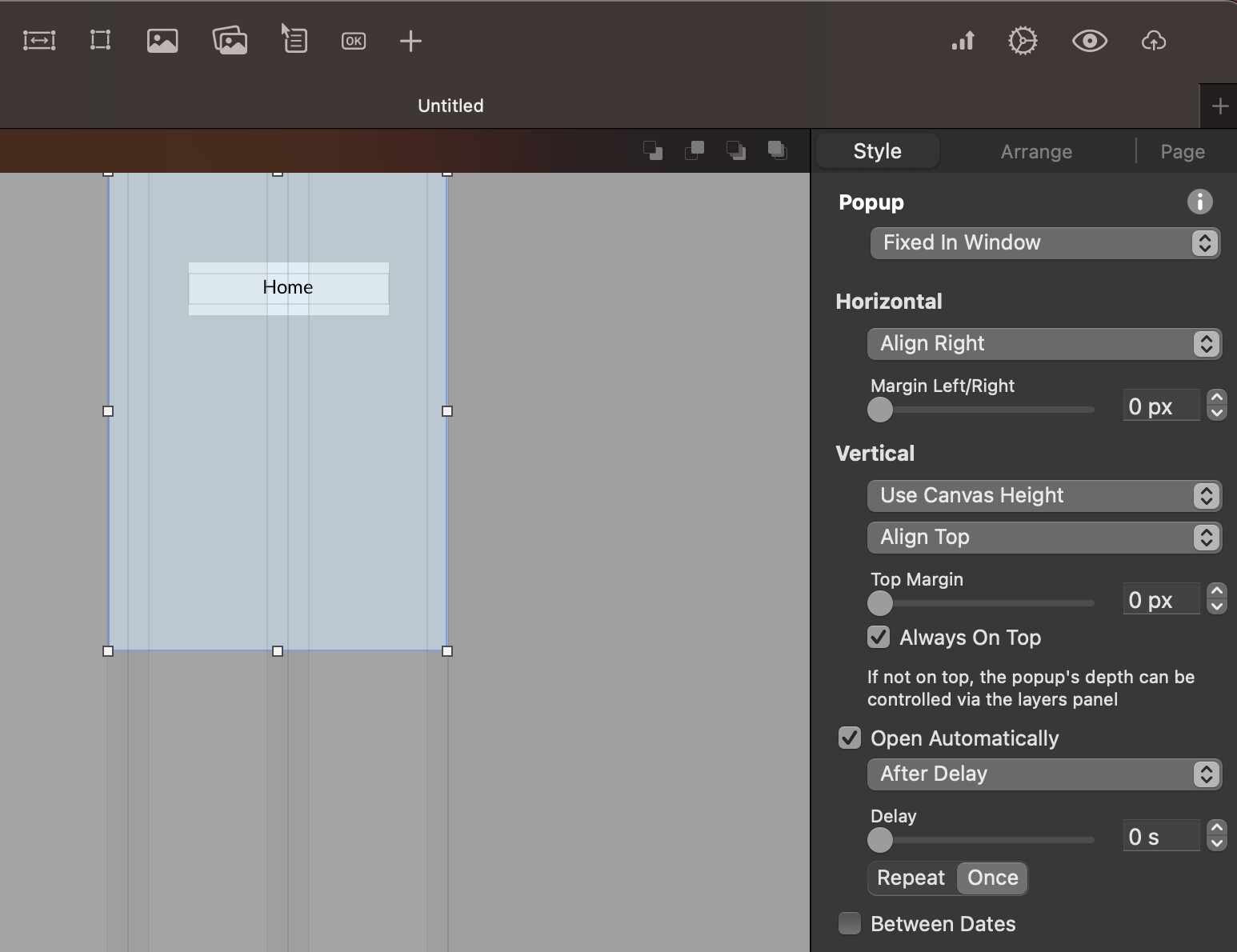

A pretty nifty website example! :slight_smile:
We can have the navigation flank the edge of the browser window by using a Sitely Popup widget that as been assigned to be Fixed in Window, please see screenshot below for the settings.
After that you can drop in your main menu navigation and enjoy! :slight_smile:

Bonjour FlaminFig,
That’s perfect, thank you very much.
