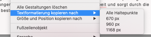

Yes, the text-feature also was not restricted to text but also to all elements. With text it was and still is a feature to be able to set text and paragraph styles to all breakpoints be the same but before changing to another/next device
- kind of like in sparkle, but if one adds a new text-box it’s necessary to click that new text-box in all devices/breakpoints in order to set the paragraph style to it (what I do on one extra page page right before I start with a new project):
In muse one of the great features was this:
Kind Regards,
Uwe
