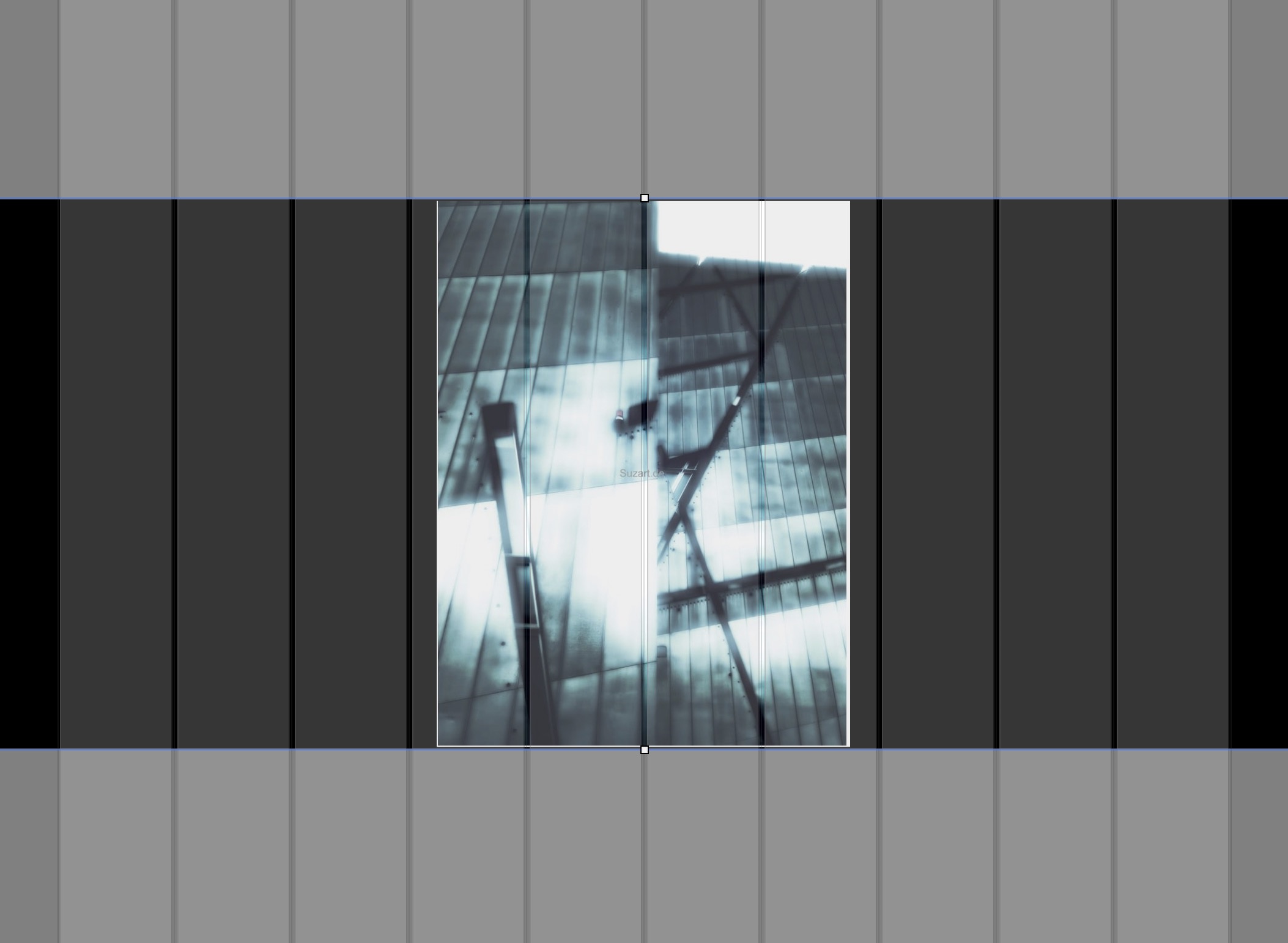

One option, a workaround I am showing here, is to make a wide box and make the letterbox fill color of the gallery match the color of the wide box. Yes, it is a departure from the look of the page, but it’s an option.
Dave
Thanks Dave, I’ve discussed your proposal with Susanne. We really appreciate your suggestion but as you mentioned it does take away the artistic look of the page. We will look for more inspiration how we can use Sparkle to share photo’s in a artistic way. Best regards, Susanne & Hans

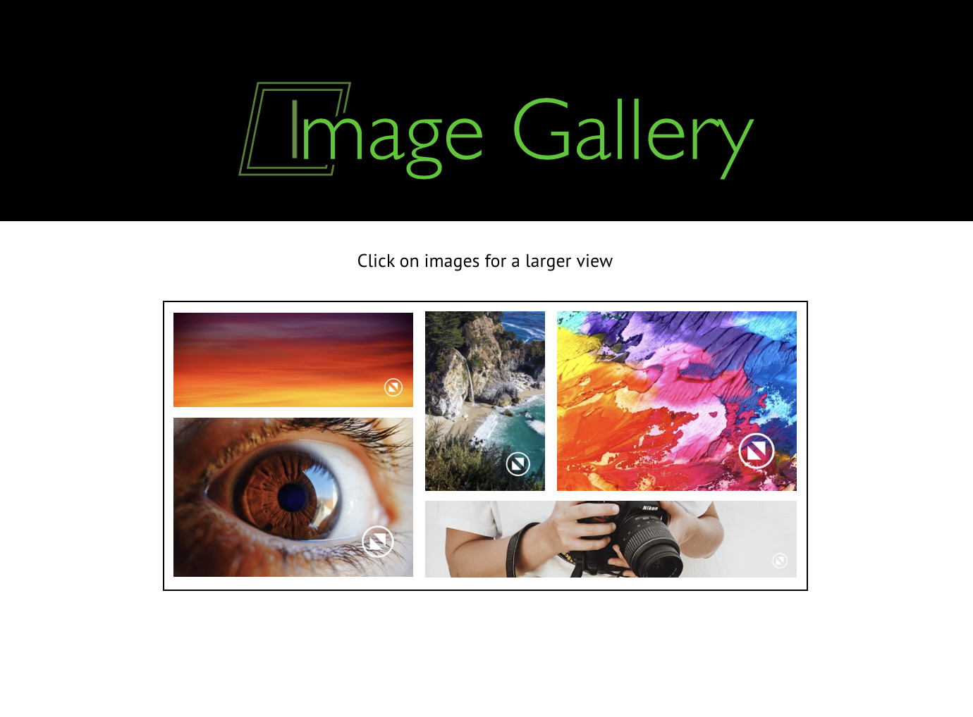

I’ve noticed that there is a trend these days for creating masonry galleries on artistic websites. These allow images to be displayed quite creatively in image blocks on the page. These can be manipulated for different device sizes, so can be quite a flexible way to display galleries. The beauty of this option is that it doesn’t matter what the orientation of the images are - in fact, you use the orientations to design the image block. By having each image in a lightbox, they will open without any white space on either side or top and bottom. Even if you use the fill option in your image boxes and end-up cropping them slightly, when they open In a lightbox, the full size image is displayed.
Web page space is probably the cheapest you can get, so why not use it creatively to display your images in a more artistic way? Below is an example of a masonry gallery created in Sparkle - maybe it will give you food for thought. If you want to see this example as a live site, CLICK HERE - works on mobile also.
Thanks Franc, this is great inspiration! We will look into it to see if we can achieve this kind of gallery. Since Susanne and me are just starting to explore Sparkle it could be that we need some more guidance how you realized this. Best regards, Susanne & Hans
