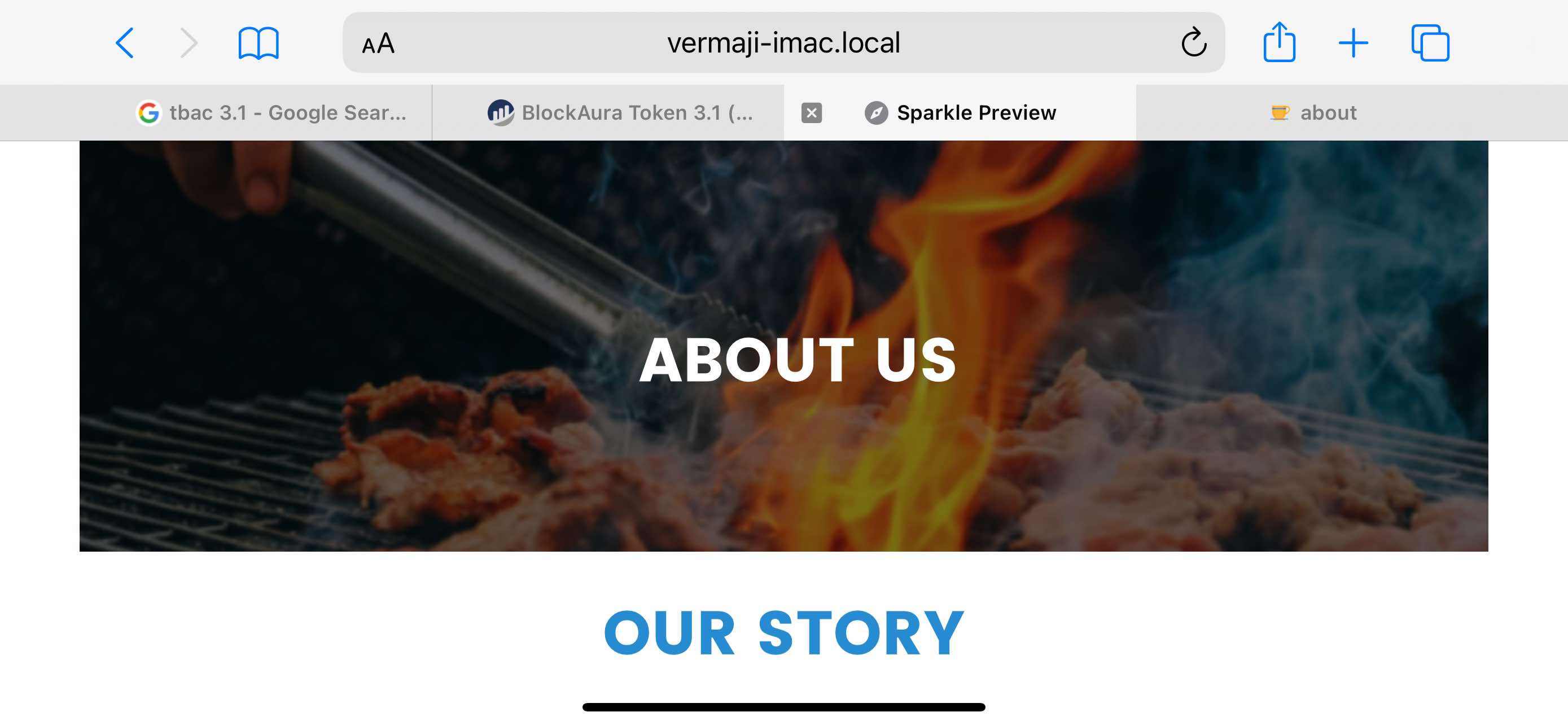

So far so good, but I am facing a weird problem in the Mobile Landscape Layout and Preview. Although I have set it to custom and automatic both, but I still cannot get the Layout blocs to display at full width on the actual mobile device in landscape mode. I have attached the pics for better understanding. The top Layout block and the bottom Layout block are both displaying as a rectangle on the actual mobile phone instead of covering the whole width. In portrait mode they look good.

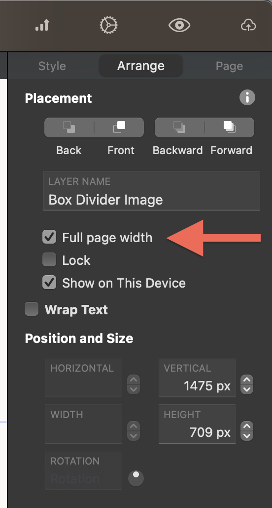

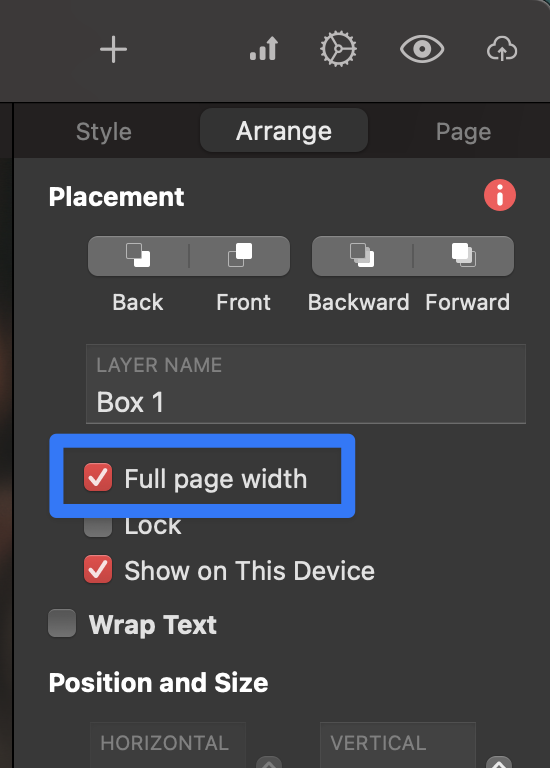

For the first question, have you inserted the images as a “image” widget or a box? You probably will want to convert them to a Box widget and set both these boxes to “full page width” on the Arrange tab.

For my first question, I am using a Layout Block and the image is set as a background for the Layout Block. I tried the Wide Box with an image fill as stretch and all the options set as advised by you, but the result is exactly the same as in the above picture when I preview the website on the actual mobile device (iPhone 13 Pro Max) in landscape mode.

Remember @vermau, Sparkle generates websites that have a fixed width.
For me I don’t worry at all with the 480 device.
It is really only used to view videos.

Hi @FlaminFig so you reckon that I should leave the “Smartphone Landscape” setting to “Automatic Scaling” and only consider “Portrait Mode” for mobile and Tablets and Sparkle will take care of the rest behind the scenes while rendering in real time..

The automatic scaling @vermau works quite well and reduces your workload load when creating a fully functional and responsive website.
For me I custom layout the 960 and use it to auto scale the 1200 & 768 devices.
I then custom layout the 320

@vermau, when it comes to full-screen width I’m assuming you mean full browser width then it is quite simple when it comes to images…
Select the Image or Image Gallery and go across to the right and under the Arrange tab…

Then, in the Arrange tab of the inspector, check the “Full Page Width” checkbox.

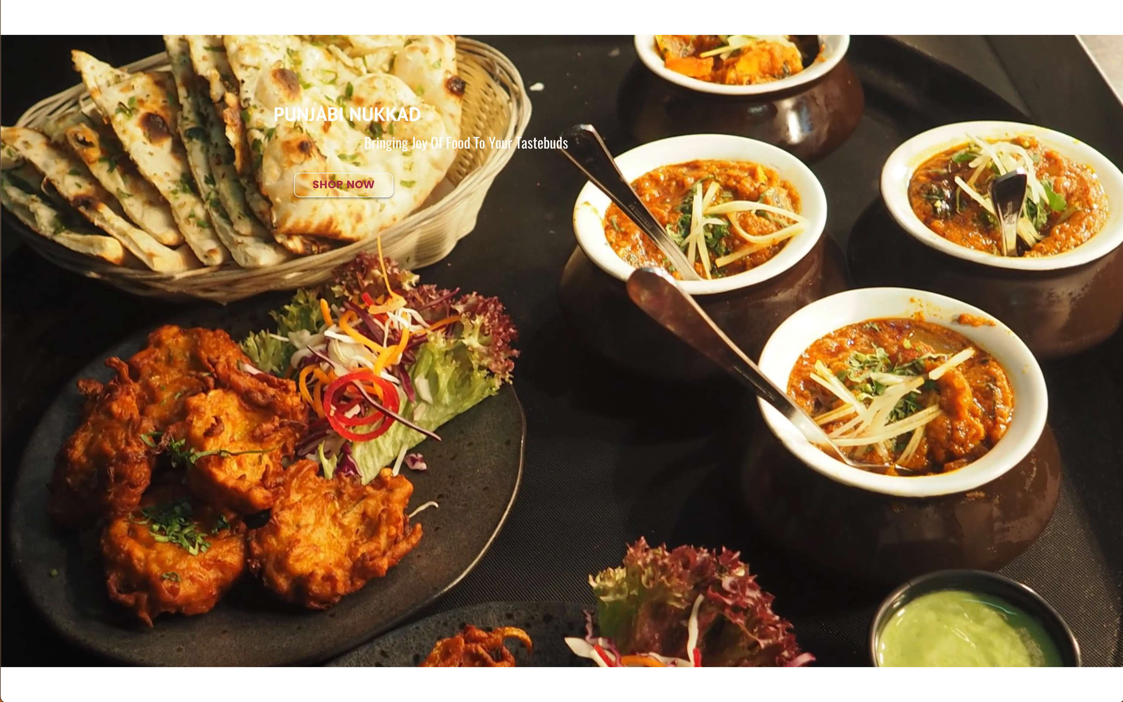

I read one of your other posts about full height banner image, implemented it as explained by you but it did not work for me. I also tried to give an overlay effect to the whole banner image by using another box element, the overlay box only displays at the bottom half of the page. It does not cover the full height of the page. My CSS code in the embed element is as follows:
<style>
	#hero_banner_box,
	#hero_overlay_box {
		height: 100vh;
</style>
I have attached a screenshot of the banner image. It has white area at the top and bottom I can’t understand why. The image is quite big in size to cover the whole screen, but I think like Duncan said that the aspect ratio changes as the browser height is changed, it maintains the width, but does not maintain the height.

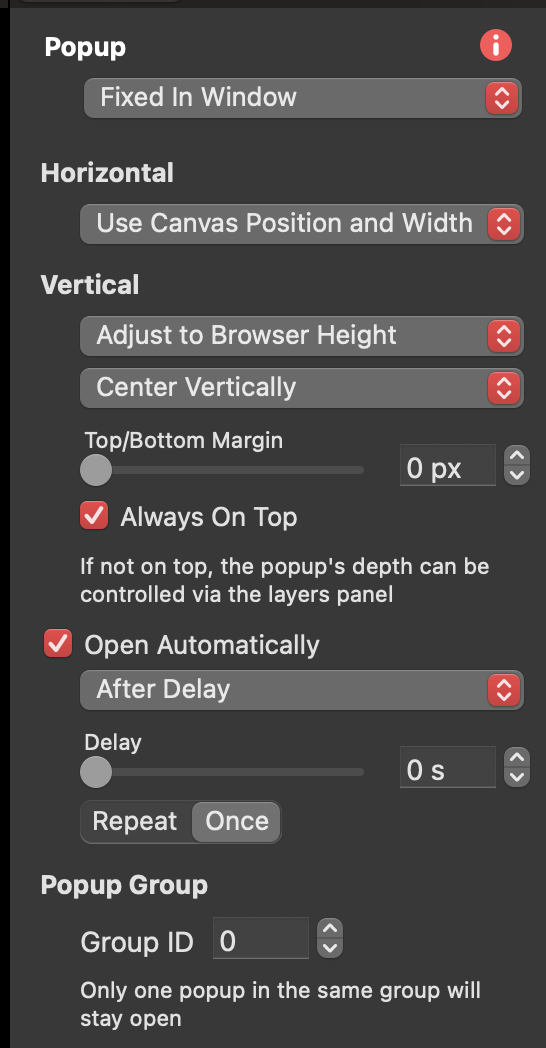

Hey! Okay, i see
Using images its easier. You can use the popup approach instead of all the code from my other post (was one year ago)!
You will create a Popup and config it as “Fixed in Window”, “Use canvas position and width” and “adjust to browser height”. Also remember to set it to “full page width” and to untick the “Always on Top” option.
Next you’ll want to set it to open automatically and the delay time to 0s, and after that, you’ll move it below everything else in the Layers panel. Now you just have to adjust, but the image will cover the entire browser height.
It’ll be like 2 years since i’ve wanted a way to make full height images available in Sparkle, but i’ve been using the code method and this popup method for the most part. Not ideal, but it works the same (and the popup method is better than the code option since you don’t destroy the layout coordination and structure)
See if it helps you!
