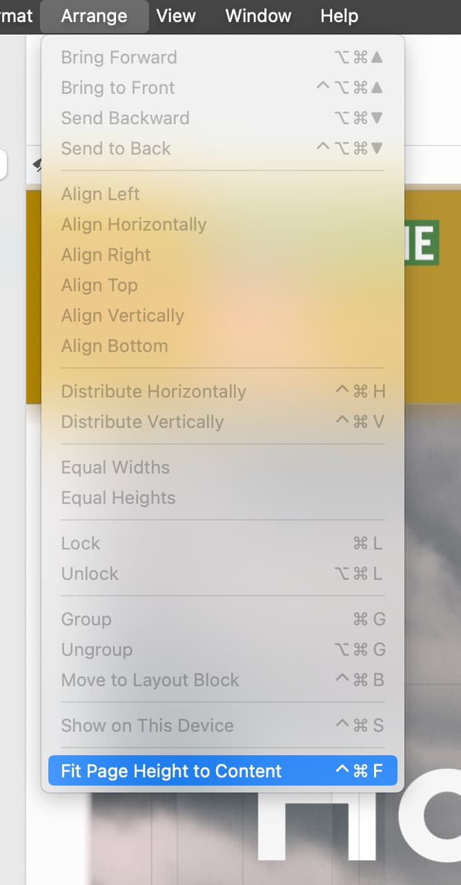

You know you can just go to the bottom of the page and double click the bar at the bottom and it will blouse the space up. I spent ages dragging pages back up until I realised this.

There is also a menu item for this - here:
None of the solutions offered here solve the problem, so no hidden elements on the bottom halve off the page and also tried the Fit Page Height to Content (which is now gray).
