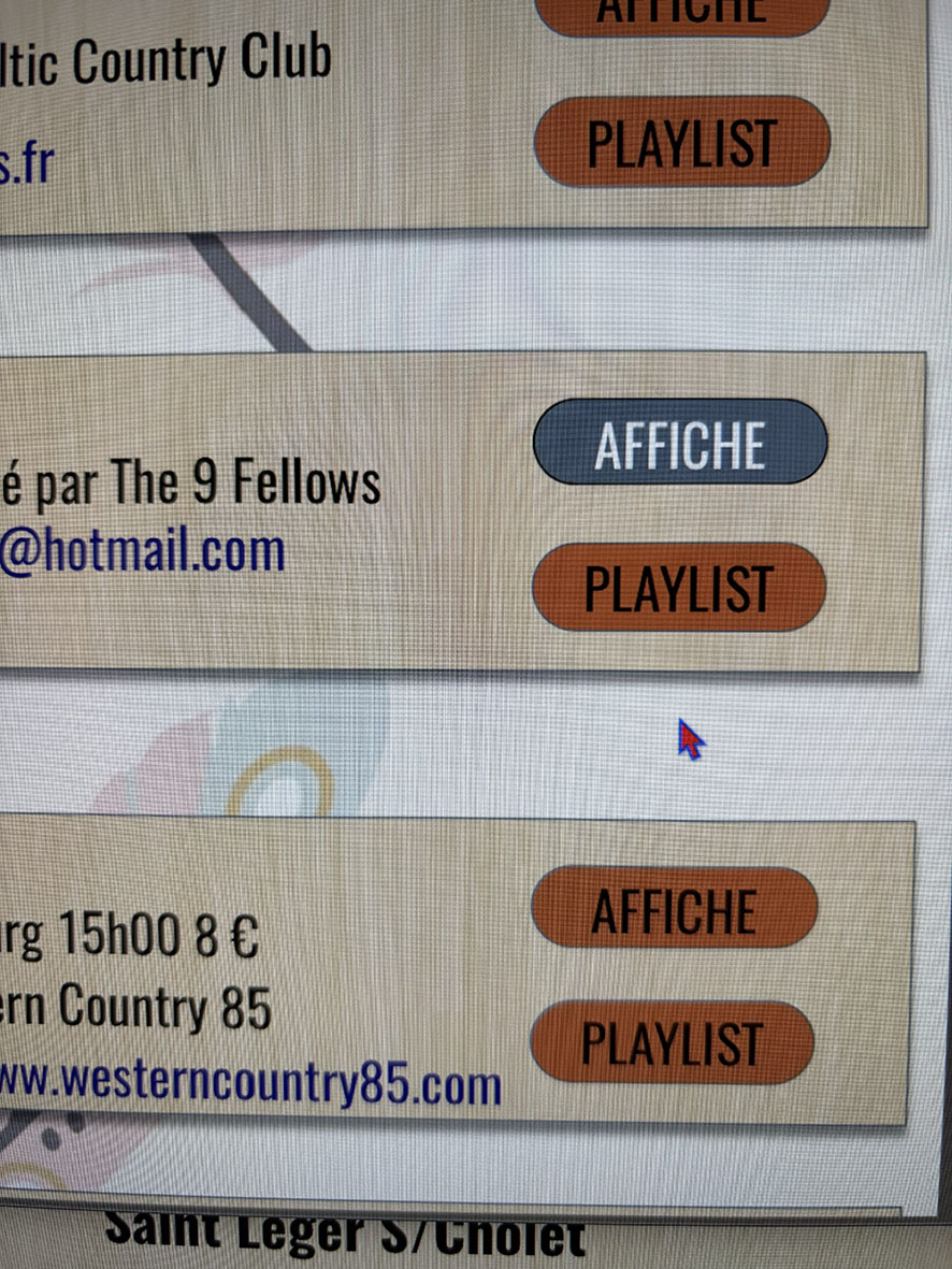

I have two problems with Sitely buttons. When I have several buttons side by side with a link, they are active even if the mouse is not over them. Also, when I click on a button, the one above it responds. Have you ever had this problem? Thank you for your help.

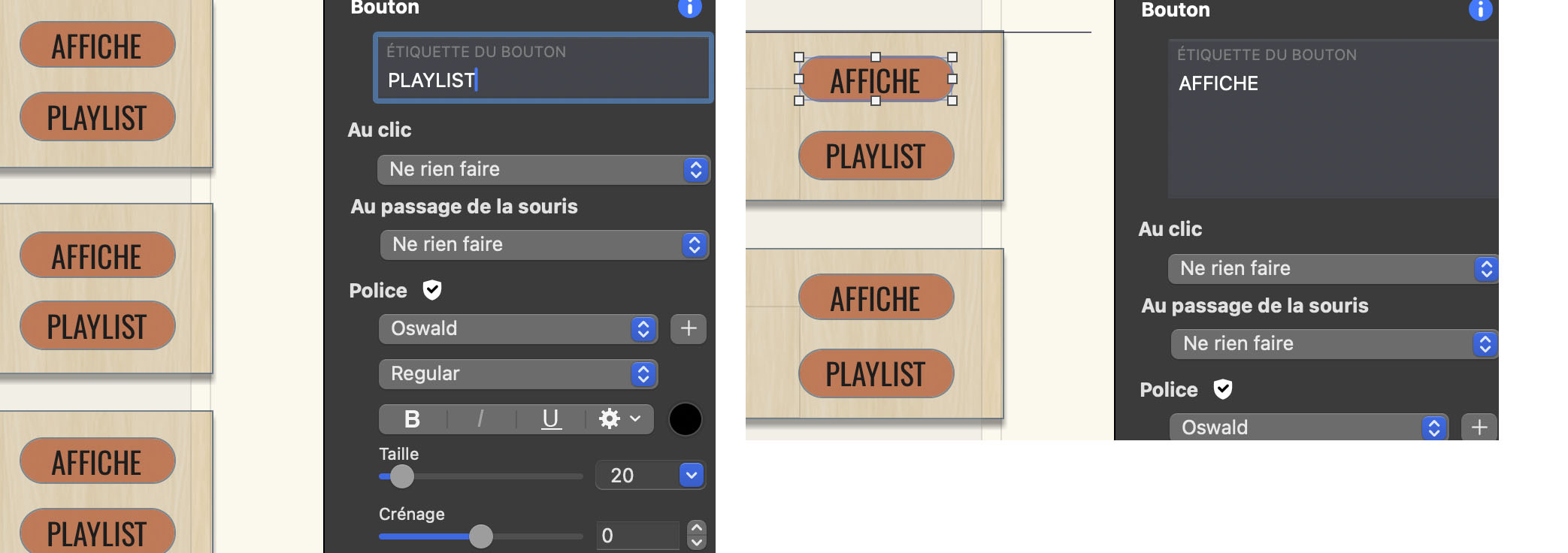

I just checked your site, and indeed, this behavior isn’t normal. Looking at the source code, I noticed that the text inside your buttons contains line breaks after the words “PLAYLIST” and “AFFICHE.” This causes an invisible enlargement of the button’s clickable area, which ends up overlapping the buttons below. Normally, a line break should visually expand the button, not just its active area, but it seems there’s a small issue here.
I was able to reproduce the problem on my end and will report the bug to Duncan so he can fix it, unless you’ve already done so. On your side, simply removing the line breaks from each of your buttons should resolve the issue.

Thanks a lot, Allan. Indeed, in the button label, I had page breaks that enlarged the button area. I’d never noticed this very important detail.

I’ll post the screenshot; it might be useful.
