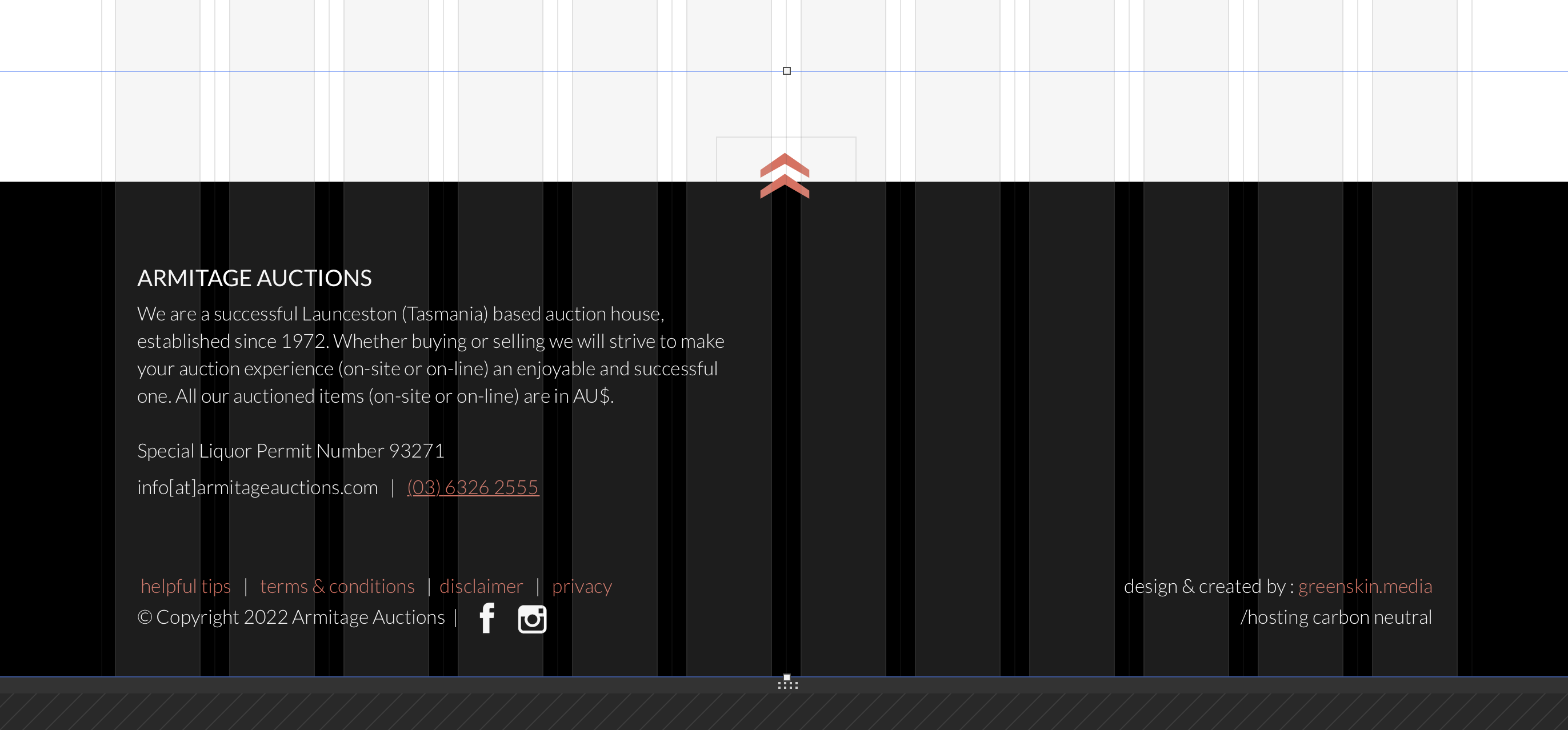

Ok first the mechanics.
All the elements are grouped in a widebox - the footer section…
And then how it is achieved…
And here it is in the wild…
Like @Mr_Fozzie suggested it depends on the type of website what sort of information goes into the footer area of a website. Just on an SEO note, you will see in my footer example I have a blurb about Armitage Auctions… Search engines loves this!

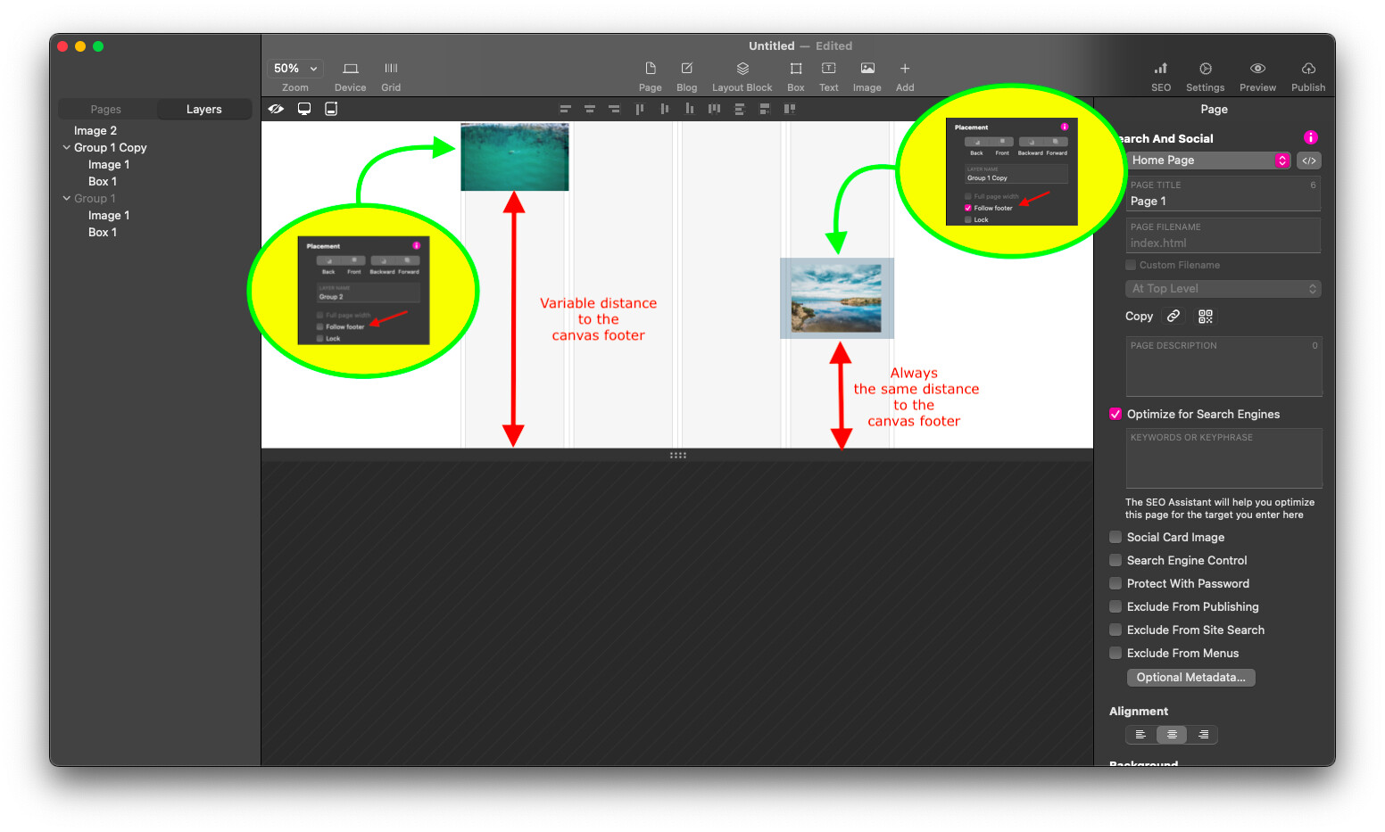

Meanwhile i managed to understand what the “Follow Footer” means,
i first thought that it was something in regards of the webpage
(similar to “Style → Fix to browser bottom”)
But after carefully reading the documentation ("Arrange" ),
i now do understand it’s
regarding the position of an element relative to the canvas!
It’s is about the canvas (and browser ?) position!
To illustrate it (for anyone who also wants to understand the “Follow Footer” option)
i added 2 screenshots, hope it will help

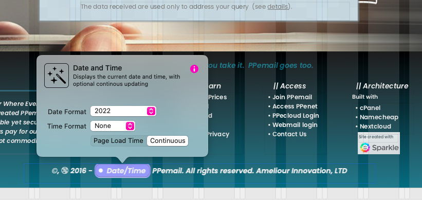

A trick/hack @Frenchie is to insert a Smartfield Date/Time in your footer and you’ll never have to update it again, Sparkle will…
Other then that it is a great thing to learn all of Sparkle’s new features!!!
This UI change would be very helpful!
I always find it amusing when I see the ‘big’ websites with last year’s copy-write notice . Recently was on one of our Quebec-based sites, which you would recognise @Frenchie, with 2021 noted as the current year–we are a quarter through 2022 (already!
). Was tempted to email the webmaster but, naw, I keep busy enough fixing my own errors
Agree @FlaminFig: Now don’t even need to add code… Open Smartfield, add Date/Time, note it as “Continuous”, and go play trying to figuring out how the new Layout Block feature works…
