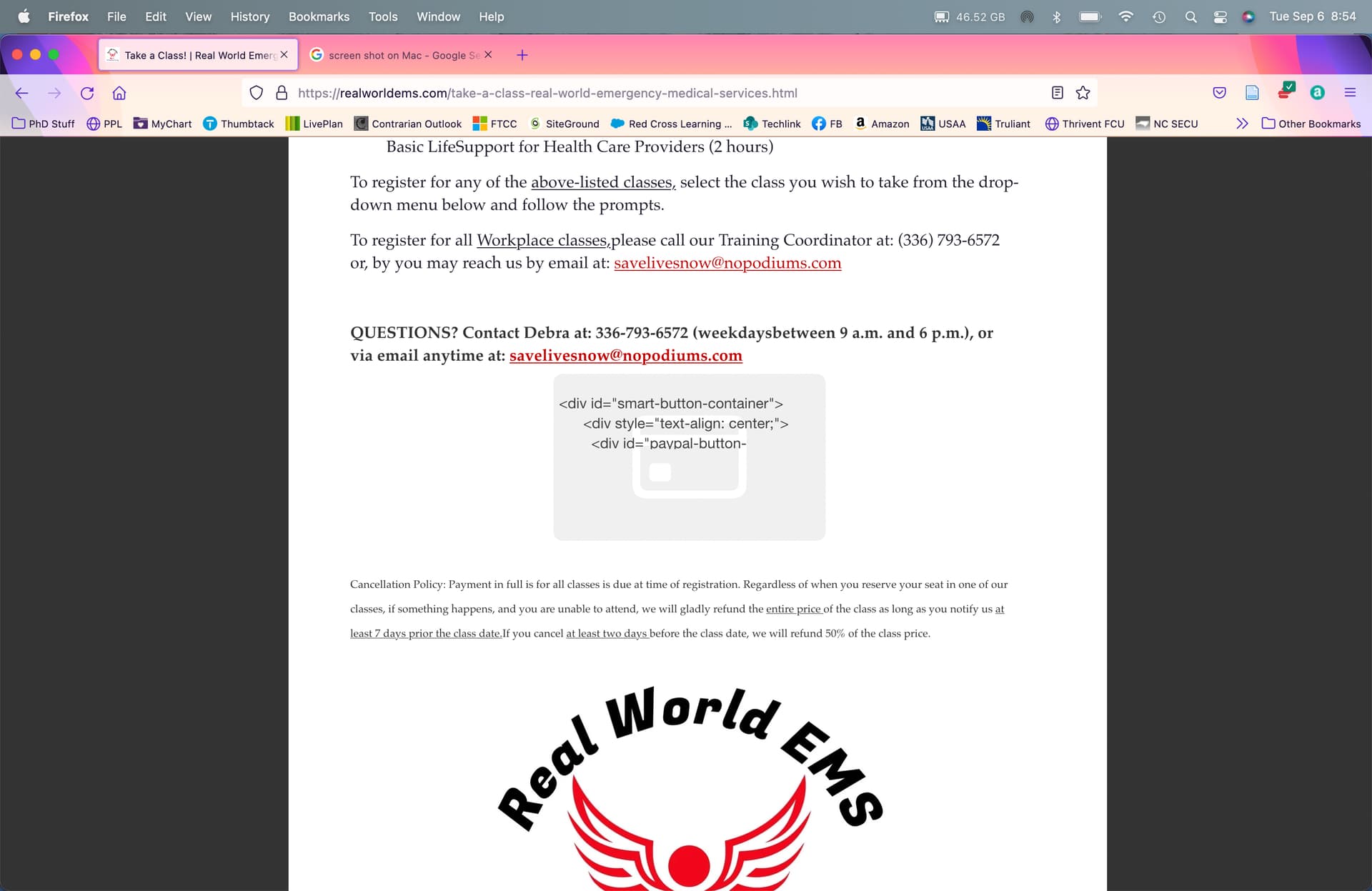

I have tried everything (well, probably not), to embed the html code from PayPal to add a complex, multilevel series of buttons into my Sparkle webpage. It looks great during construction, I then hit “publish” which saves everything to a folder on my Mac. Then, using FileZilla, I upload it all to my host’s (Siteground) server, go to the site, and all I see is a grey box with a few lines of code - Help!

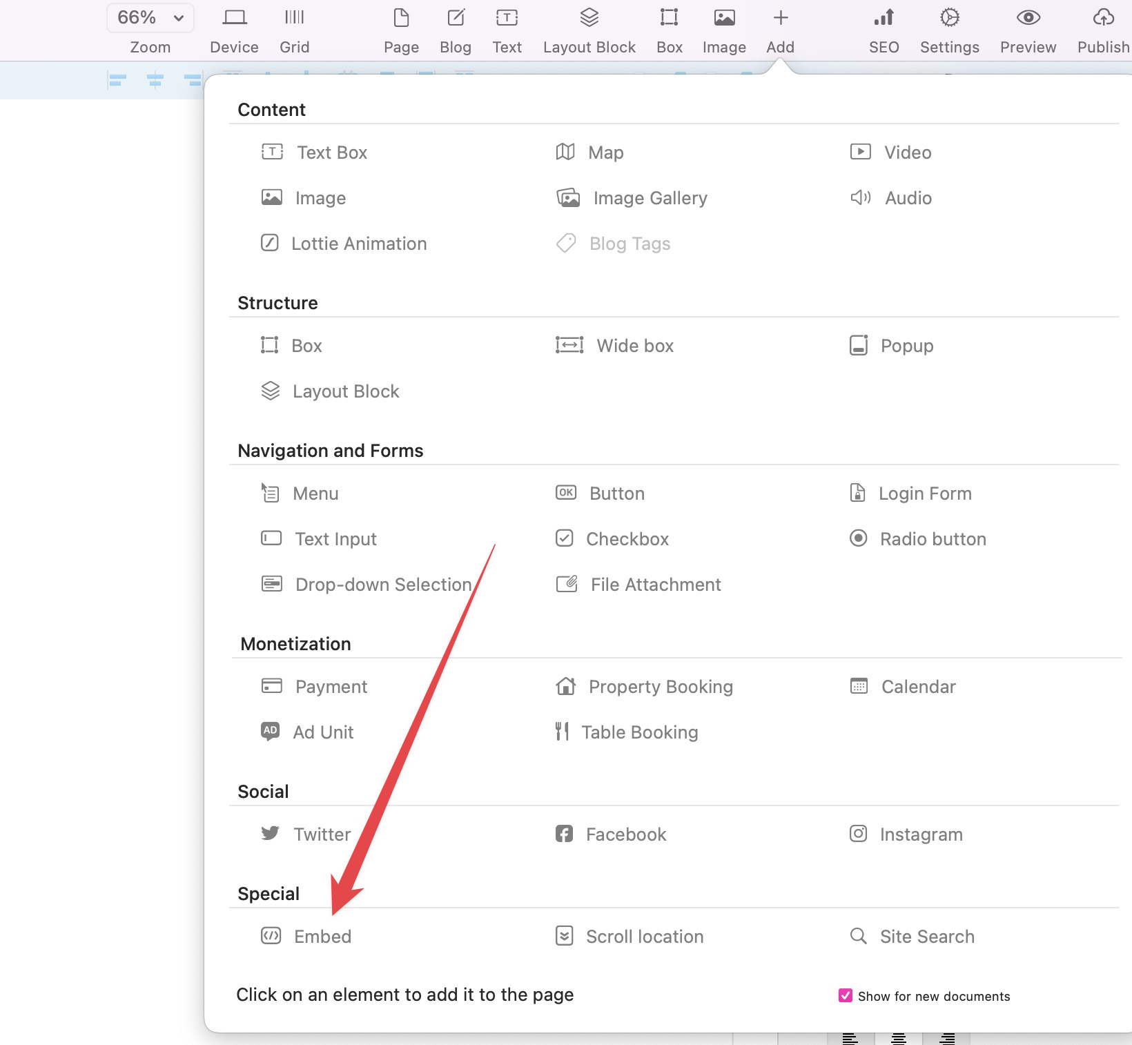

It sounds like you might have added the code in text blocks in Sparkle. For code embedding you should use Sparkle’s embed element.

Thanks for moving my question, duncan - this is my first request for help so I’m a true noob. As for the method I used to add the PayPal button to my site, I did use the “embed” function as directed. Here is a screenshot of how it looks on the web:
The site is: www.realworldems.com
I have tried to setup the “publish to the web” method but even though I select the “public_html” folder, Sparkle will not complete the connection. I’m not a big fan of FileZilla but it still feels like the only way to upload my files.
Yes the page coding suggests you have pasted the Paypal code in a text box. There doesn’t appear to be an embed element on that page. As mentioned you should paste it in an embed element instead of a text box:

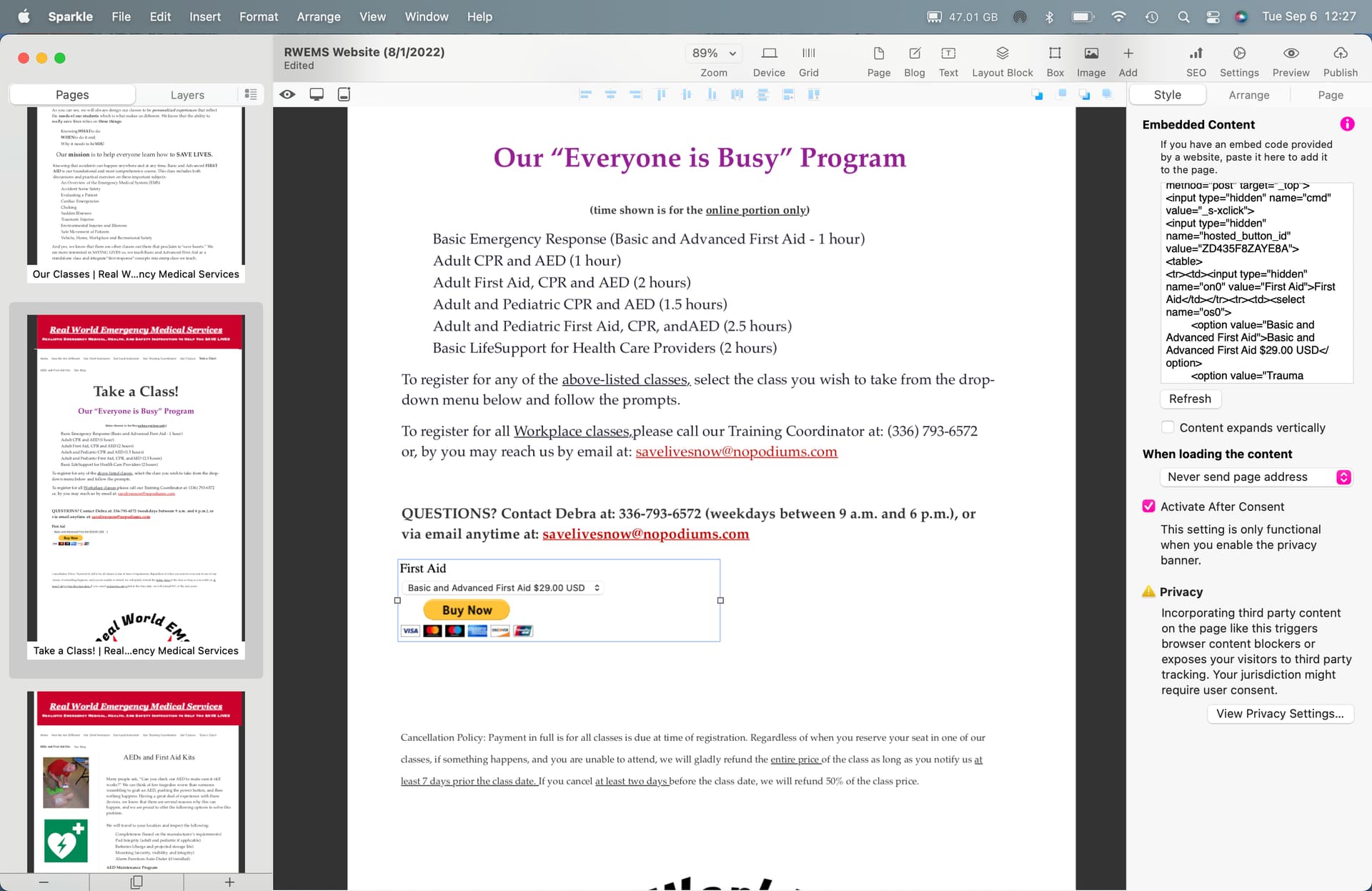

then paste the code in the embed element settings:
