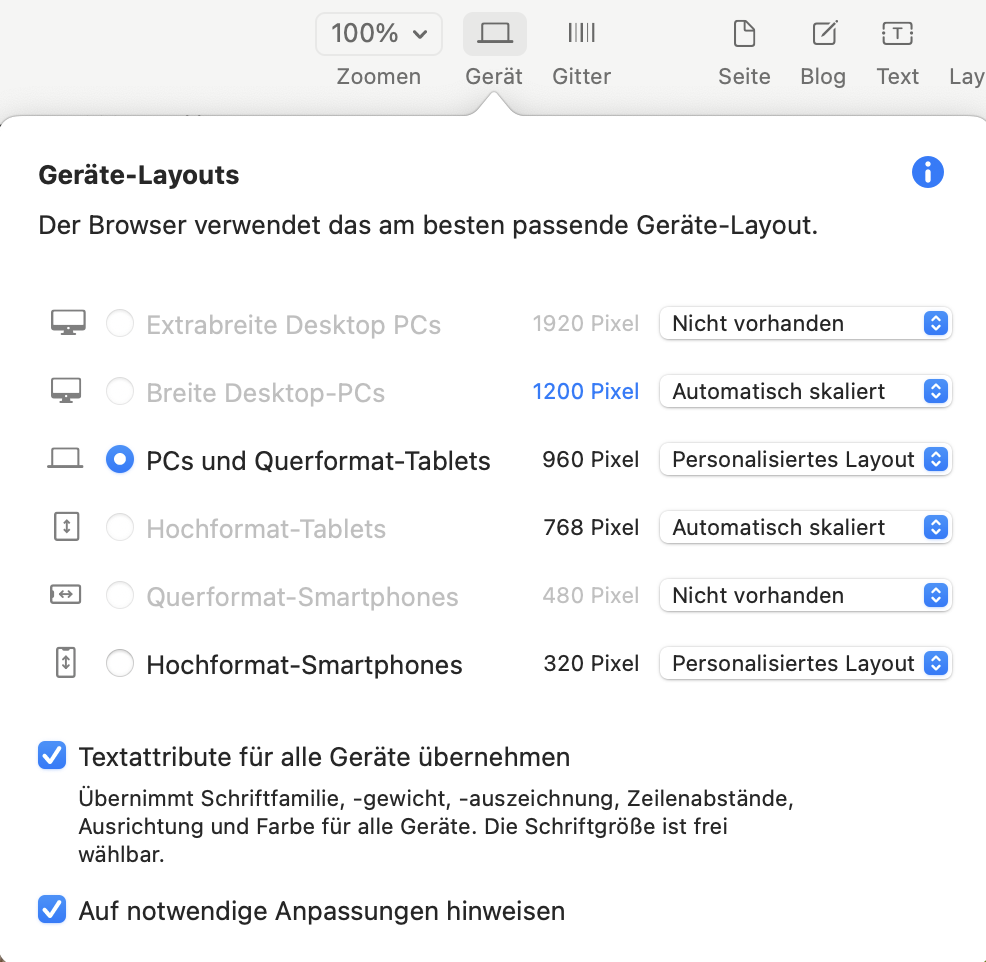

I’m talking about this:
I can only edit (this is my setting) the 960 and 320 px layout. When i change a page in the 960, i have to switch to the 320 and adjust the layout there as well. In reversed order it is the same.

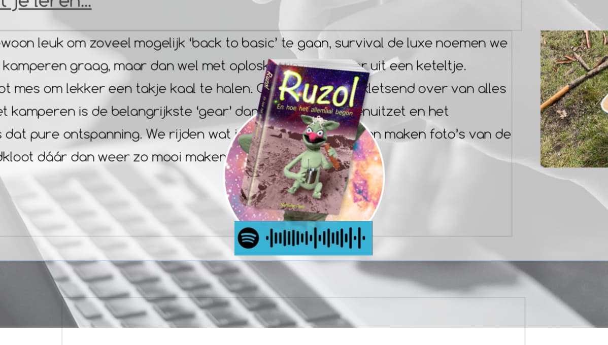

This is what happens to the images, another place on the site and,…well it speaks for itself.
What I do is go to the menu and check another device, just as here
Yes, this is completely normal.
No whining or crying will help, you always have to rework both pages manually.

@Nathalie, have you introduced an image on your 320 device? If you introduce images on your 320 device then you need to remove them from your 960 device as they would interfere with your 960 layout like you are showing in your screenshot.

I have a suspicion: do you start with the 320 px layout and then want to adjust the 960 px layout?
When you switch to 960, you see a small image, namely the one from the 320 page. You don’t like that. You remove it and insert a large image. Now comes the surprise: on the smartphone side everything is shifted again. So start again from the beginning. Remove the large image and put the small one back in. Now the 960 layout is strange again.
So you can drive the game infinitely further. The content on both layouts must always be the same - with some exceptions, e.g. menu.
That’s why I always start with 960 and then switch to 320. The elements must then be adjusted in size and position. This is easier in my opinion. And when publishing, Sparkle does the rest.
