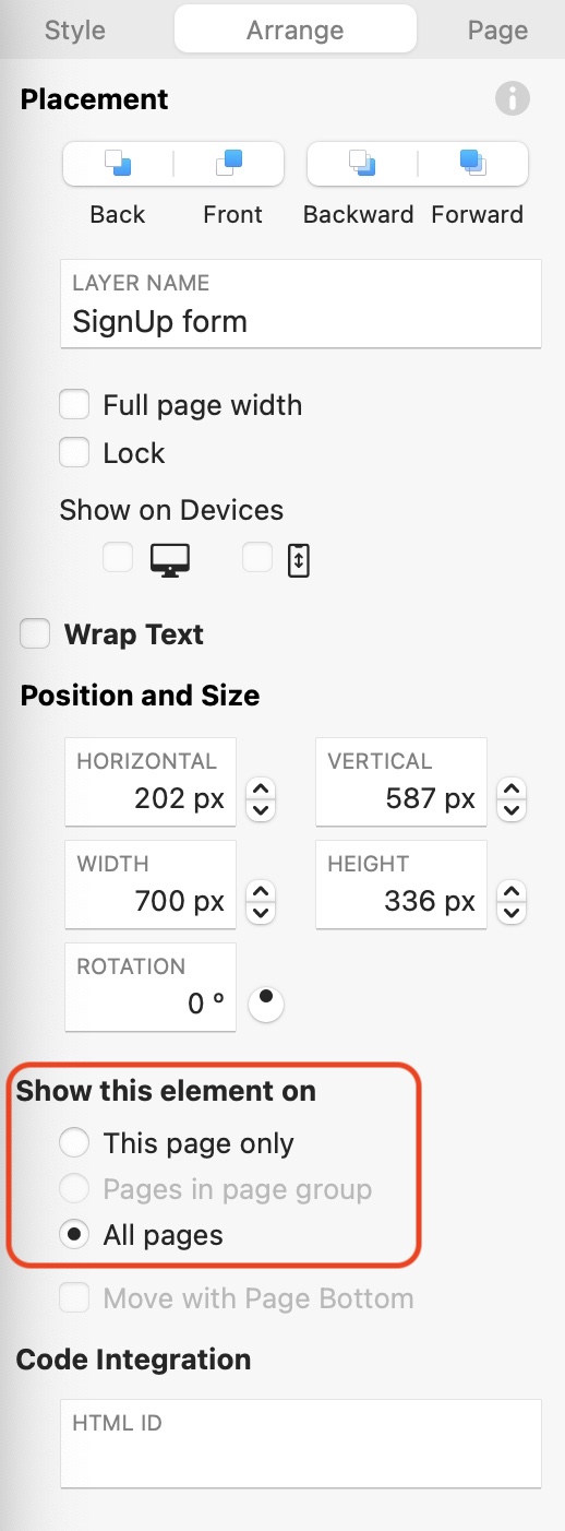

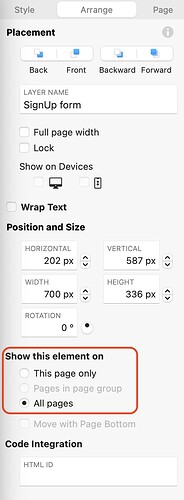

I think the simplest option is to open the popup on the original page. With the popup displaying, head over to the arrange panel and select the option to Show on all pages:
This won’t automatically display the popup on every page, but it will make it available on every page of the site. Then, on each page where you want the popup to display, add a link that targets the popup.
