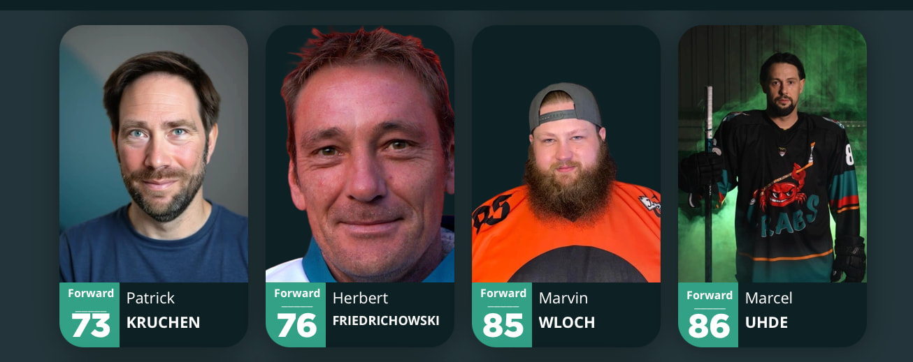

Hello Thorsten. The team layout looks OK on my screen. Here is a screen shot. My current browser is Safari version 18.6. I think your site is great !

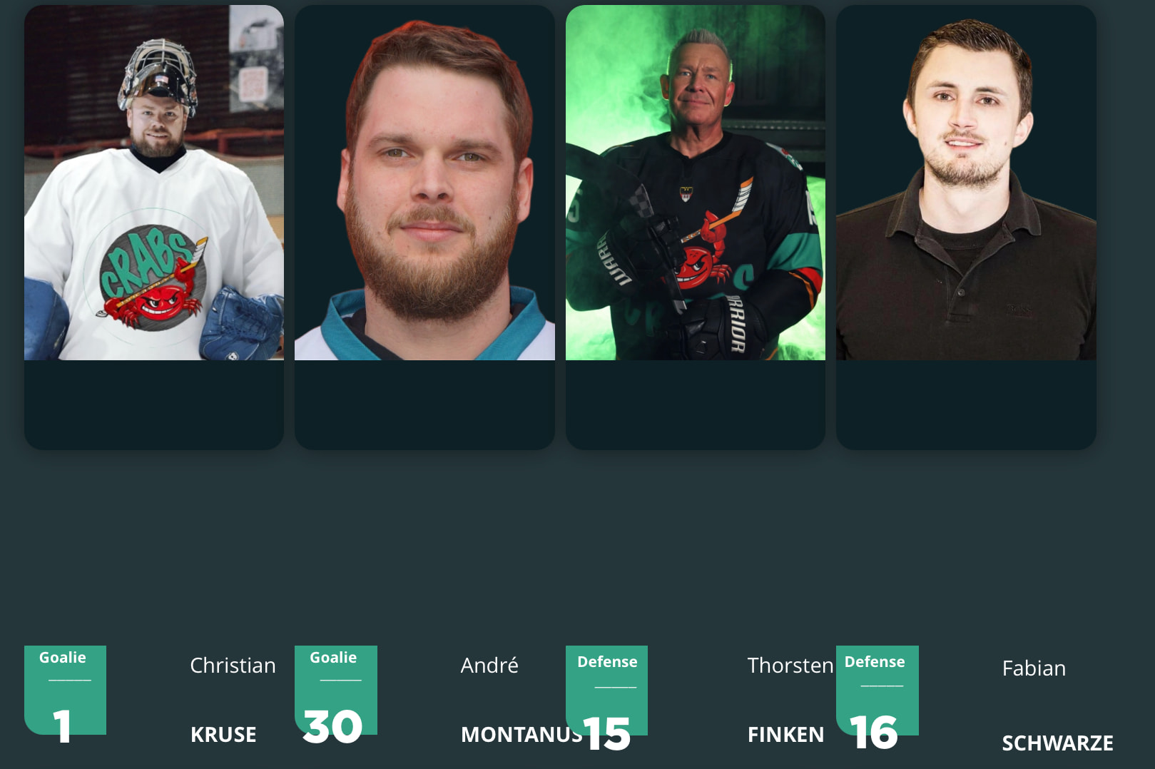

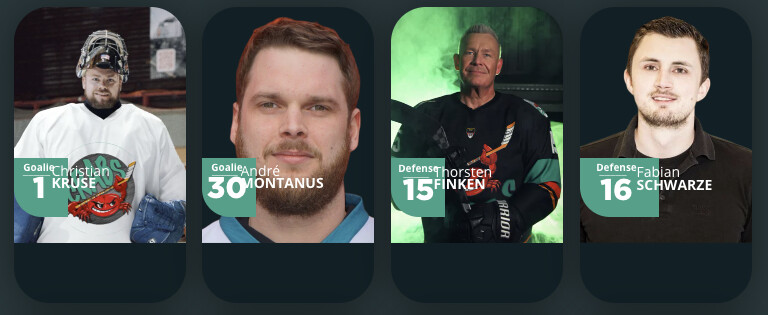

When I resize the window, this is what it looks like on my end, on different devices and no matter which browser I use (Safari, Chrome). The operating systems and browsers are all up to date on every device.
or
I’m not one of the expert minds on here Thorsten but I just checked with Firefox and Chrome and the site generally looks OK and the team page the same as my screen shot.. Your screen shots show the “error” remains consistent across each row of images. Either over the images in the row or well below. So a little baffling! Perhaps one of the more expert minds will see this convo soon. Alternatively perhaps Duncan may have a solution.
