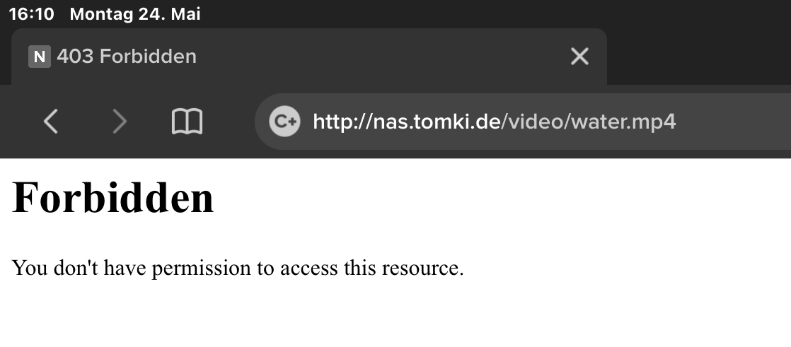

On the iPad I get this error message
„Forbidden
You don’t have permission to access this resource“
I think I found the bug with the QNAP NAS. One cannot use a folder called “Video” on the web server. Files in the “video” folder cannot be accessed. Xway uses a folder called “ressources” to store media files. When I renamed this to video and also changed the index.html accordingly, I get the same result as with SPARKLE. On the other hand I renamed this folder to “test” and adjusted index.html again - and it worked.

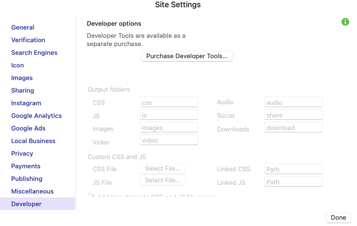

But: is there a chance in SPARKLE to use a different folder name for “videos” - as it appears to be treated with different user rights on the web server!
Hello @Tomki
Yes you can rename the “output folders” if you purchase the “Developer Tools” in Sparkle site settings …
You made my day @Shadowfax! Thank you! It work’s with a renamed video folder.
