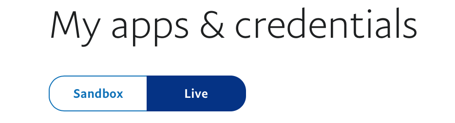

The new style require creating an “app” on the paypal site, then making it live, and getting the key for that.
When you click “Get” in the Sparkle settings you go straight to the paypal “app” creation.
Once you return to the main screen (My Apps & Credentials) you switch to live:
Then click on the app name and copy the client id.

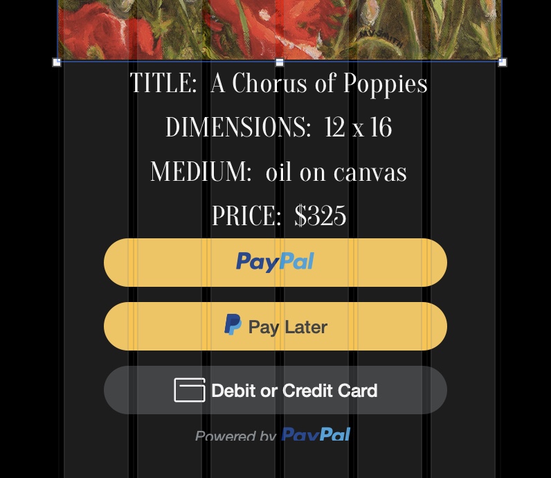

FYI: here’s what the buttons look like…they really are much better looking and better functioning for mobile. And once I got the proper Client ID from PayPal and entered it into the PAYMENTS field in the Sparkle settings, Sparkle makes it a piece of cake to add buttons to a page…much faster and easier than the clunky old copy and paste PayPal button code into an “embed” box on your Sparkle page procedure.
